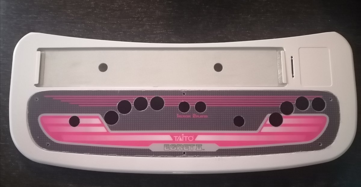

I started whit the bezel because it need more work.
The sun eat through the paint and made small cracks on the plastic, got most of it flatten out but still need to patch that hole

Better to sand i all down and have the bottom blasted to see what rust is underneath and then repaint the whole thing :-)

New graphics cp and paint would go a long way.
