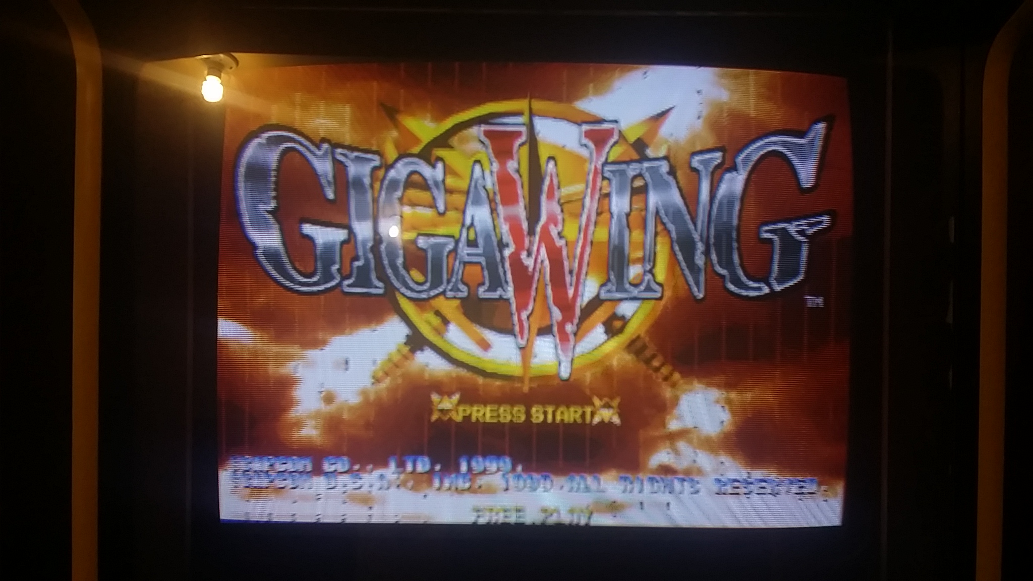

So Ive had my multi for a while now, finally decided to update the ROMs. Pulled it apart, got the SD, updated, put it back together and got bars.
I checked all the pins on the multi kit and everything was where it should be, deleted and formatted the SD card like a bajillion times then figured I should check the A/B board pins. That was the issue. So if you keep checking everything and everything looks right and the roms are good, stop and look at the A to B board pins, you may have bent them like I did

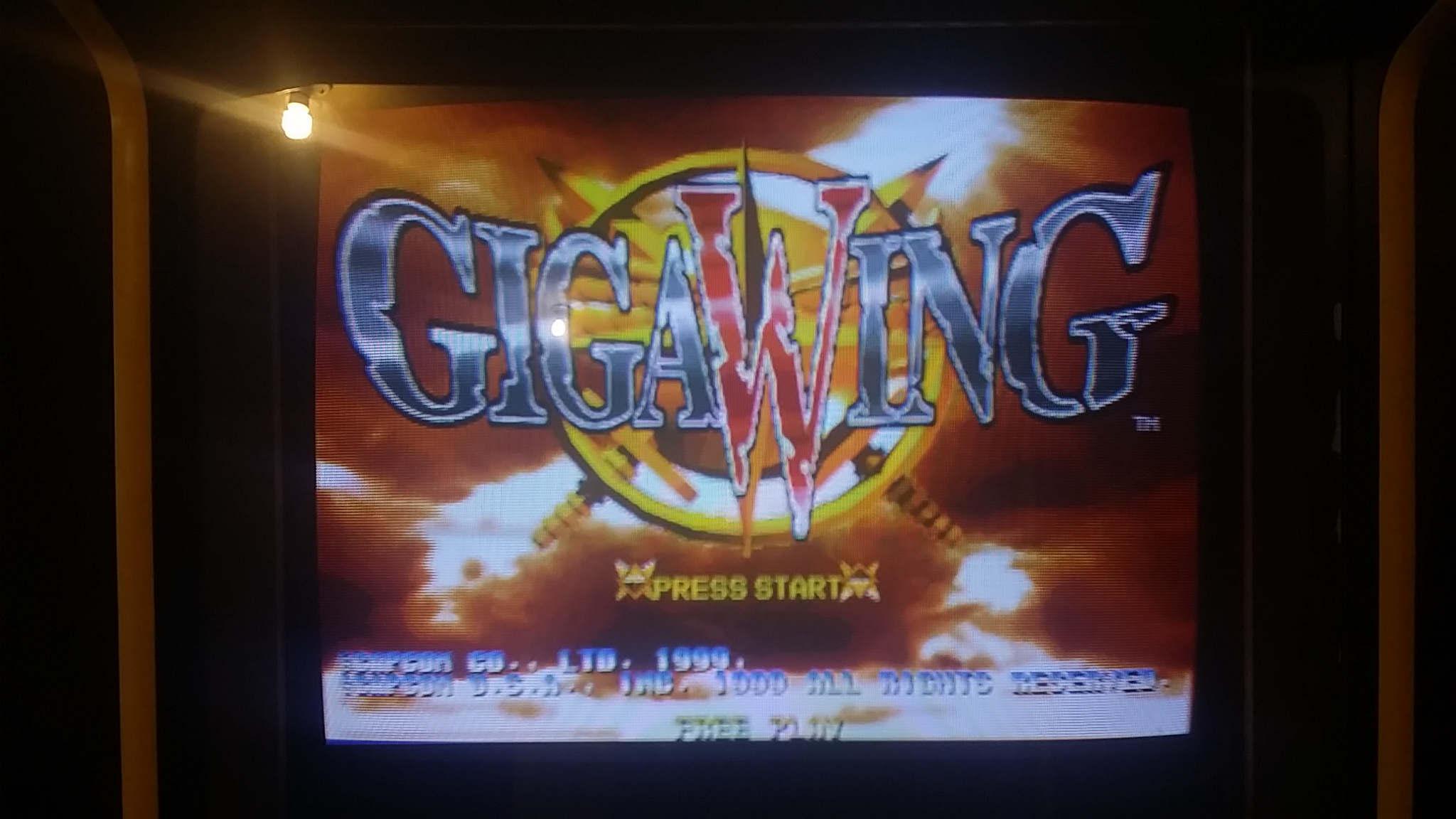

bars on title screen:

no more graphical glitches
