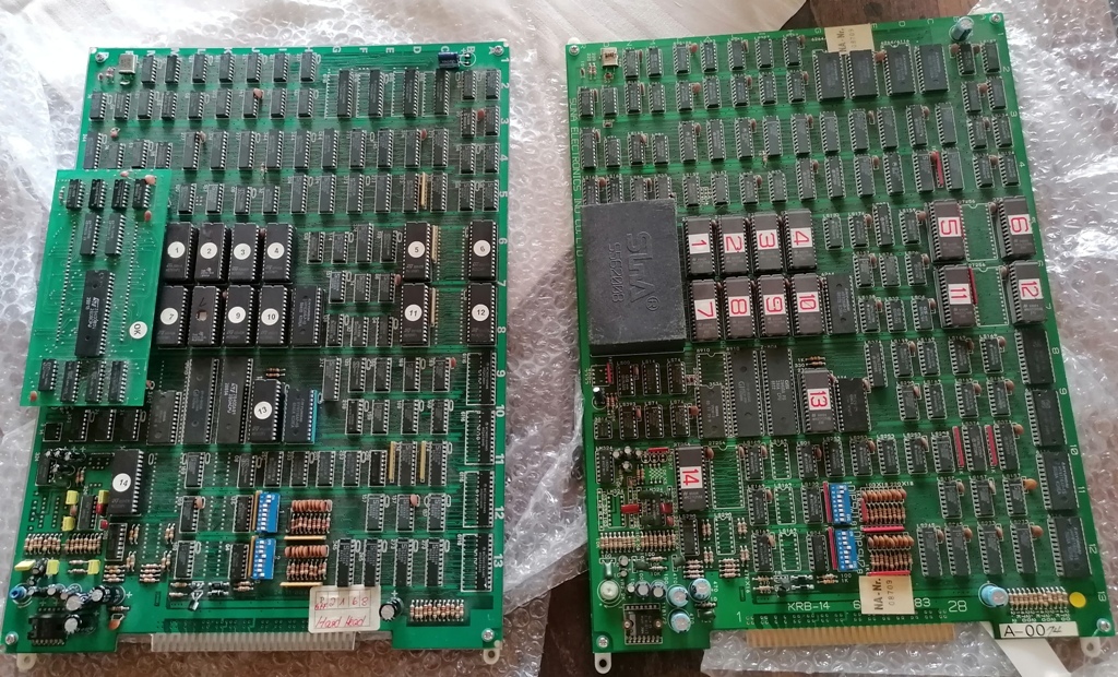

Mine has no sound, caps look good, changed amp and both 324´s did not help.
Any idea where to start?
I kinda like the gameplay
Wow, thank you forum for simply existing!
I did check the pictures and something was just wrong.
The previous owner did put the 1182H the wrong way and it exploded.
I did replace it exactly where it was.... did not know about any repair attempt
Switched, works
