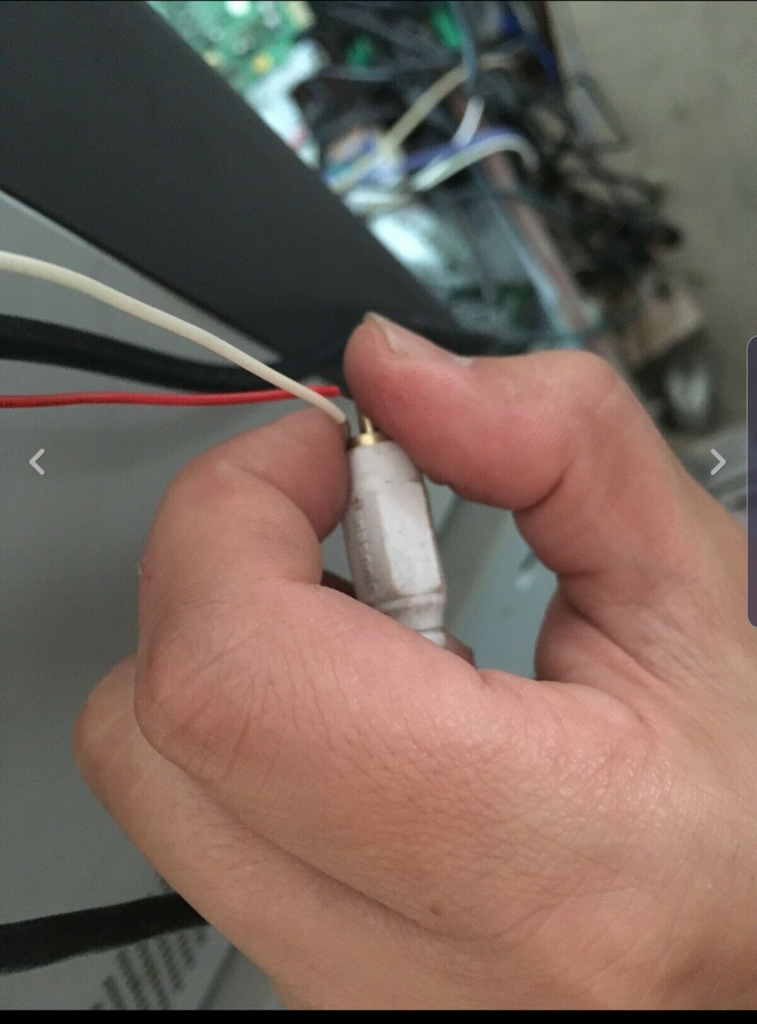

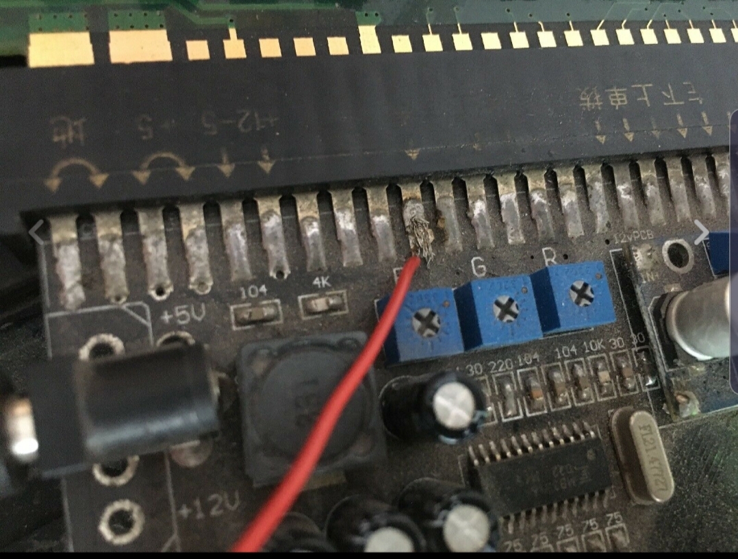

ok I received my battle garegga bootleg. It works and sprites are in right place but no sound. Rom0 and rom1 show bad in rom check screen but that might be normal for this board. Ebay seller said it was special board and I needed to tap pin10 and also sent these pictures. Is this correct?
No sound on HAS and blast.
Any ideas?

hi :
Just a thought, have you tried cleaning the contact connectors of the board with methelated spirits or iso propolene alcohol and a tooth brush?
Those pics look really poor for contact. or is picture one a trick of the light?
If it is poor contact you could also try heating up the solder around the contacts between the pcb and the controller, focusing on the bootleg you bought.
Obviously you need to depower the board you bought and do this away from any power and wait till it dries, which ever method you use.
Or you could cheat and use paper, cloth or a rubber (eraser), just to see if it is a poor contact. As it seems to me via a look at pic 1 where the red wire is shown. I say that is what your seller means pin 10. This is just my quick assessment.

those pictures are from the ebay guy not my setup. That's what he sent me to show me what to do.

Whatever is going with that red wire on the edge, the soldering looks...well...non-existent.If that wire is tapping the Mono out on the JAMMA edge (hard to tell since the photo doesn't show the full edge) it's probably a terrible connection.
My best advice to test if its working is to pull signal from the mono pin and test in your setup to see if it's getting audio.
hi :
Looking again at the red wire if this board with the rotary pots on it is the controller/has/supergun etc etc.
I suggest you send photos of your game board clear ones and your setup.
Again the red wire if is is sound related could be failing audio on your game board. it is a little unclear what is the controller and the game pcb. Never seeing a graggega bootleg. But it must be jamma (probably).
You need to see based on the photos if the red was added to increase sound volume, mabey failing caps, resistors around the audio area. Even a dry joint.
Plus the fact that it has been powered and run with poor care pcb to pcb. Could have introduced issues dependant on powersupply and harness/cabling used.
Yes and what awbacon said above. Good show!
best wishes
euphoria

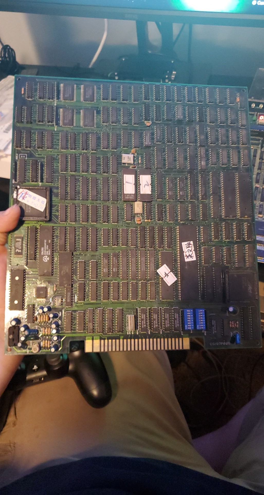

heres picture of my board.
hi :
Is it me or does that board seem dirty around the socketed act chip and around tge sound section?
What about a photo of the rear 8 bit?
Have you checked out the electrolitic caps are they swolen anywhere or broken legs?
regards
euphoria
If pin 10 is speaker on the Jamma harness anyway, what difference would bringing it out to a headphone jack do you anyway?
Aside from moving the signal to a different place it wouldn't actually accomplish anything.
