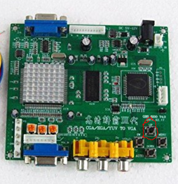

Then this picture of the encoder board with the messed up red circle that could barely draw with a mouse shows a specific button that I can hit on the vga encoder board after the board is powered on on and it seems to refresh the screen. But at this voltage it just updates to still images, in order to get it to move I have to move voltage up to the ones I described in my original post. The picture flips and is horrible but at least I can tell the game is in attract mode and moving. (but I am afraid to turn it up that high again because I don't want to fry these boards...

The video encoder has an auto button, usually pressing that will resolve most issues. There's also a menu button with various settings that may need adjusting. We'll get to that later though, let's sort out power first.

Q2) Those el cheapo encoders can cause all sort of issues. A couple of things to consider:
- Have you adapted video signals and sync with resistors or are you using them coming straight from the game boards?
- Try changing vertical position setting on the encoder to something >= 28.

-Set the vertical position on the encoder to 28

Q2 - Why is vertical 28 value magic on the encoder board to keep the screen from flipping like it was? Is it like a standard arcade monitor resolution or is it specific to high impact or Williams games?
