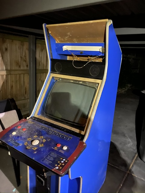

Earlier in the year here in Melbourne i had the opportunity to get my hands on a holy grail of mine the covenant BIG BLUE DYNAMO usa import

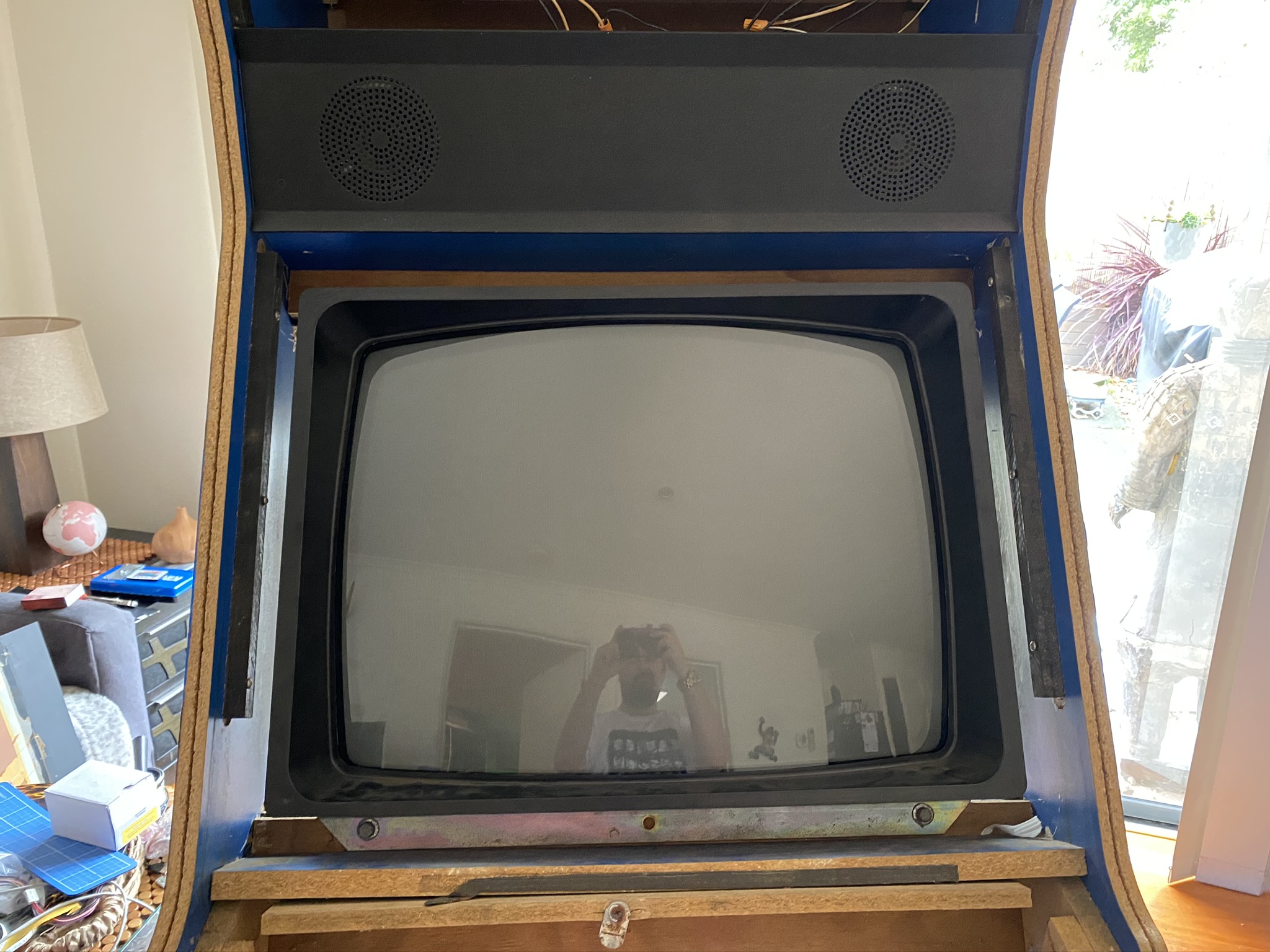

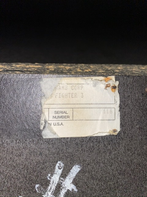

For those who dont know these are the cabs capcom went with for their official streetfighter games aswell as others it was my chance to finally have my ultimate SF machine this is how it came a old beat up golden tee but i knew what it was and it had the infamous hilarious dynamo label still on the back

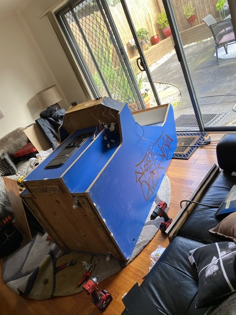

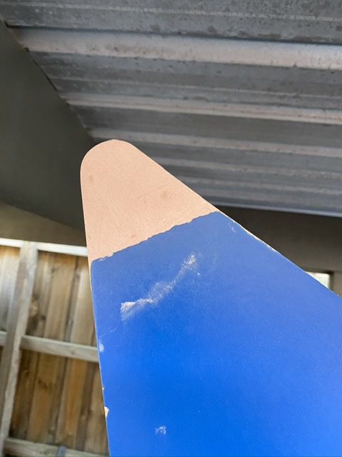

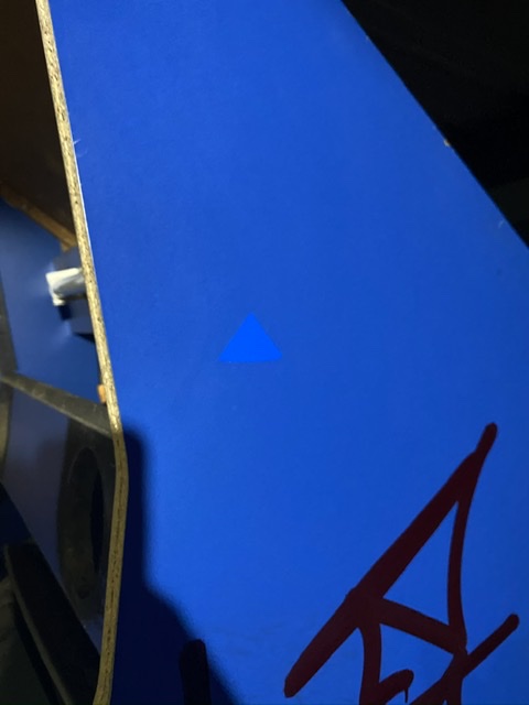

first thing to be done was to fix the top right hand side corner so built a frame measured to opposite side and filled it with builders bog n then shaped it to suite which i then sanded back filled any other dent in aswell whilst i was at it

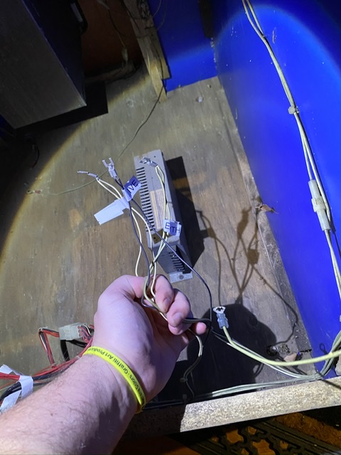

next thing was to clean out the internals to get it ready for wiring

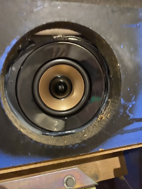

This particular cab was made for SF2CE which came without the qsound amp after looking online abit I decided to opt for a decent set of logitechs (z533) to go in its place instead running the rca to the cps2 board so i took out the olds and hot glued the logitechs in place you would never know that they were with the big black metal plate covering em up
Ok so cleaned and gutted out what was left behind inside I decided to go with a RT-85A Meanwell powersupply from digikey and a 500w tortech isolated 110v Stepdown

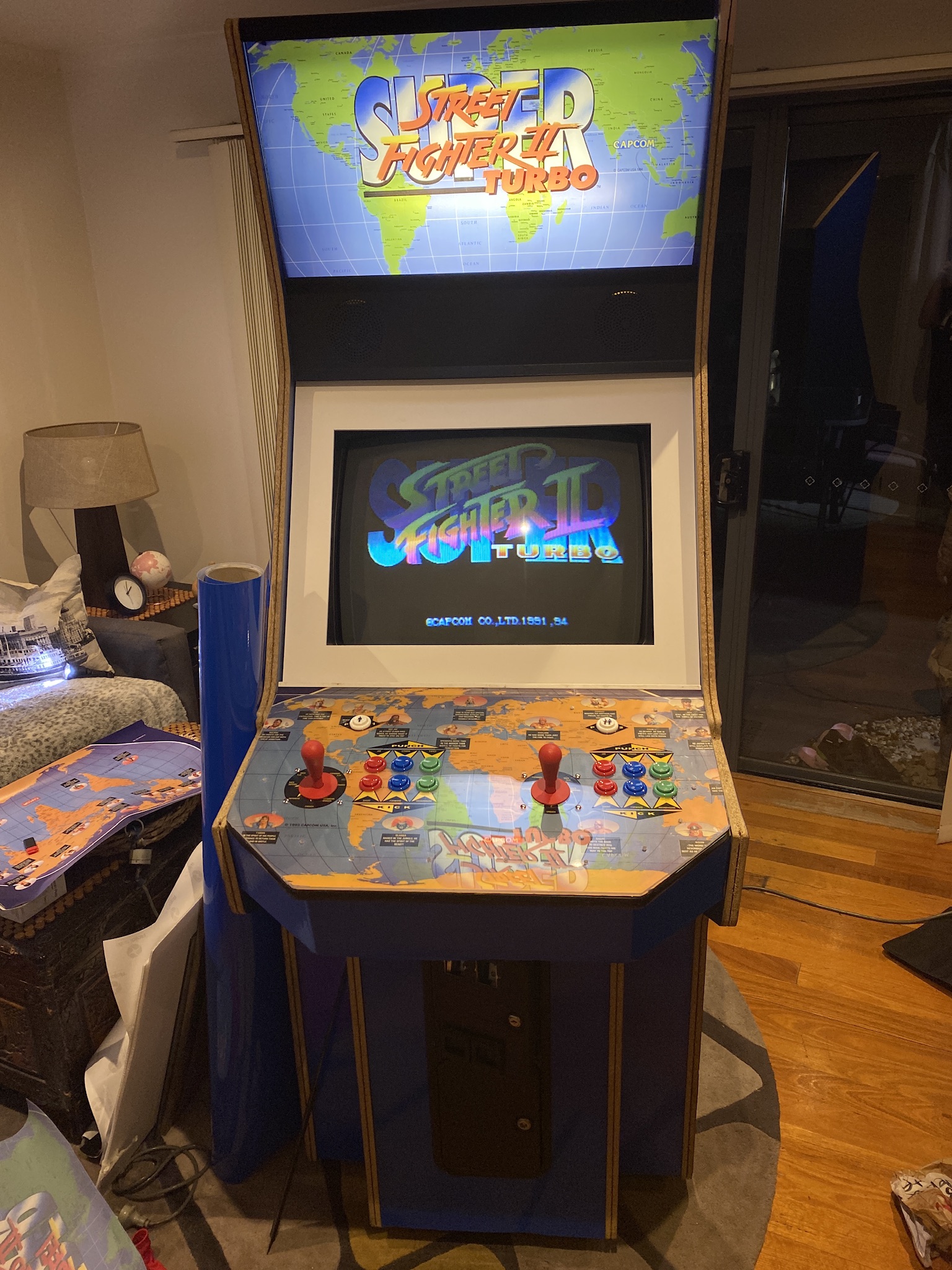

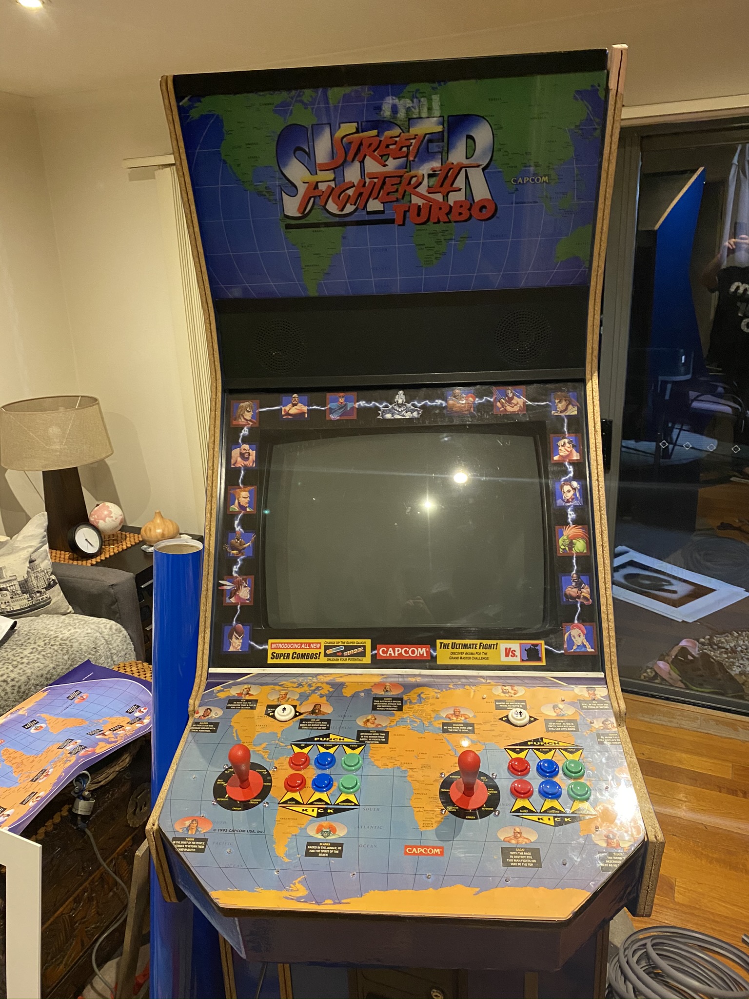

next on the agenda was to sort out some artwork for this beast , i had my panel out with a plastics company to cut me a sheet to shape with all the holes lasered out
i got a hold of a screen surround and stuck it into place then got 2 pieces of 3mm foam board and cut it perfectly in the middle so i could then mount my bezel artwork to it and also cut out in the middle , it came out looking so so good i also got my translucent marquee print wedged between a piece of opaque and clear poly to make the lightbox complete
adding 2 il euros and american classic dimpletop buttons along with control decals i was able to line it up superb

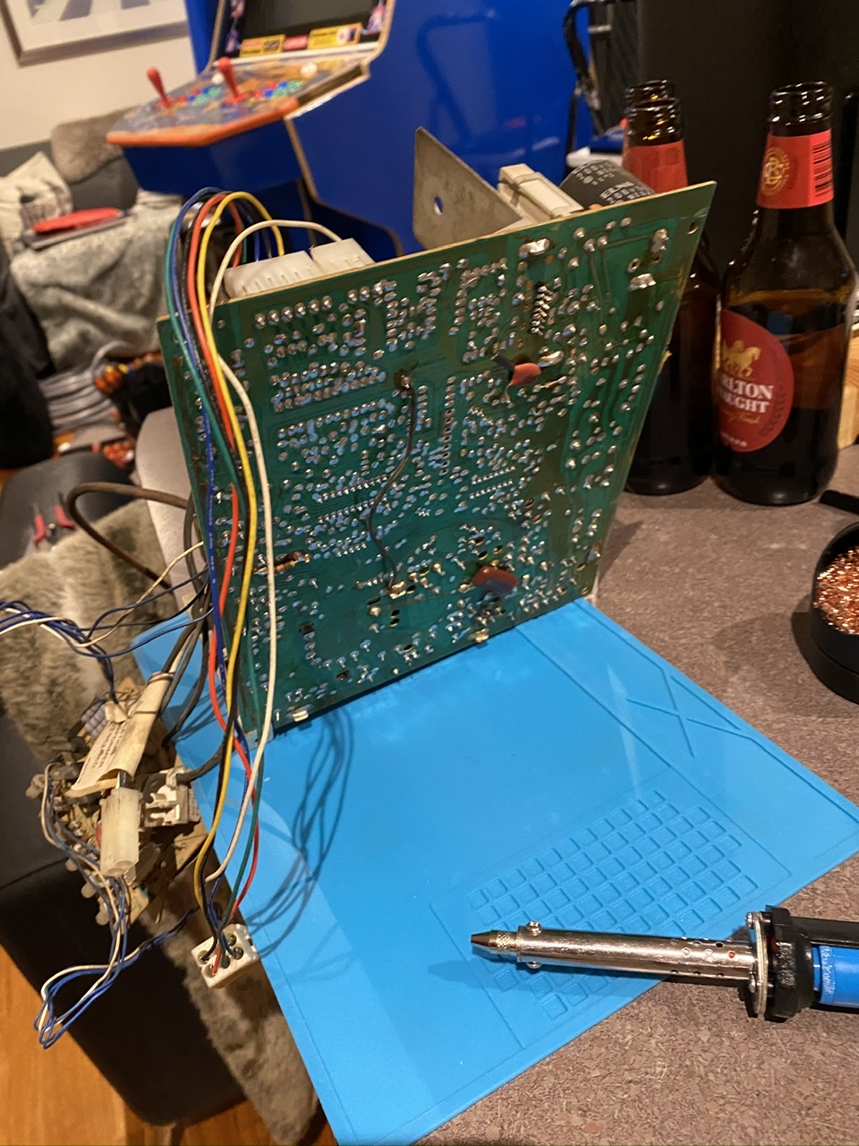

Next came the screen it is a 26" zenith running a wells chassis not having done a recap before i was super keen to give it a crack and im glad i did cause it went 59C7FFCE-9050-4261-A439-D2403B2A0B20.jpegperfect
So after all that was done all there was left was to wire the buttons and test it all out

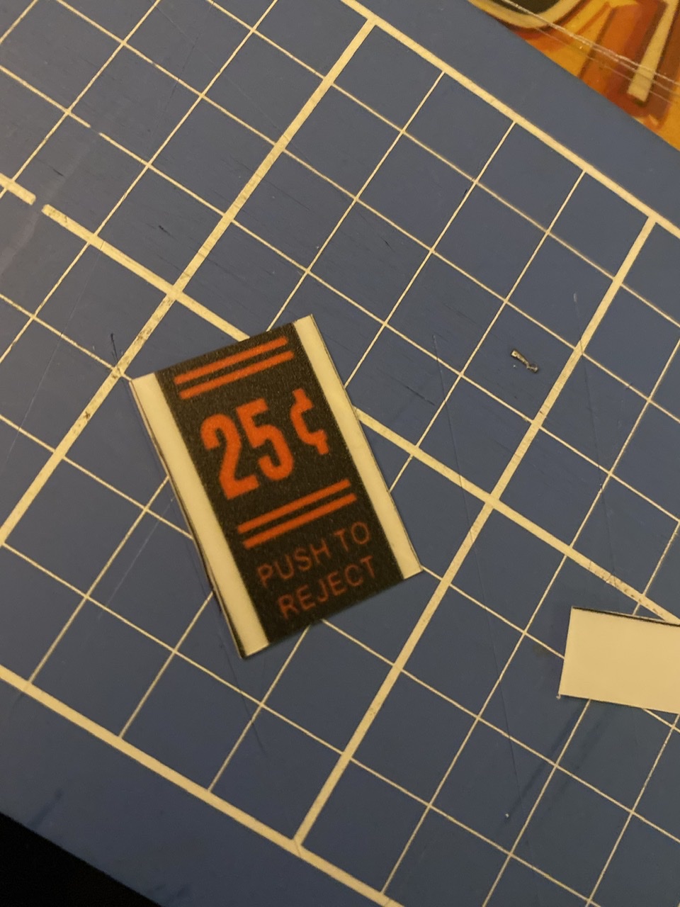

added led bulbs and new translucent coin pricing slips to give it extra life

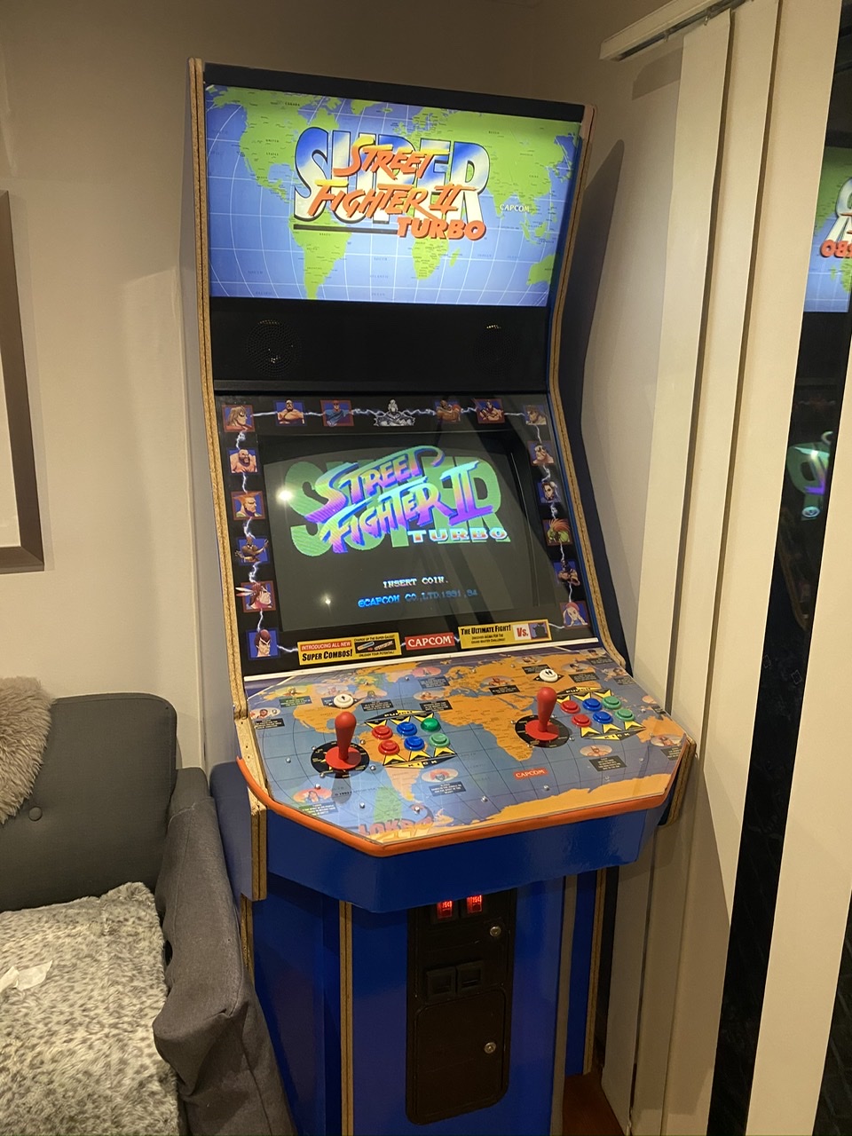

currently running hyper streetfighter anniversary in it with my moves list art about to be applied will also add those pics when done
