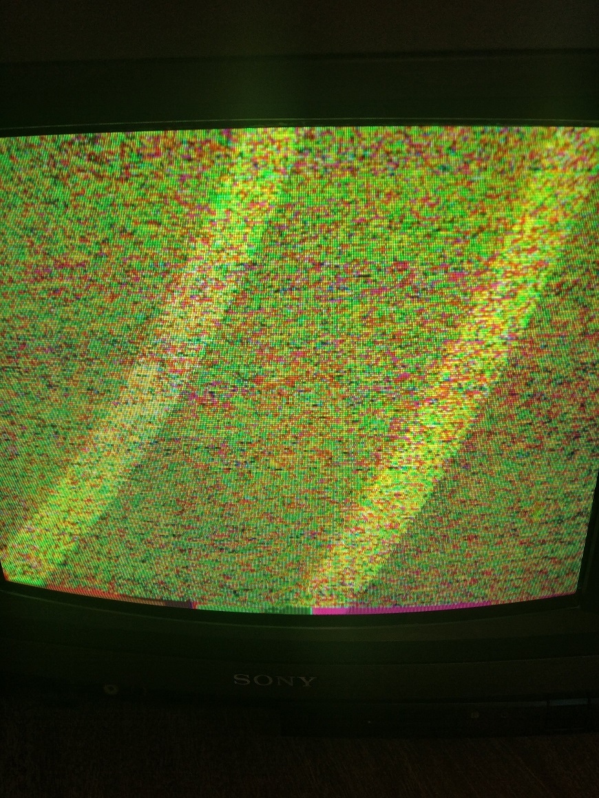

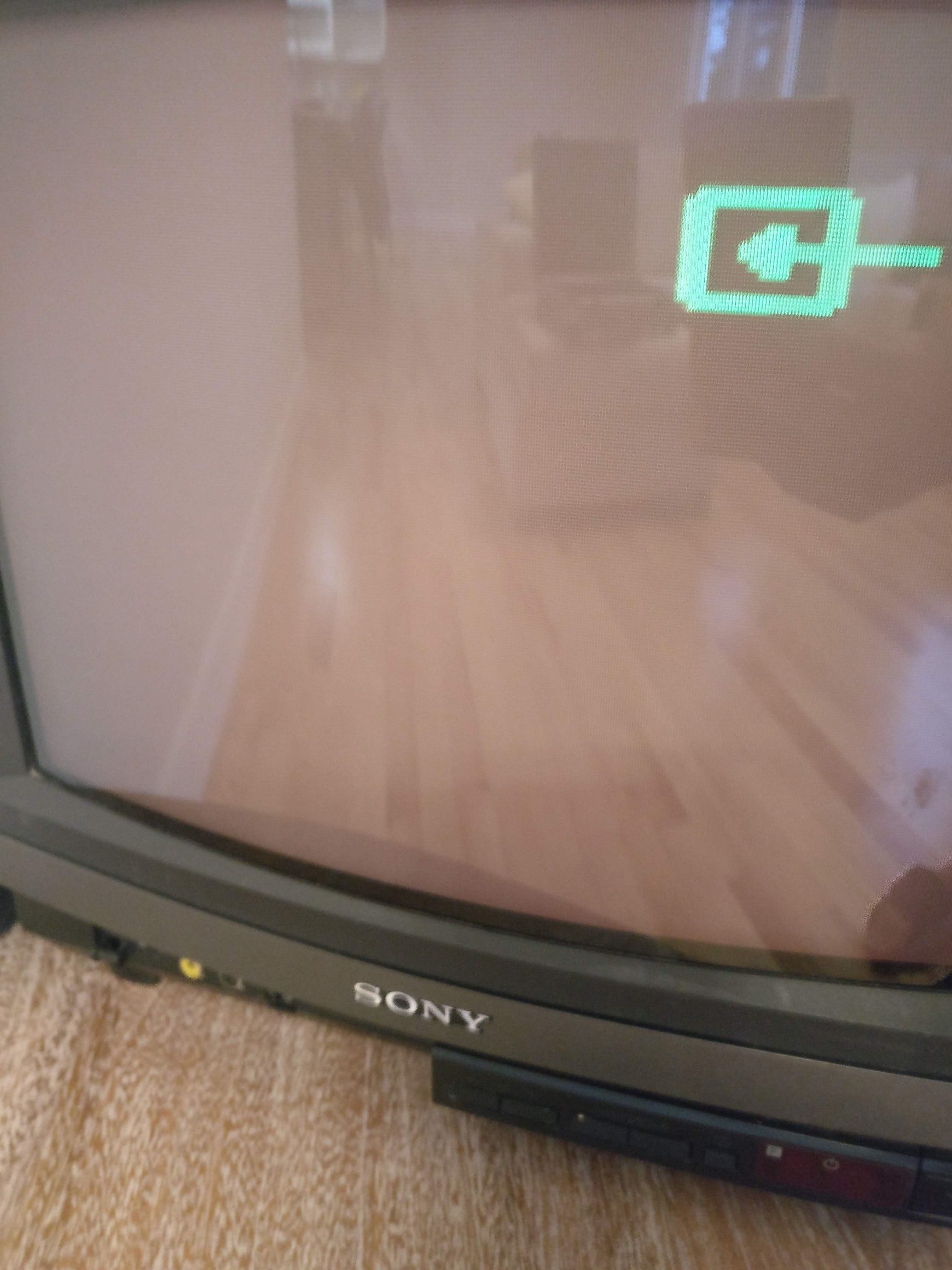

I've been having some trouble on my supergun with my cps3 not booting like normal. The supergun itself appears to be in working order since it's loading my NeoGeo just fine and the 3s board itself does turn on.
If I boot the board with no cart in, I get a scrambled image and when I boot with the cart in, I get a blank screen and that's it. Based on this, I'm inclined to think that there is something wrong with the cart but I don't really know what could be the case.
The only real changes that I've made from when it was working to now was moving to Canada but upon looking at the PSU, it is rated to work from 100-240v and as mentioned above, it runs my NeoGeo with no issues. The only change to the CPS3 setup itself is using the SCSI2SD which has been working without issue when I was using it in the UK. I'm not using the molex cable since it's not needed it but maybe that's it.
I've attached some pics of what it looks like and any help would be much appreciated.

Black screen is a cart issue. If it is an original cart still without SuperBIOS then it is most likely suicided.
It's got the superbios on it. Sorry I should have specified in the op.
Can a superbios cart suicide?
I would check your 5v. Make sure it is at 5.0.
Also clean your cartridge / slot with isopropyl alcohol / electrical contact cleaner.
I just cleaned the cart and it's a no go. But I think that it is the 5v since I tried it with my cps2 and that behaved the exact same way. Certain weirdness I can chalk up to the CPS3 being temperamental at the best of the times but the CPS2 tends to not give much fuss. I'm willing to bet it is the PSU.

To bad your not in the west coast, I would have tested for you. Black screen on boot (even with garbage with no cart) is a cart/cart slot problem for the most part. If it end up being a bad cart, let me know and I can help out.
Really appreciate your help and I'm not counting it out. I'll definitely let you know if I need someone to test it.
Remember as well that the main CPU for CPS3 isn't on the motherboard, it's in the cart. That's why you run into so many issues if the cart edge or slot is dirty
The garbage screen above is typically what you see when an SH-2 CPU is loose and needs a reflow or damaged as well. You would absolutely see that if it's not making good contact due to a dirty slot/edge
