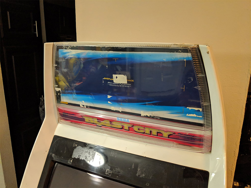

Oh cool, I'll check into that. Something like goo-gone safe to use on it to get rid of sticker residue?
It should be "safe" but you know what works really good/better? Ronsonol lighter fluid.
Won't damage/haze plexiglass like acetone will.
5019818
All of that is cleanable. Buy Simple Green and spray the shit outta the marquee card and plastic holder. The tape residue will also come out using isopropyl alcohol 91%. Put it on a cotton ball and keep rubbing it in until it comes off.
I had that same residue on my blast marquee, and it took a lot of effort to get it off. It does eventually rub off though, just keep hitting it with the isopropyl alcohol.
I just noticed you had residue on the black monitor bezel. Don't put alcohol on that, it'll fade the paint. Use goo gone for that.
