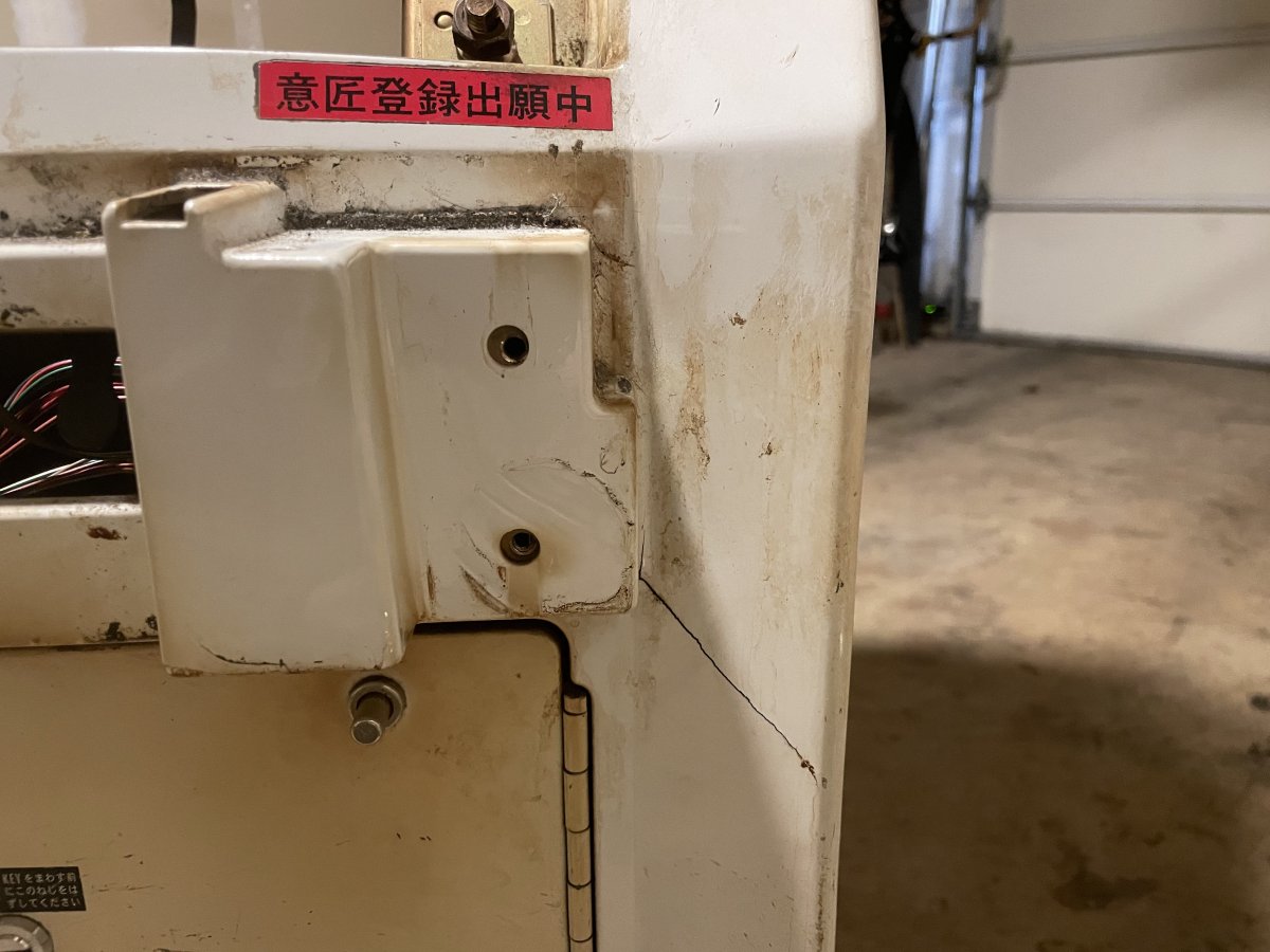

I'm refurbishing a Blast City that we totaled out from a recent container order. Really bad cracks that kept growing as we moved it around the shop. I took it to a local auto paint supplier and we matched the paint to the code 18S6718 from the Valspar automotive book. It's an exact match! This also appears to match the Net City and Naomi Universal. Hopefully with this info there will be fewer people spraying these things with bright white Krylon.

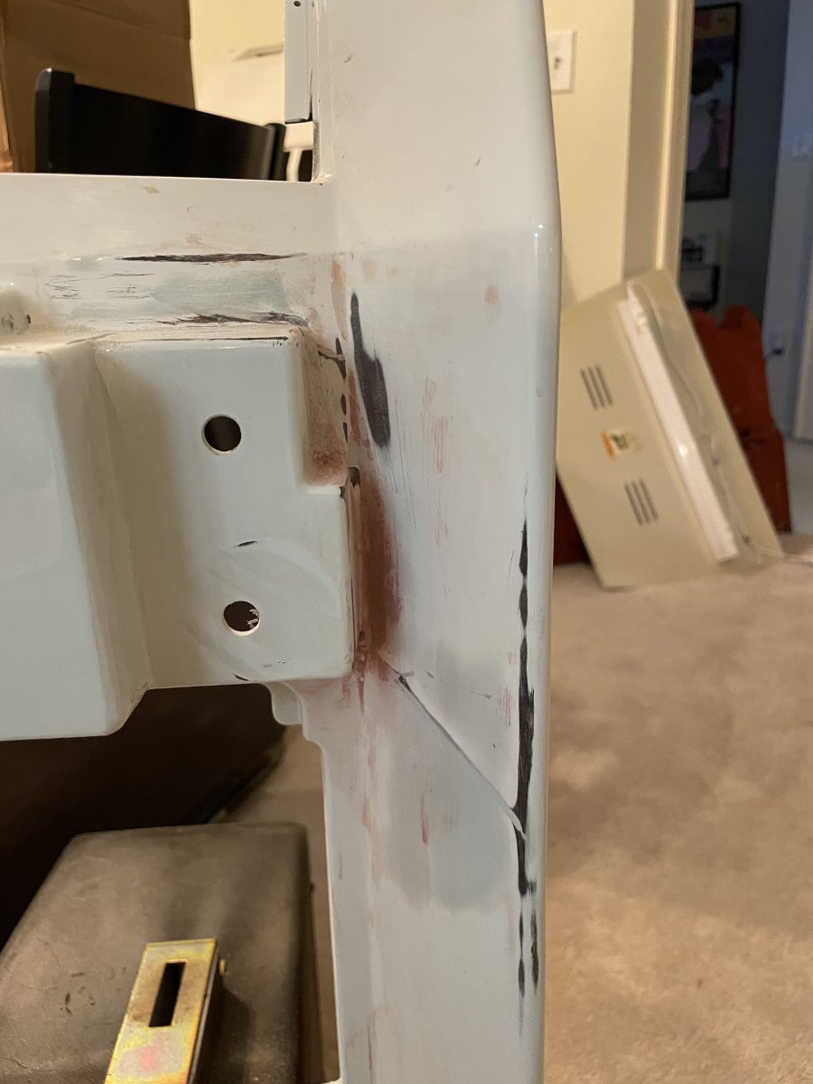

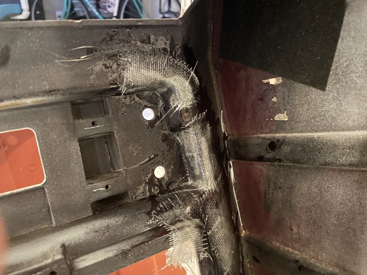

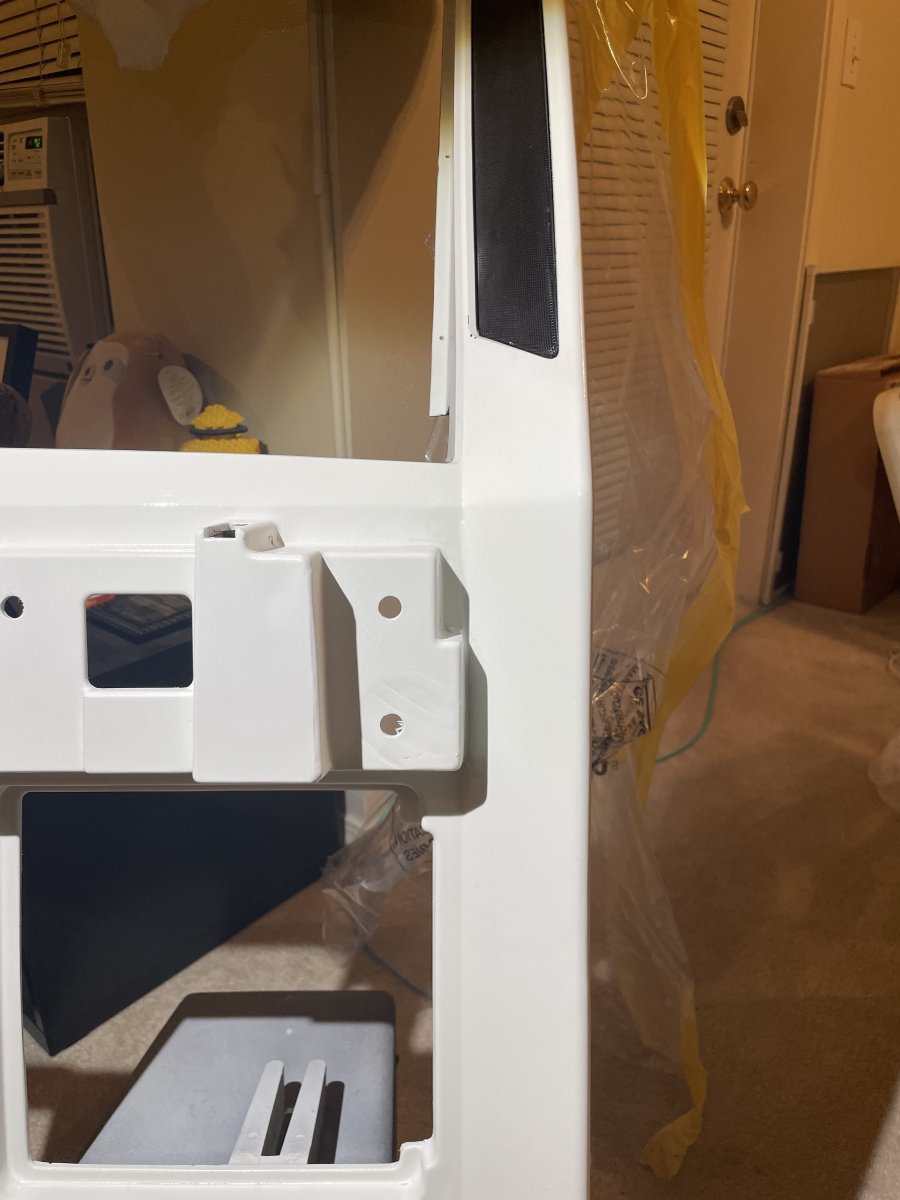

As for the crack repair itself, I first dremeled out the crack on the inside of the shell with a wide V shape, then I sanded with 60 grit and used epoxy resin and fiberglass cloth to give it strength. Then on the outside, I dremeled a V shape into the crack and filled with body filler, sanded, then did the paint work. So far it feels extremely rigid; I have no doubts this will hold up to regular home use and then some. Remember: the strength comes from the glass fibers, NOT from the epoxy bond itself. I definitely learned a lot during this process and am excited to try it again.
