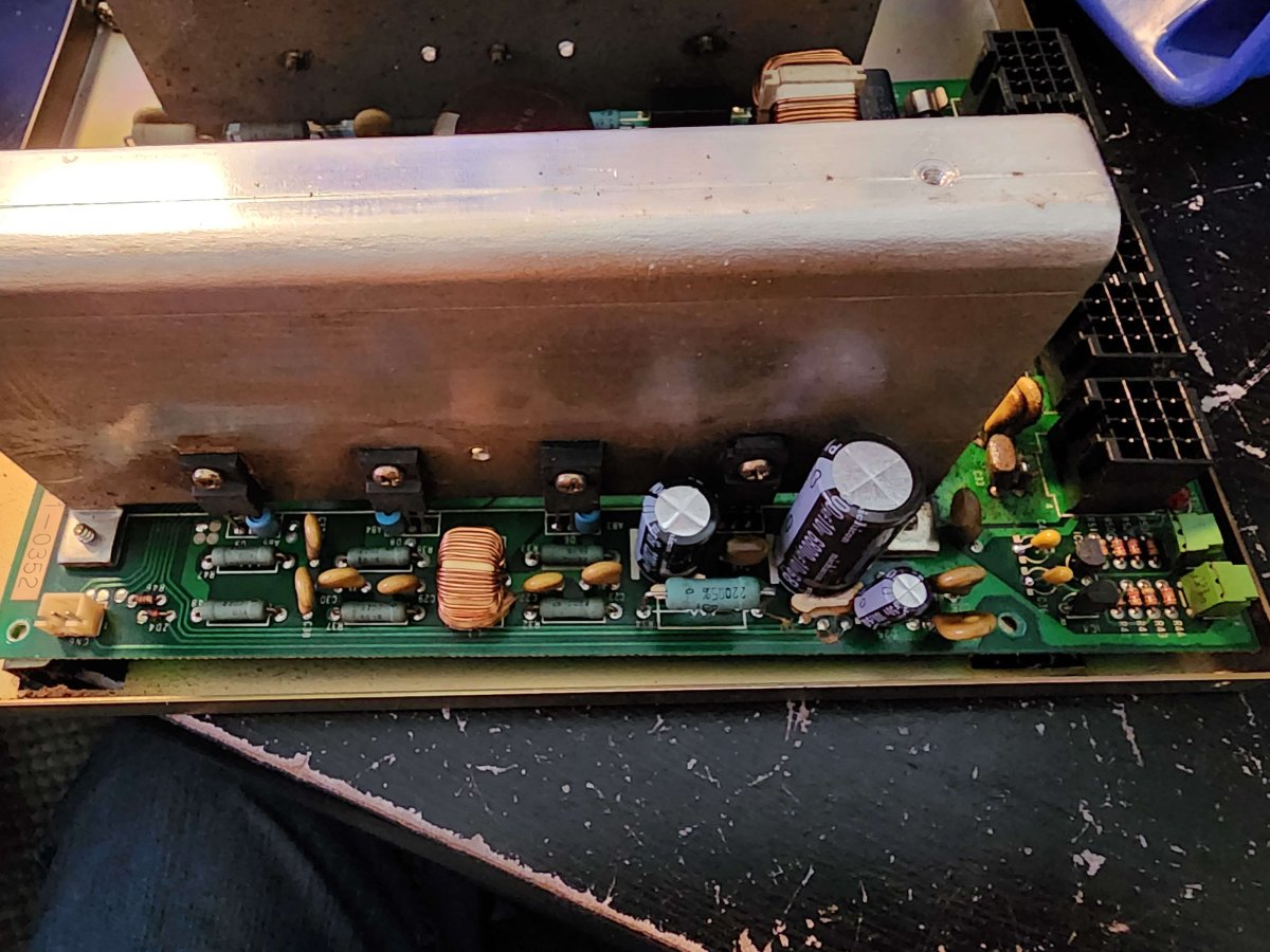

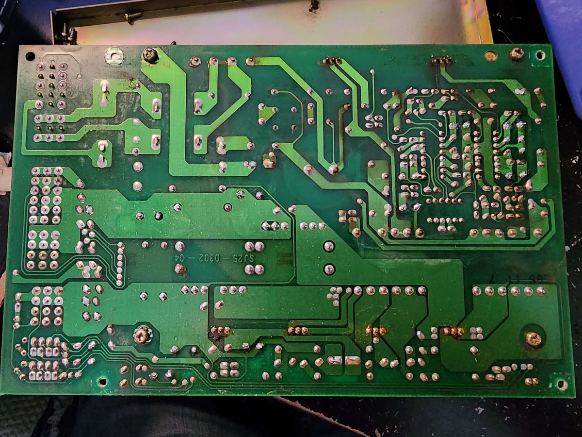

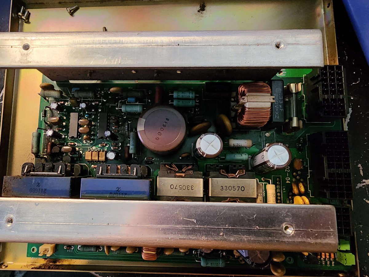

Got an issue with my Blast City PSU. My Blast worked fine with every jamma game I tried on it, but I noticed the 5v rail was running a bit low at 4.4v when a game was plugged in. Tried out my naomi 2 and sure enough it wouldn't boot.
I bought a cap kit, recapped it with no issues, and now it wont boot up any games and the fan wont spin up. The monitor sounds like it works fine (with the iconic 15khz sound) but I cant get the monitor OSD controls to come up, and the 5v pin on the jamma harness reads barely 3.5v with a board plugged in.
I double checked all the soldering, double checked the orientation, and double checked that the caps are in the right place. I also made sure to buy the caps from a reputable source (arcadepartsandrepair's website)
I provided photos as well, though they might be a bit blurry so let me know if I should take a closer photo of anywhere.
Anyone know where I should go from here?
Edit 1: Tested the 5v pot, seems to adjust resistance just fine with a multimeter, but the output does not appear to change when I have it plugged into a board. Tested all the caps solder joints for continuity, and everything is making good connection.
Edit 2: Good news, well sort of. I tried pretty much everything I could and it still didn't work, so I went ahead and started to put the old caps back in. One of the pads ripped off on C39, but luckily it was on the opposite side and wasn't an issue. I got about halfway through, tested it, and the game now powers up and I am back to the original 4.4v with a game in. There was no sound and the fan still doesn't spin up, so I am gonna finish putting in the old caps for the 12v rail and I *think* I should be good. Will update accordingly

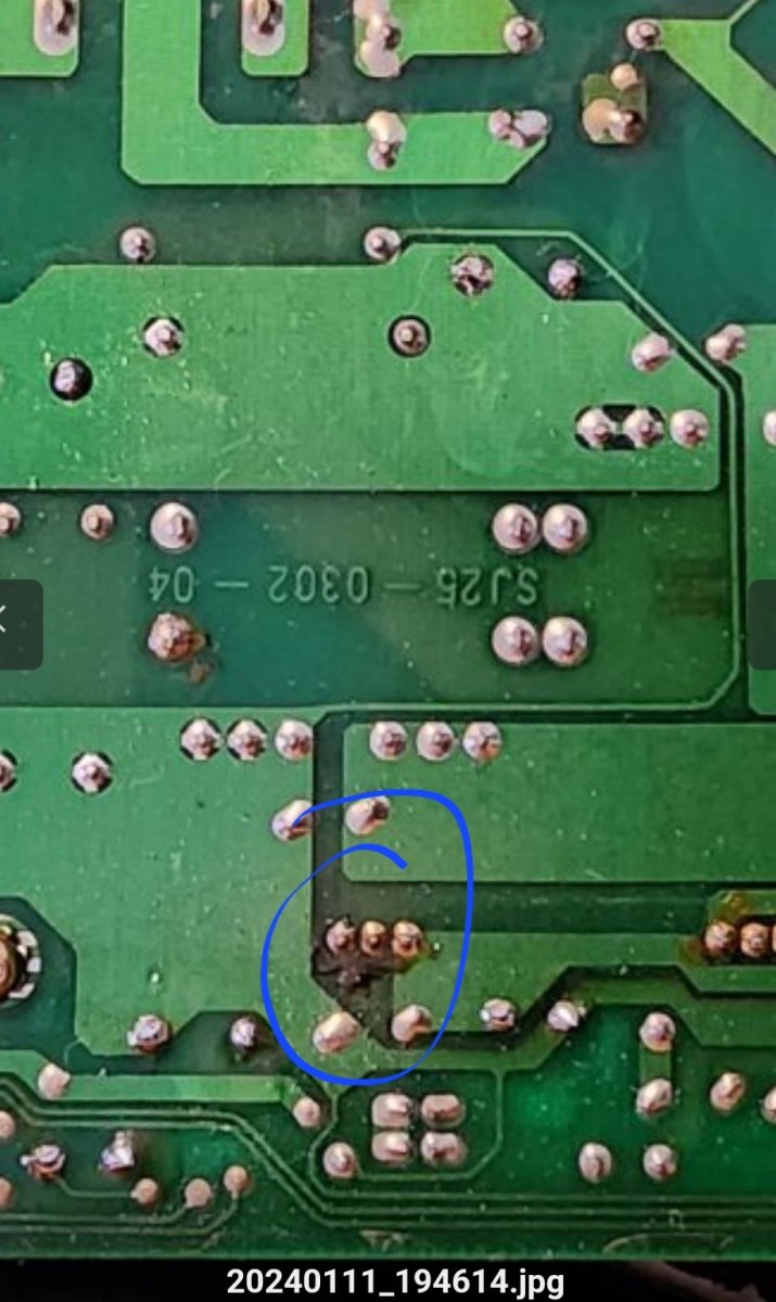

Can you get a close up picture of this?
Also do you notice anything get abnormally hot really fast? Maybe some of the big metal heat sinks
Seems like a bit of old flux. And I do not, but I can check again when I get home from work

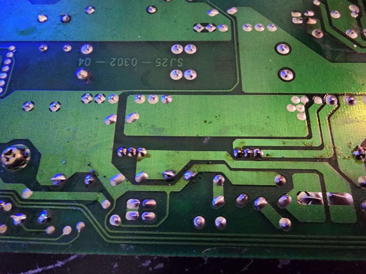

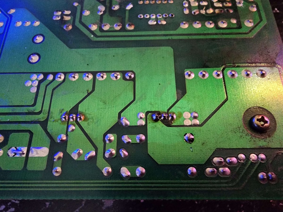

Try cleaning the connectors on the psu and cab side, use deoxit or something like that.
You can try checking for cracked joint and reflow those.

I had a similar issue with my Blast PSU and I did what Derick2k suggested above. After a recap, I reflowed every solder joint even if it was shiny, then I cleaned the connectors with IPA and then used deoxit before plugging everything back together. After that, solid every time. Good luck!
