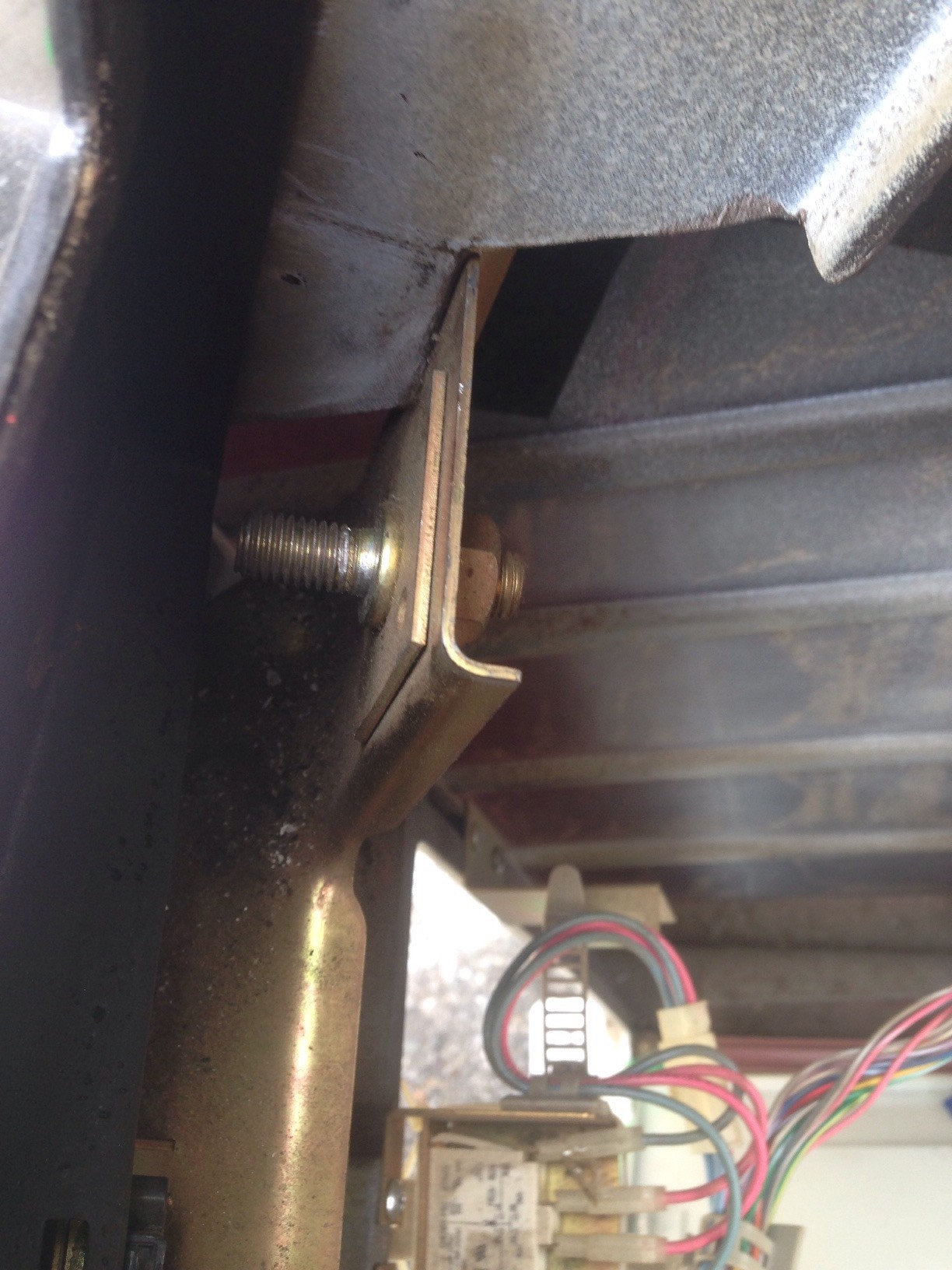

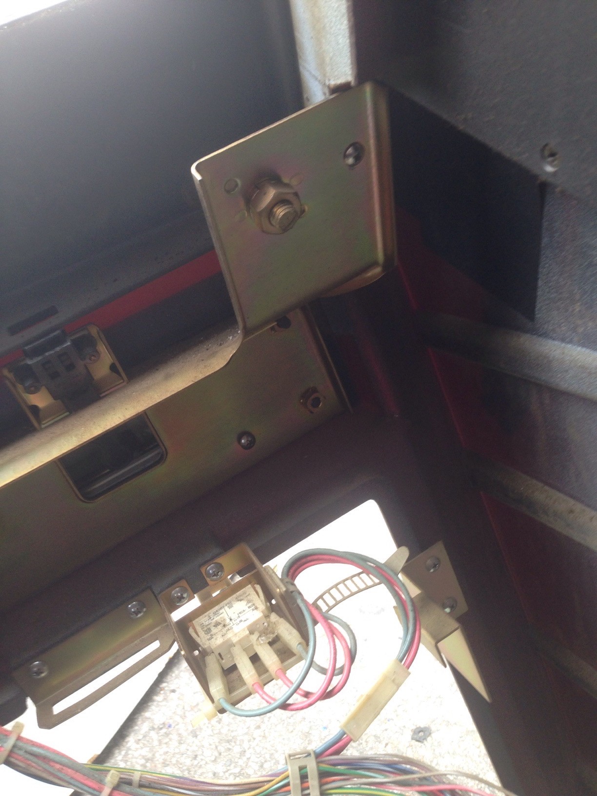

Jassin,
Is this what you are talking about to mount the monitor?
Remove the bezel, undo the 4 bolts at the corners of the metal frame... Pull the entire frame/tube out of the cab.
Once removed discharge the tube, pull the chassis and the tube from the frame and start to back mount the WG frame.
The pics you snapped above are of the frame inside the cab body, you'll need to remove all this.

So the frame from the WG D9200 will not work?
Correct, the entire tube must be stripped and backmounted to the Nanao frame (what I've been saying this entire time).
If you are saying that I need the Nano old monitor frame and put the WG D9200 in that frame them I have a problem
Yes you have a major problem!
The ONLY frame that will ever fit cleanly into that Blast cab is a Nanao.
You don't need the Nanao tube, chassis, neckboard, blah blah... But you can't mount without that frame period.
