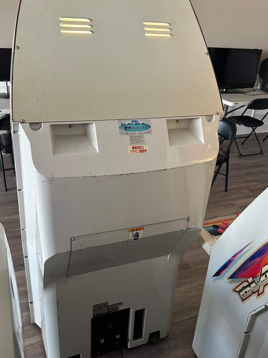

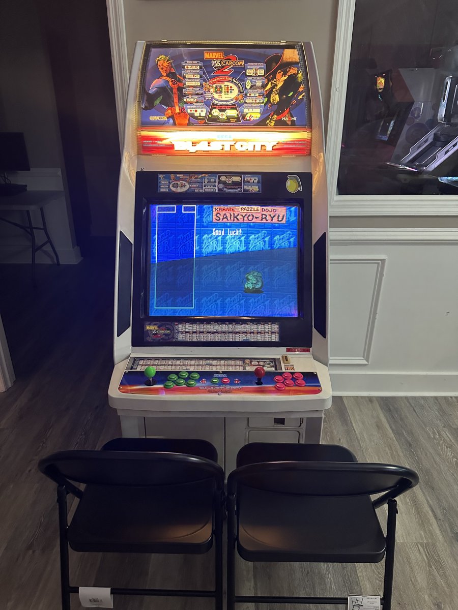

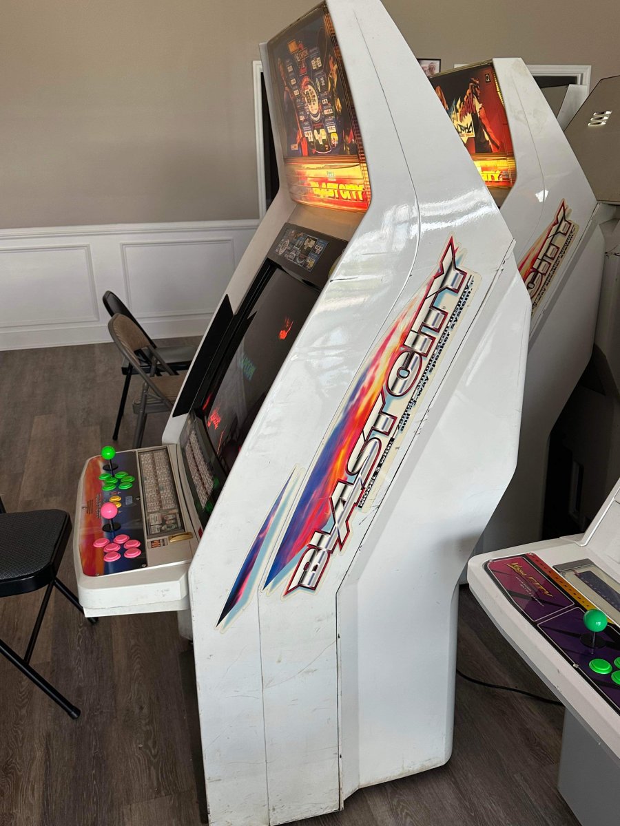

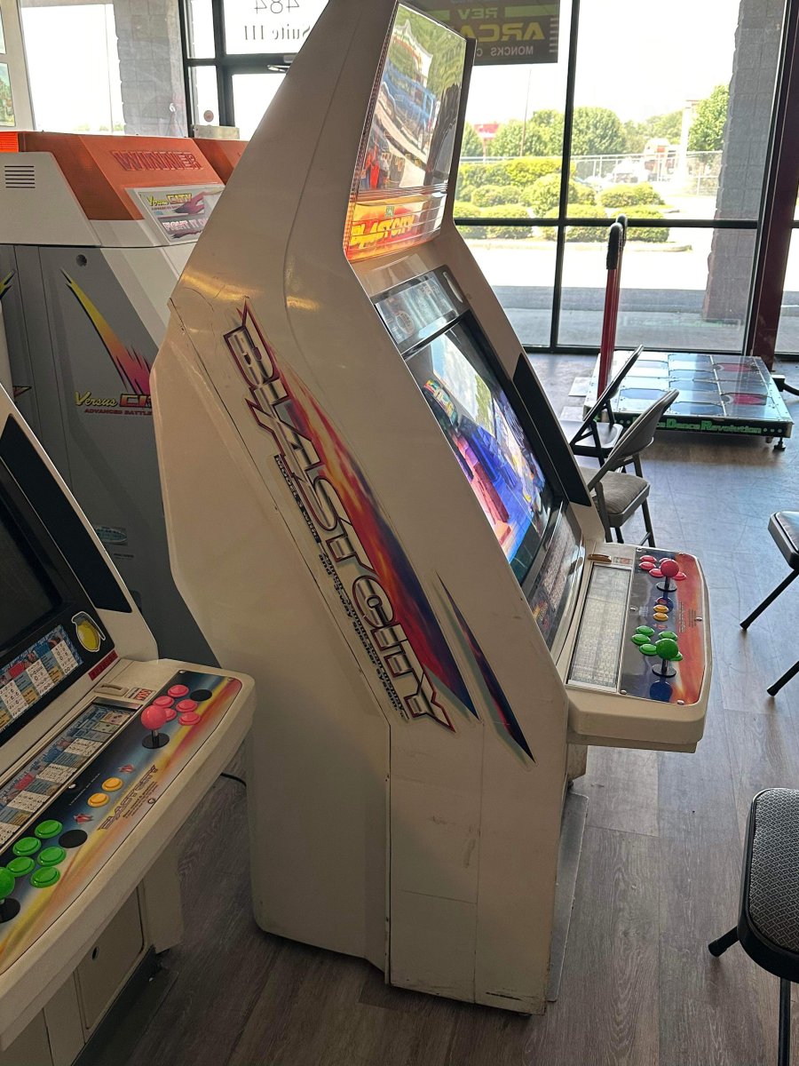

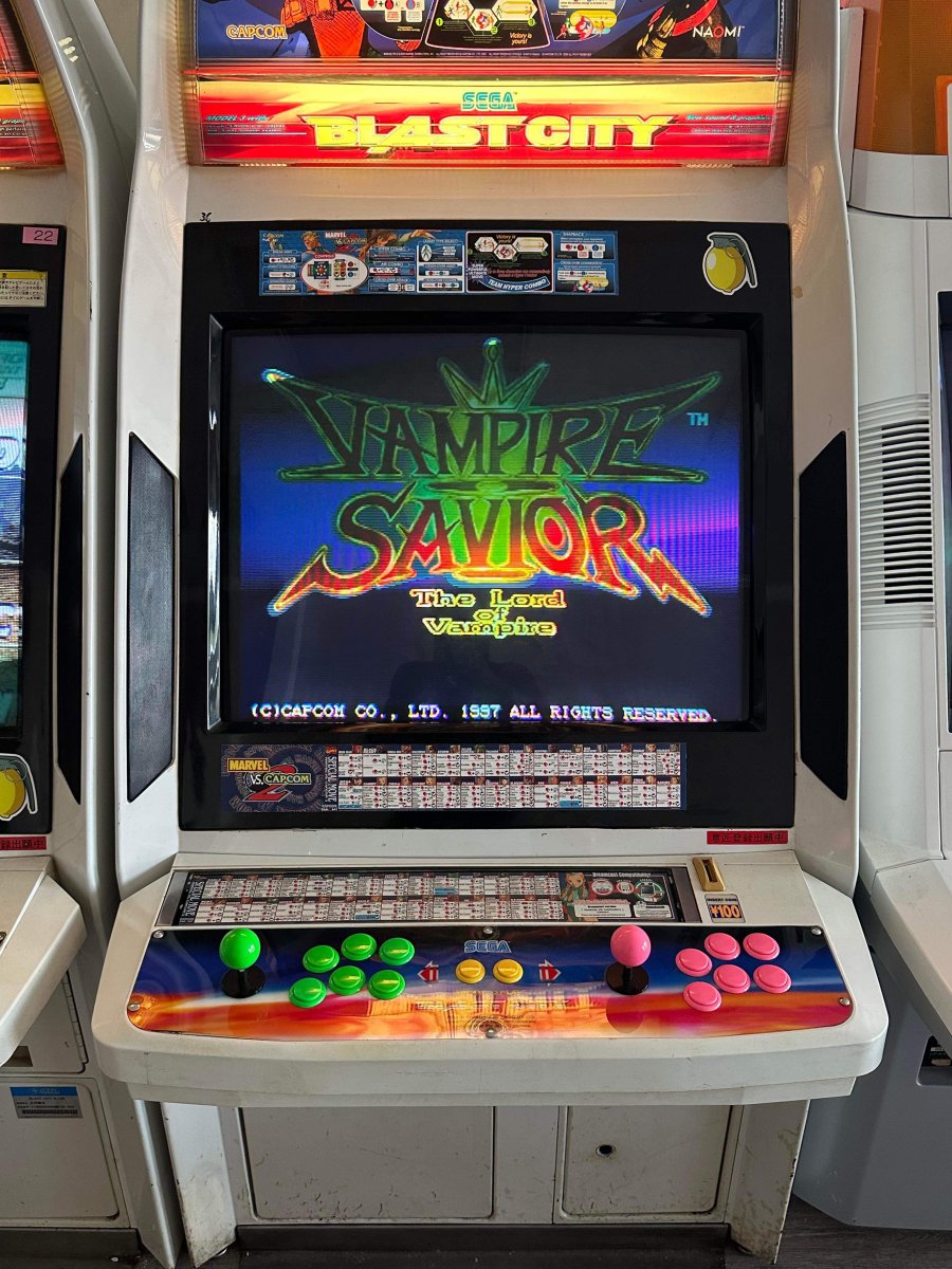

I have a blast city that I am looking to sale. I am located in Moncks Corner, SC. It perfectly works 100% I can happily give more video and pictures of condition and with it on. MS-2930. I recently just changed the buttons from sanwa to Baolian. Last picture is most recent.
Asking $1800. Buyer must arrange shipping.
