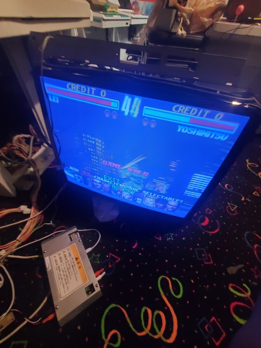

Alright, I got a Toshiba tube with a dead blue gun(burn dree too 😪). (See pic of bars: colors present, red, green, YELLOW)LOL Idk anyone near me with a rejuve to zap the blue gun IF it'll even help it at all at this point, so here are my options.
I also have 2 working Sanwa es2931s tubes with a nice picture, I just can't get them to fill up the screen horizontally all the way even at max with 2 capped Nanao ms2931s chassis' that I've tested
(IF ANYONE HAS A PAIR of WORKING SANWA CHASSIS FOR SALE LMK)es2931s
I also have a nice pair of working D9200 crts but only 1 chassis. So I'd be interested in a working D9200 as well if anyone wants to part with one. I'm trying to set up a VS H2H BLAST KIT.
Any suggestions??
Are you using the yoke for the sanwa or the Nanao 2931?
I’ve used that same tube to swap but used the original yoke for the Nanao 2930. Looks and works great
He's using the original yoke, that's why the picture doesn't fill up.
MS293x yoke is 0.200mH, 29e31s yoke 0.300mH.
You know, Idk why I'm using the es2931 yoke. I'll swap em and report back!
