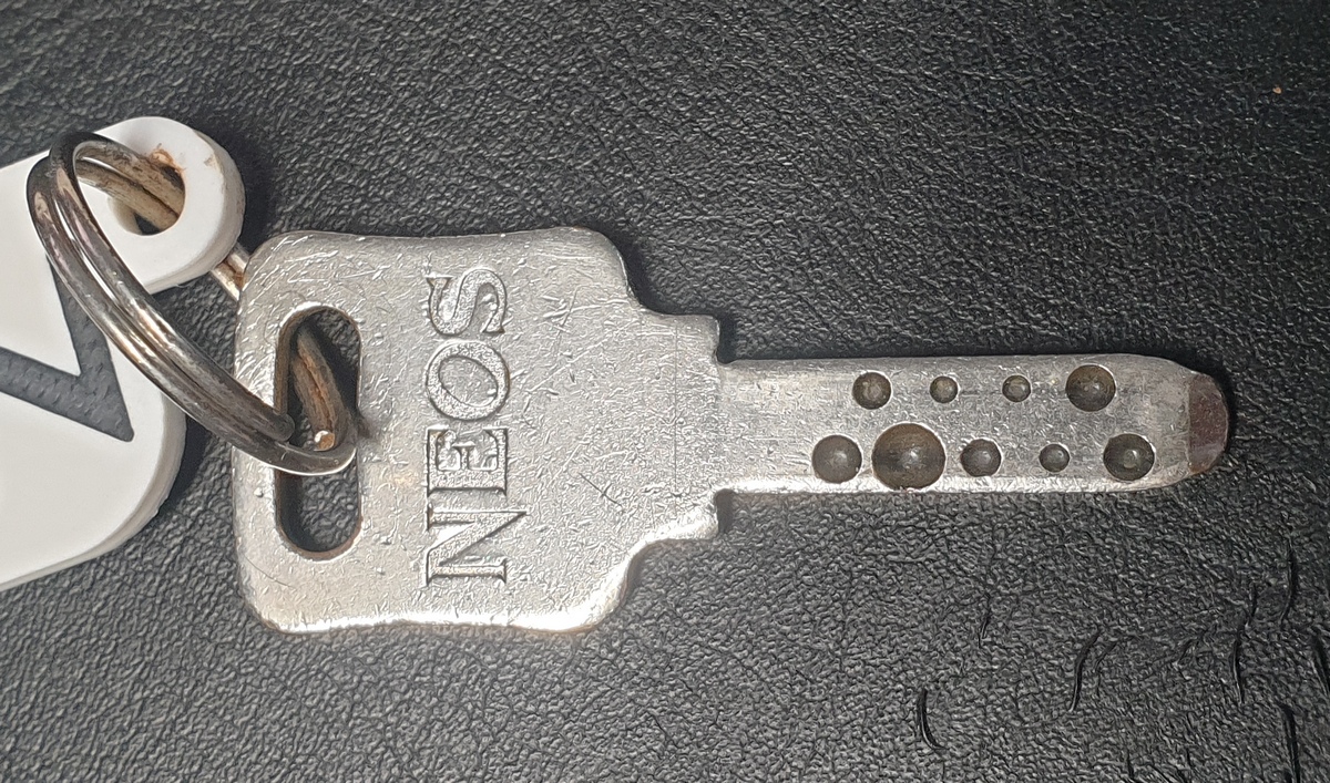

They key it came with was a NEOS K0001, which is a very similar key to the Sega 55xx series keys. Double sided, 9 holes per side. It's not super small, but on the scale of 3D printing it's pushing the limits, I think.

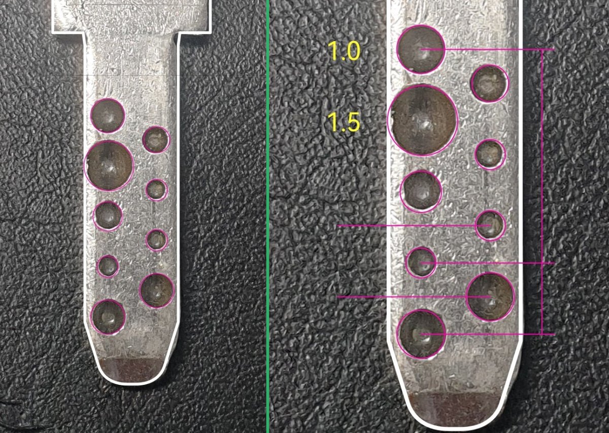

1. I took a photo of it, loaded that photo into Inkscape, and traced it.
2. I measured the key with calipers and scaled the inkscape drawing to the right size, then
3. measured all the drawn bits to get a handle on the size of the key, the pits, etc.

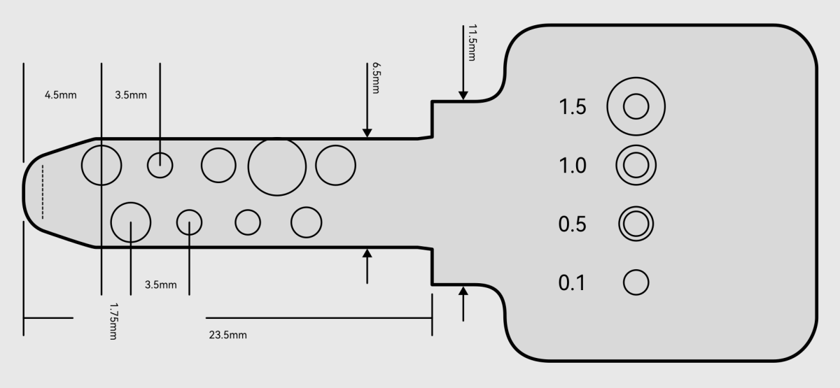

Coarse measurements were easy. The blade was 2mm thick, 6.5mm wide. The pits were 3mm apart along the blade, the first was 4.5mm from the tip. Both rows are 1.5mm from the sides.
At this point I was rounding things to the nearest half mil, and it seems to have worked well. I reasoned that the pit width wasn't important, but the depth would be. I had a broken IC socket with tiny metal legs handy, so I put a leg in the pit on the key, and marked it with a sharp blade, and used the calipers to estimate the depth. They seemed to range from 1.5mm to an impossible to measure shallow depth, which is probably a zero pin, and I figured 0.1mm would be fine. It's as good as zero to the pins in the lock, I'm sure. The other two depths I found, were 1mm and (another guess) 0.5mm. Four depths total.

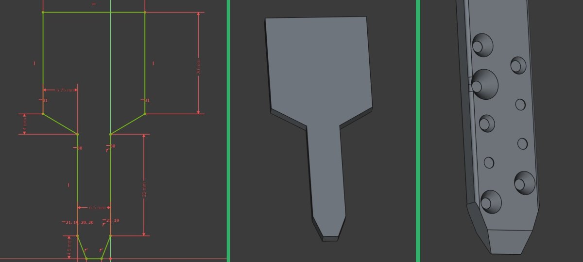

I took my head full of measurements and fired up FreeCAD, and started drawing. I outlined a simple key, and started putting in the holes. I did four passes, each a 1mm wide hole, with the appropriate depth. Once they were etched into the blade, I beveled the sides at a 60 degree angle, which seemed to match the original hole sizes when done.
A few chamfers, a few fillets, and done.

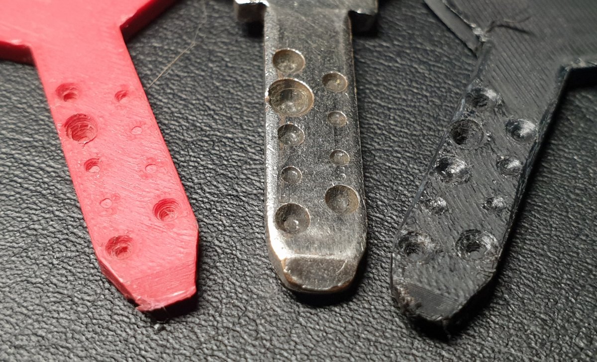

I didn't want the key to snap off in the keyway, so I went with PETG. It's more flexible, and I figured it'd bend before breaking and I'd be able to pull it out without causing too much trouble. Unfortunately, at 2mm thick, it's too flexible and if there's any resistance at all, it ain't gonna turn the lock.

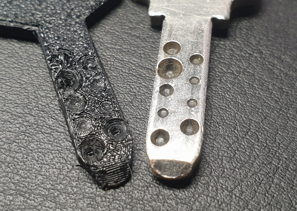

The two test keys worked first try. I used a small drill bit to clean up the pits, but the size and depth weren't adjusted before testing. The collar was too far back, allowing the blade to enter the lock a little too far, but pulling it back a half mil was perfect, and the lock turns with zero effort.
It looks a bit stringy up close, but it works well enough. 0.1mm layer height, with a 0.2mm head. By reducing the layer height to .05 I managed to get better results, though there's still a noticeable lack of clarity on the pits. When I shifted to PLA I got much better results in clarity, but at 2mm thickness there's still not much in the way of torsion strength. Maybe putting a metal layer halfway through would help, maybe it's pointless, IDK.

If anyone wants to try and duplicate their own key, here's the dimensions as I understand them.
The inner circle diameter is always 1mm. I made the slope of the pits 60 degrees.
