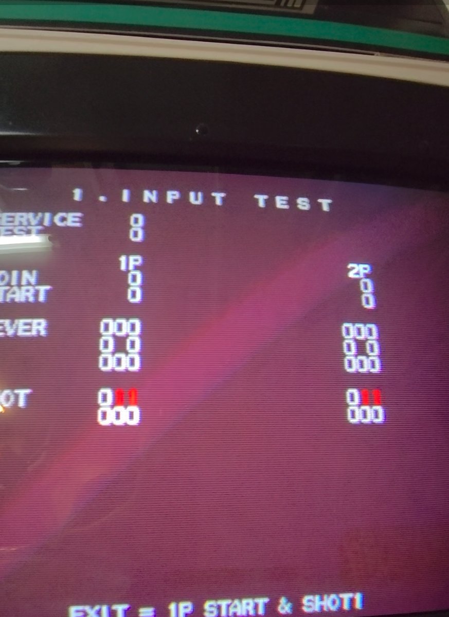

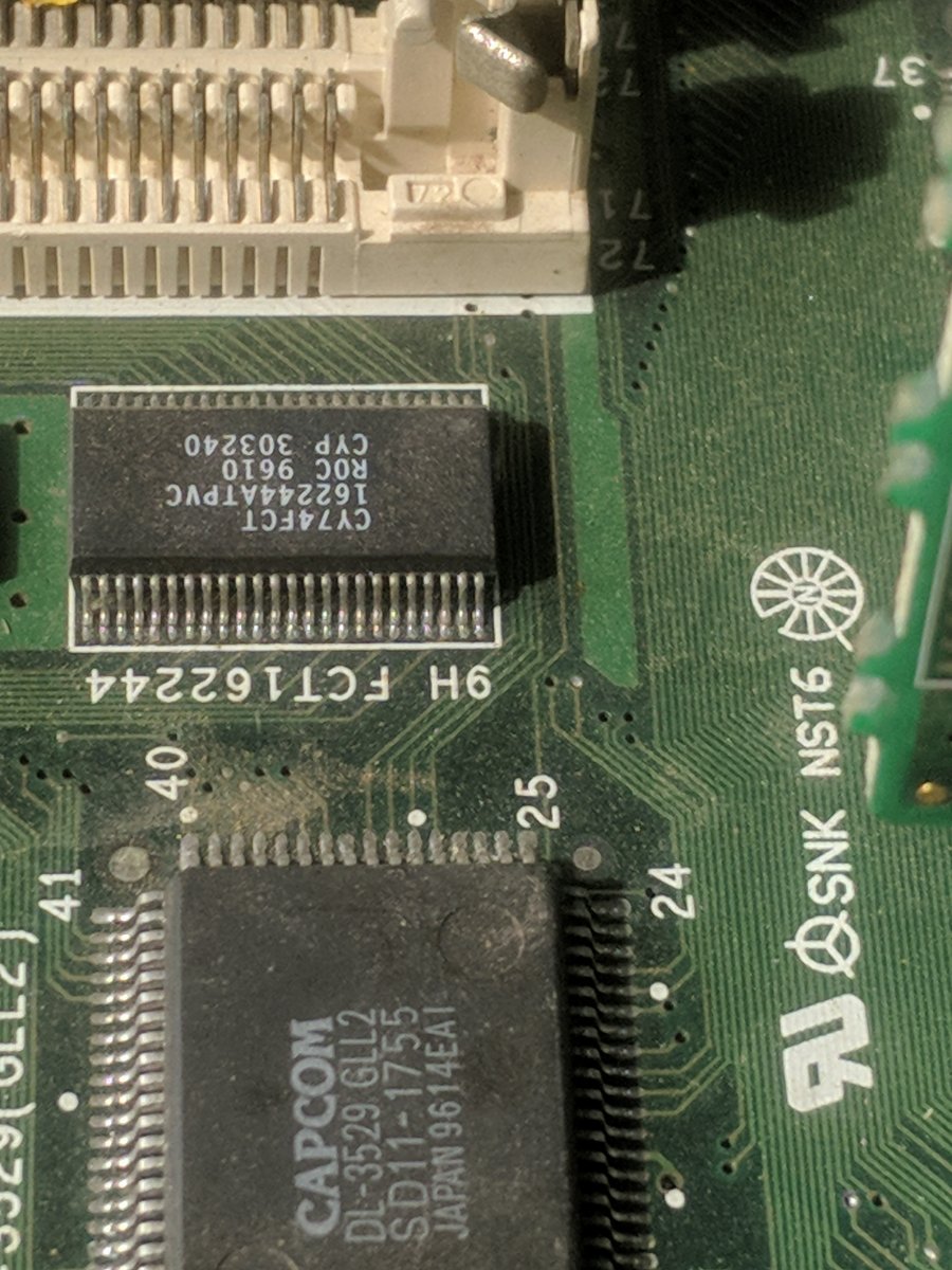

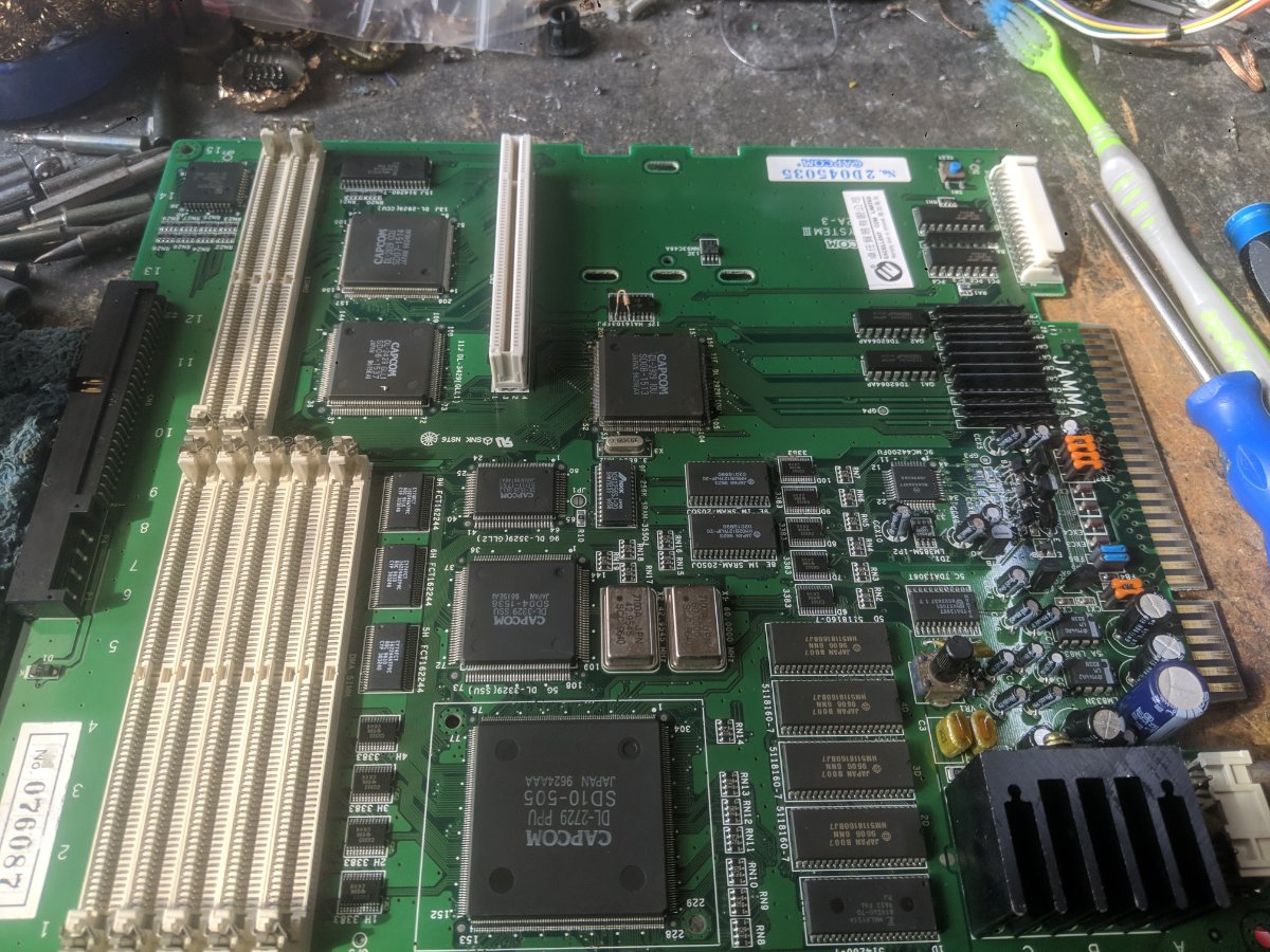

I purchased a CPS3 with 3rd Strike from @TheCrow here on AP a few months back. Now that I've started actually playing it, I noticed that bottons 2&3 both fire at the same time. This problem happens whether you press 2 or 3 by themselves and its happening on both player 1 and 2 controls.
I've followed the harness wire and checked ground all the way back to the jamma edge connector in my astro city but it all looks good.
I've also tested a CPS2 board and there is no issue.

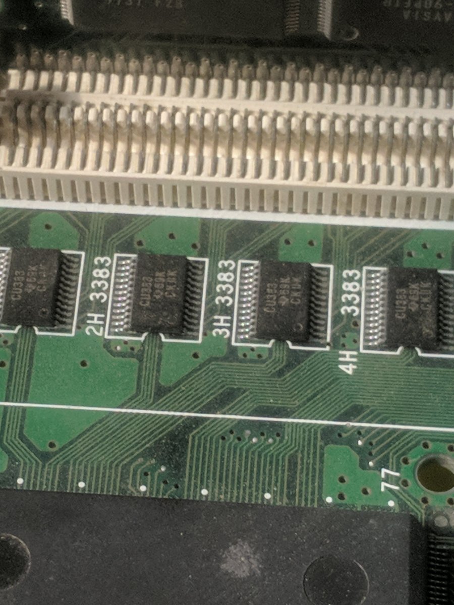

Crow thinks that it may either be one of the arrays or the chips above the arrays. He also mention a possible issue from the custom chip but says its highly unlikely.
I've added images here from my boards array and chips. I hope someone here on AP can help. If someone does CPS3 work here I the States, please let me know or have them chime in 🙏

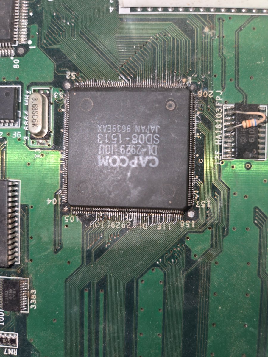

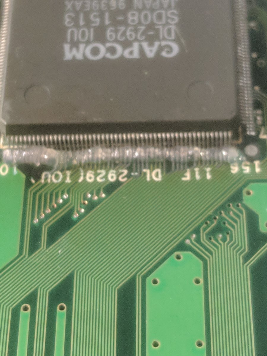

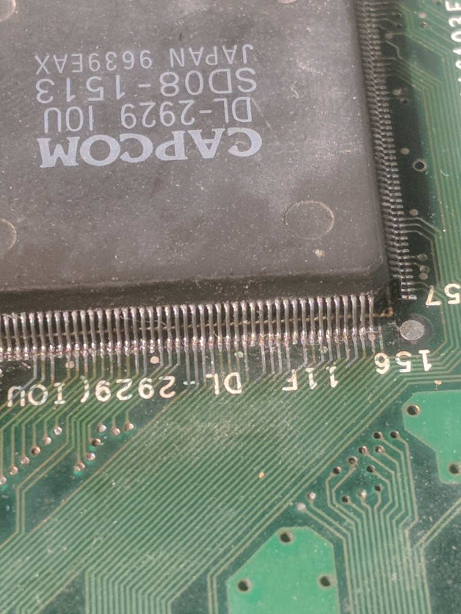

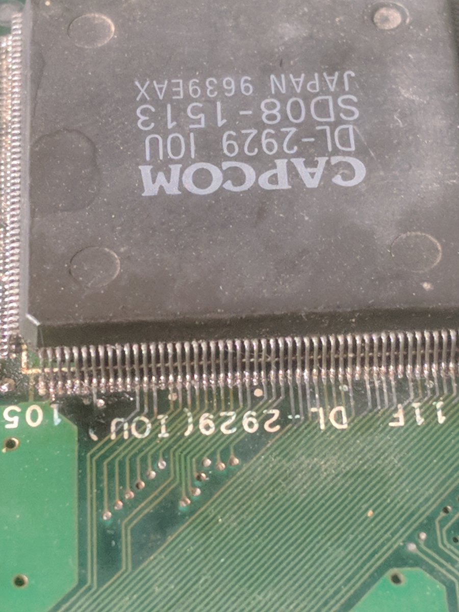

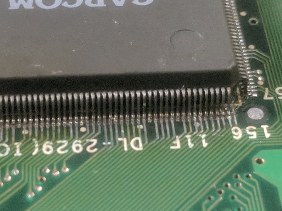

The DL-2929 is known to fail quite frequently (there are multiple threads about it here), so I wouldn't rule that out. Looking at your picture, the 2929 looks to have been reworked. There's burnt flux and what appears to be copper traces with solder run over them. Can you verify all those traces and vias are going where they should?

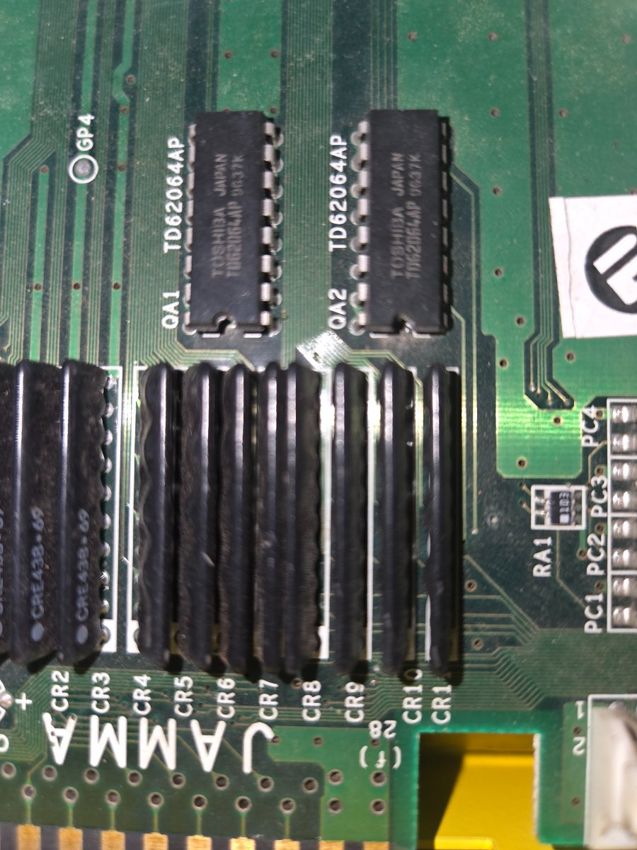

Did you verify the resistor arrays near the JAMMA edge are good?
Thank you for replying with your thoughts kazuo. I have not verified the resistor arrays or the traces yet.
That dl-2929 I have replaced it my self and have tested it , I have posted a thread about fixing the inputs on the cps3 and it’s the same pcb that I fixed on that thread
@TheCrow I looked at the board thinking that I would be able to do a continuity test but that's not happening on that DL-2929 chip lol 😅. I just cleaned up the feet and traces around the chip with a little Isopropyl and q-tips and prayed! No change of course.

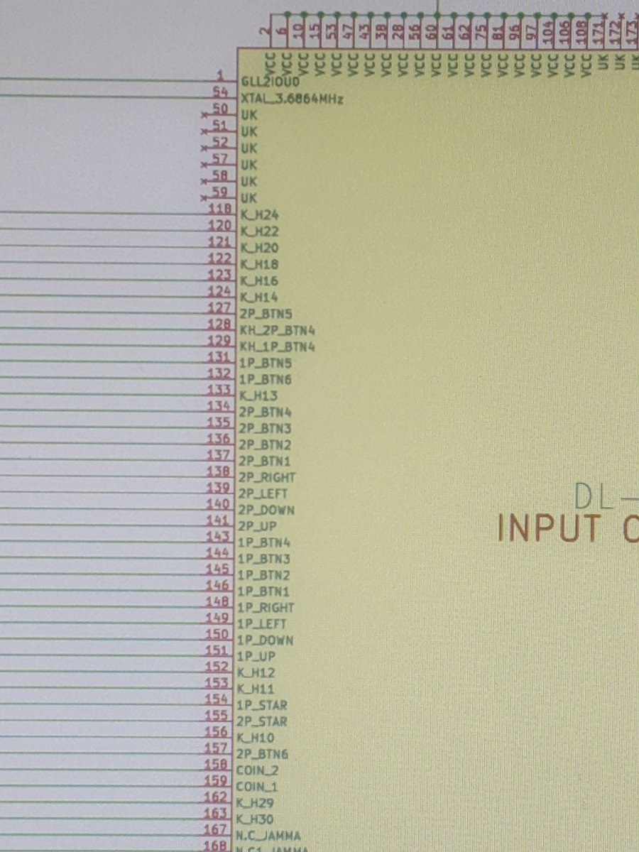

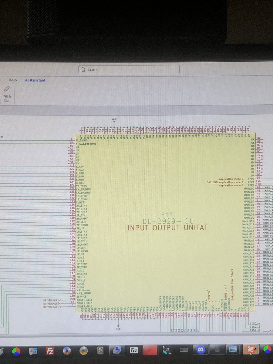

Not sure what tools you have available or your soldering experience, but if you think you can safely remove the resistor array for P1, try that. If they're still shorted, it is probably the custom. Small chance it could also be a solder bridge or something around the custom from the rework. You'd probably need a microscope and a careful eye to find it, or just probe the associated pins. There's a schematic on github: https://github.com/jotego/jtcores/tree/master/cores/cps3/sch

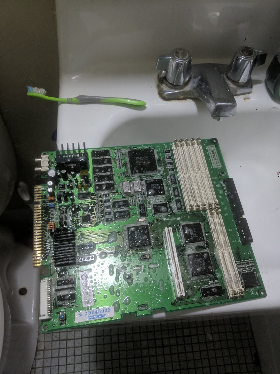

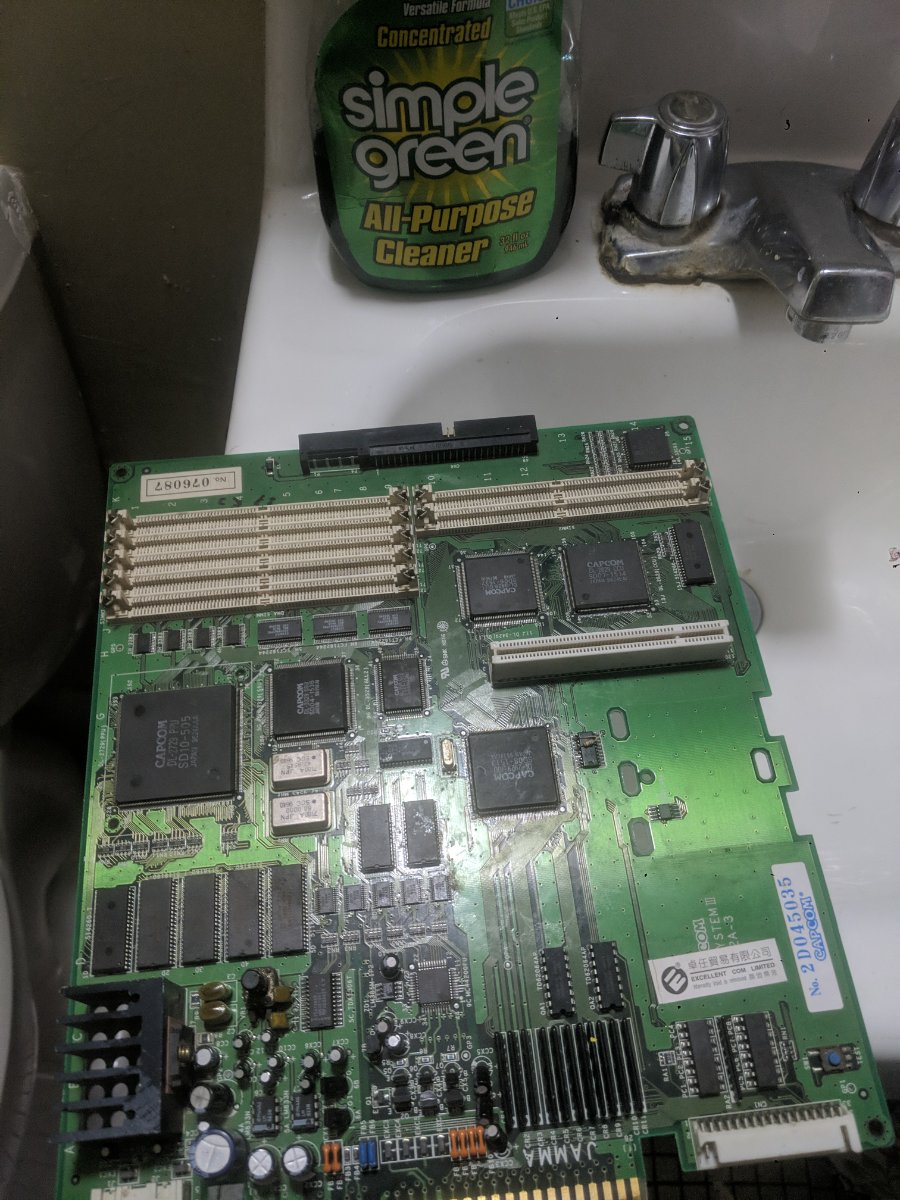

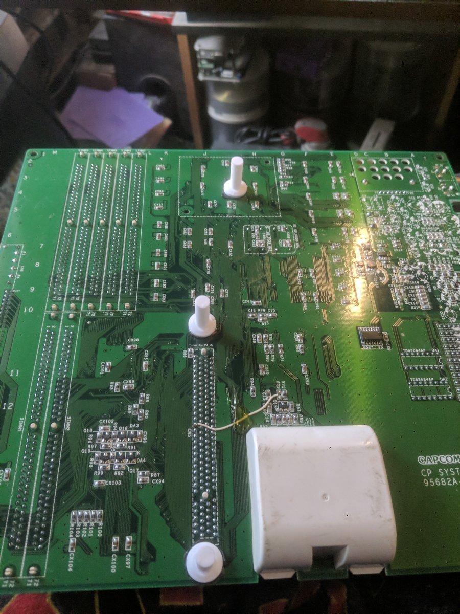

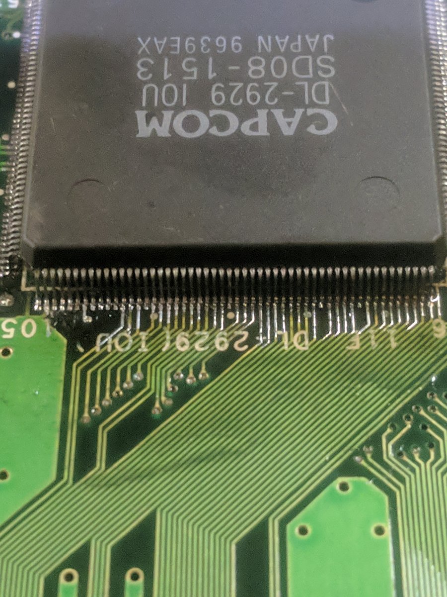

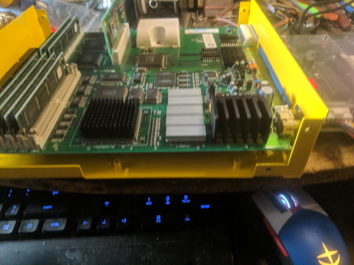

Fixed this one, combination of poor soldering and filthy board. The board had an excellent.com sticker so I assume they are the ones that did the rework on it. The IOU had been very poorly reflowed and had missing pads and sorta all over. The missing pads luckily were no connects, I checked the schematics that jotego made. Also found shorts on 144 and 145 of the IOU that corresponds to player 1 M and H punch. Also shorts on 135 and 136 of the IOU corresponding to player 2 M and H punch. I gave the board a bath with simple green compressed air and hot air to dry. Also reworked the entire IOU to get rid of the shorts. I added support standoffs and a heatsink on the PPU. Tested the board and it's all good now let it run for a few hours to be sure.

Out of curiosity, for the cleaning bit, did you scrub the board with the spray that's behind in the pic? If so, did you rinse it off with IPA or something, or wipe it down?
