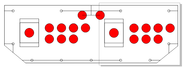

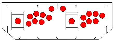

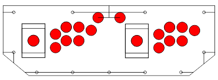

Oh my gosh, that is pretty darn cool. I worked on modifying my little 3p/4p box and instead of buying a fancy switch I just used 6 cheap ones and it was a pain in the ass to solder but I think it works. I spliced into the harness I had which unfortunately made the cps2 connector too short so I made a straight through one which was a pain because it was 48 crimps on 24 wires. Anyway I finally finished the thing and I don’t have it in me to test tonight so I’ll save it for tomorrow. So my solution involves flipping 6 switches to change from 6 button 2p to 3/4p. Hopefully all this crap is wired right, I have been checking as I go but we will see tomorrow. I usually screw up something. I’m still fairly new to doing things like this but I’m enjoying learning and going through the process. This Already makes me want to do a more elegant version 2 with a fancy switch.
The two cables other than the cps2 connector go to my supergun sticks. I wired them 4 button to the jamma and left a little 4 pin connector for the kick harness buttons. Wired neo geo pinout. I have heatshrink ready to go but want to test first before I commit that. I’m using some old usb cables for my 4 wire runs. One is an apple cable that stopped working because Apple is ridiculous and puts stupid logic into their cables for no good reason, other came from a borked x360 fightstick I cut and used a neo geo extension for my supergun. It’s always fun to reuse stuff I would have probably just tossed in the past.
