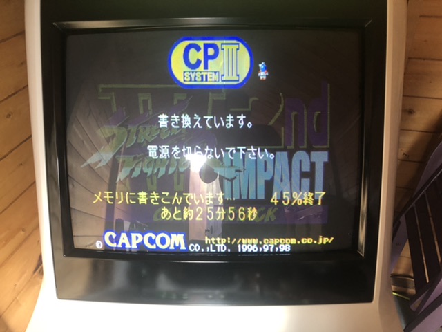

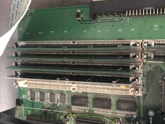

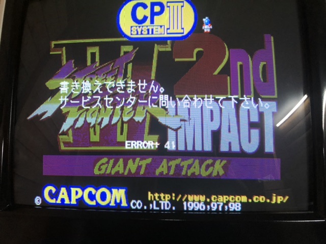

Have a darksoft cart and disk with enough memory, I start the cab holding p1 start button and nothing, and there doesn’t seem to be a way to access it. All the options I have are to write game or cancel. The only game that it wants to write is 2nd impact and once I load it I get a error 41 message. I’ve moved the ram about inspected it and nothing still the same error. Is it usually for the language to be jap rather than English. Any help would be great thanks.

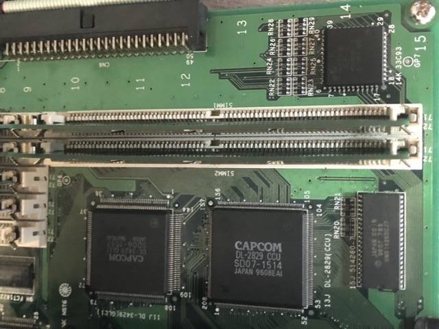

I don't think you have a darksoft cart, at least not one of the newer revision. it normally say push 1p to darksoft menu in the bottom right corner. As for error 41 you have a bad/dirty simm in the 4th simm slot or a faulty/dirty slot.

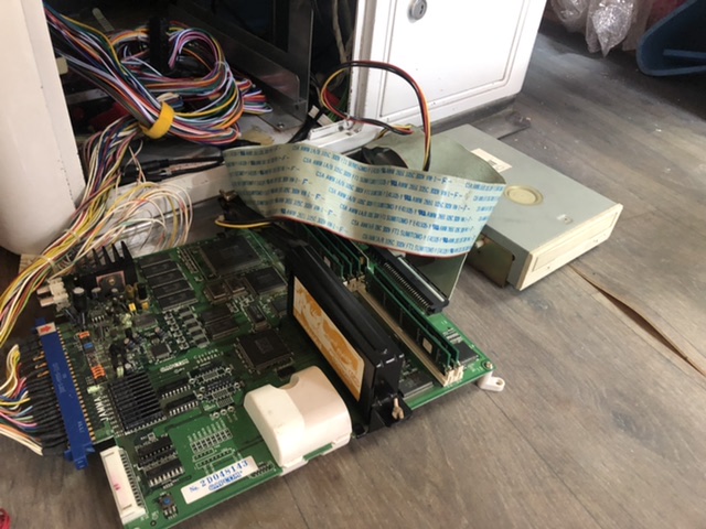

If he doesn’t have a superbios, how is he running 2nd impact with a 3rd strike cart?

Haha this is true. I miss the obvious cart logo. In which case did you press and hold player 1 start then power on cab until the darksoft menue came up?

That is strange. Either your siperbios cart is old/has problem or you have input issue. When you turn on the cps3 do you see the darksoft text in the bottom right before it try to write 2nd Impact?

Cheers bud, no darksoft text at all, I’ve sent back the cart and got money back. I’ve sent a donor cart to darksoft to get bios, hopefully this will sort issue out. The writing of the game was not an issue I had no trouble till it hit 100% then got the error 41 message. So I’m hoping a new cart and bios will work.
