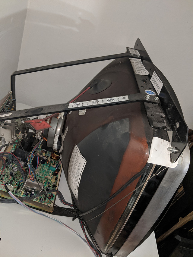

Back with another question: I know it's recommended for the screwdriver alligator clip to be grounded to the metal frame, but I noticed that my frame is coated ant not bare at all. Are there other places on the monitor I can clip onto for safe discharging? I plan on removing the chassis because after inspecting it, it's definitely in need of cleaning.
Personally I place the alligator clip on to the dag wire, the braided metal wire, that is strung from the dog ears and rests on the aquadag coating around the neck.
