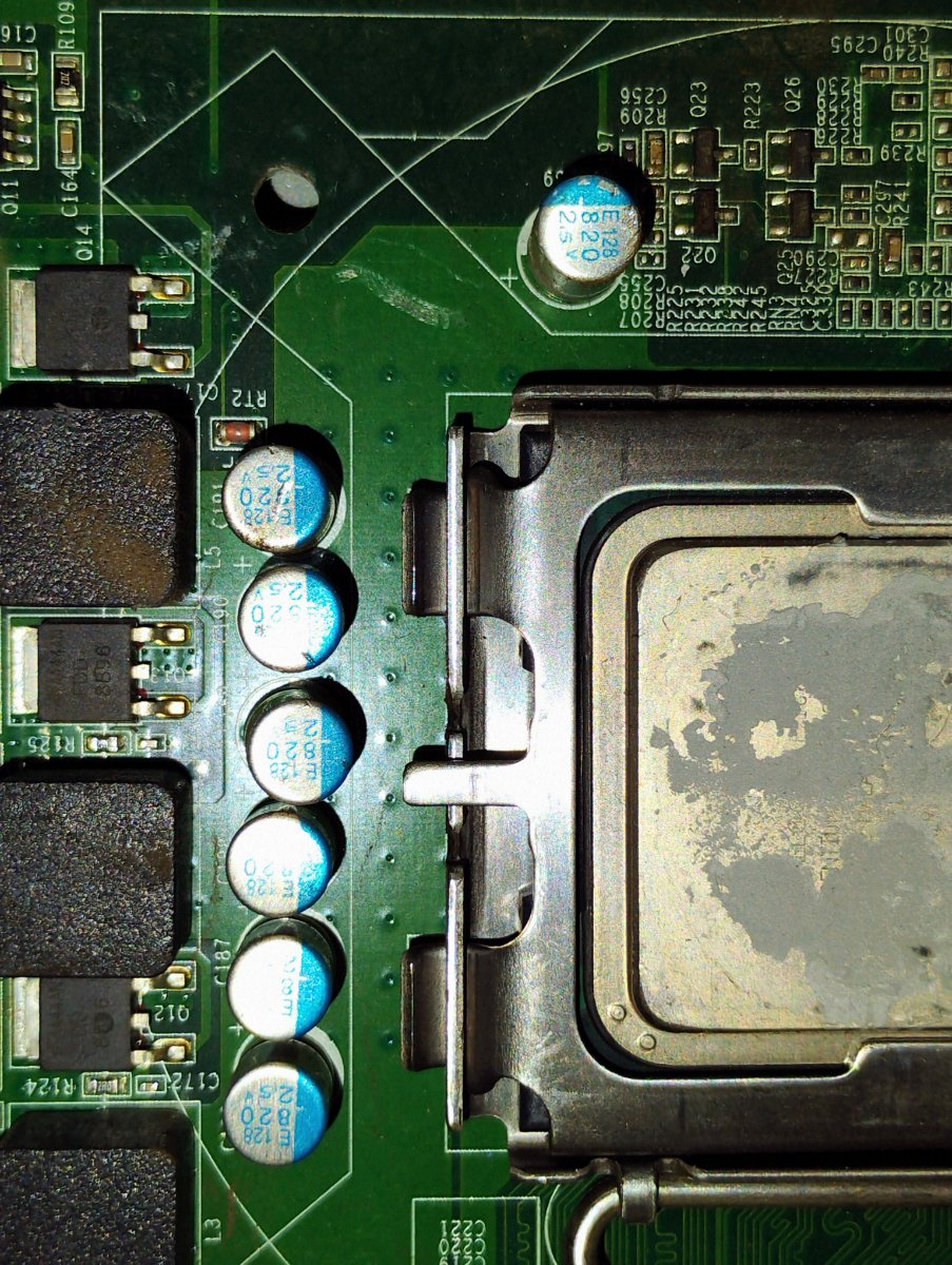

Gonzo Enthusiast Joined Jun 25, 2016 Messages 166 Reaction score 72 Location Puerto Rico May 17, 2025 #1 Where can I buy this. It says E128 820 2.5v. What does the E128 means. Looking it up on Google it says 820uf 2.5v. But I don't know what E128 is. Attachments IMG_20250516_201126019_AE~2.jpg 300.9 KB · Views: 39

nem Immortal Joined May 29, 2016 Messages 7,670 Reaction score 8,368 Location Finland May 17, 2025 #2 E128 is just the series and or batch code for the capacitor. I would replace it with any brand name aluminum polymer cap, like this Panasonic one: https://www.digikey.com/en/products/detail/panasonic-electronic-components/2SEPC820MW/4204174
