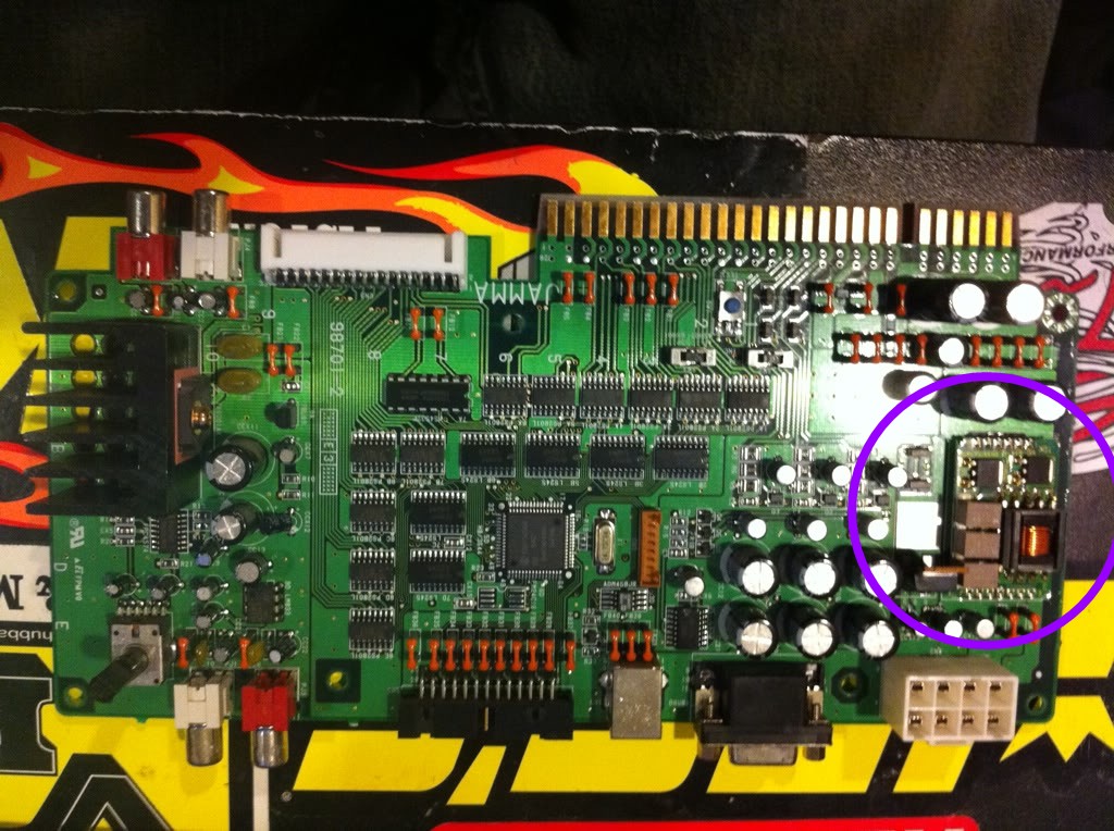

Has anyone tried to mod the capcom i/o to supply the necessary power for the naomi, netdimm, etc?

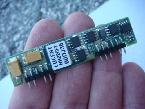

I know it has a mini DC to DC converter board soldered to it. Most likely used as a stepdown to supply 3.3V, maybe that circuit could be replaced/improved to provide the necessary power to boot up the naomi with all needed accessories??
Found a pic of a capcom I/O pcb and highlighted the section I am speaking of:
Out of box thinking. Me likes. More amps channeling through the Capcom I/O please!

But all that is needed to be done is to replace the oem dc to dc converter as pictured/highlighted on the first post.

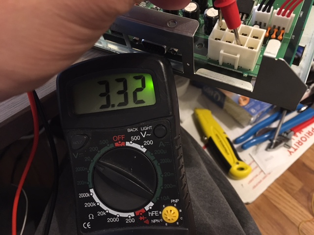

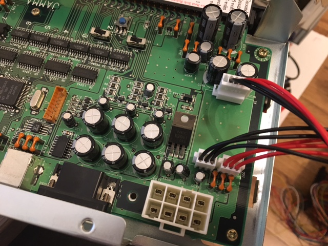

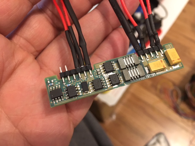

Upgrading another io, running tests on a new sip packaged dc-to-dc converter.
Solid output on the 3.3v line, stayed between 3.31-3.32v even while I adjusted the 5v line. Runs very cool thus far, will put it through a torture test this weekend to see how it handles.
Not the cleanest install, but all works as it should.

It worked out fine, but a custom built dc to dc converter to replace the stock one would be better suited than off the shelf parts. I used the bigger converters with heatsinks with better success, tight fit.
