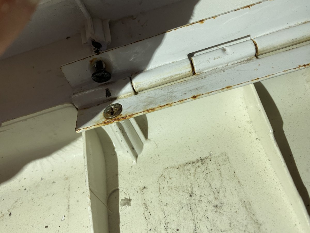

So I grabbed an Impress a while back that came with a very messed up control panel, the screw housing on the panel side were broken and the previous owner used sprayfoam and wood screws to make it "work". I've since acquired a new panel in decent shape and I'm looking to replace it but after digging through the manual I was able to find some of the screws I'm missing but the panel hinge screws weren't listed. Any impress owners or aficionado's able to help me out here?

I have a new panel to install so I'm not worried if the old one has stripped out holes. I looked at the manual on arcade otaku and I found info on pretty much all the other screws using the picture references but didn't see one for that part and I don't read Japanese. If I did over look it please let me know where it was so I can kick myself :)
Turns out I am retard and they are not listed. Every other fastener on this machine is an M4, so I think this is what you are after:
https://www.ebay.com/itm/193624335161
Depth is somewhere between 8 and 12mm. I will try and pull on out of machine later and measure, but you should be able to get a sense of length based on 3/4 of the depth of the fastener post.
