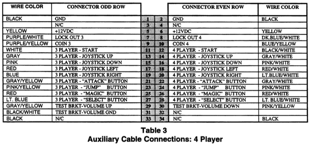

Okay, I figured out how to set it to four players but doing a test run, I noticed that all the 3P and 4P controls are messed up, like all the directions are switched or one of them is an attack button and so forth. The Capcom IO is set to 4 players. Any advice or suggestions would be great.
The Capcom I/O seems to use a reversed 3P/4P pinout v.s a normal CPS2 3P/4P, if this is to be believed:
https://solvalou.com/arcade/naomi
Compare with CPS2:
So are my buttons messed up because my 3P/4P kickharness is wired for CPS2 and not for Naomi/Capcom IO?

Do not under any circumstances use the pinouts on that site. It IS the same as CPS2, I have emailed him but he does not respond. Wasted a day of my time and judging by the existence of this thread probably several other people's : (
He's also dead wrong about powerstone2, it works fine in 4 player with 2 properly chained JVS IOs.
