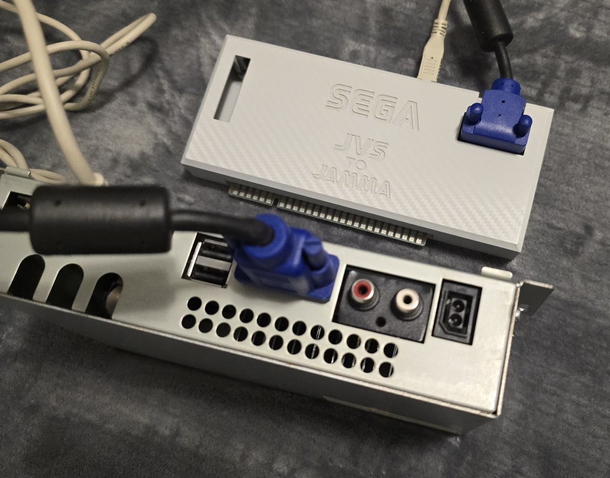

tengugurl Enthusiast Joined Feb 25, 2020 Messages 131 Reaction score 27 Location Denver Colorado Today at 2:55 AM #1 Hi! I have a blast city and I am new to the JVS IO world. Would this jvs adapter work for a tatsunoko vs capcom pcb? Sorry super new to this Attachments IMG_6778.png 610.4 KB · Views: 9
msamiullah Professional Joined Aug 22, 2018 Messages 301 Reaction score 224 Location Canada Today at 3:22 AM #2 yes this should work fine, I use the same with my TvS board as well. I am not sure about wiring on Blast city but with JP1 jumper set to B, 5 buttons per player come from JAMMA connector. *EDIT: Something like this: Last edited: Today at 4:37 AM
