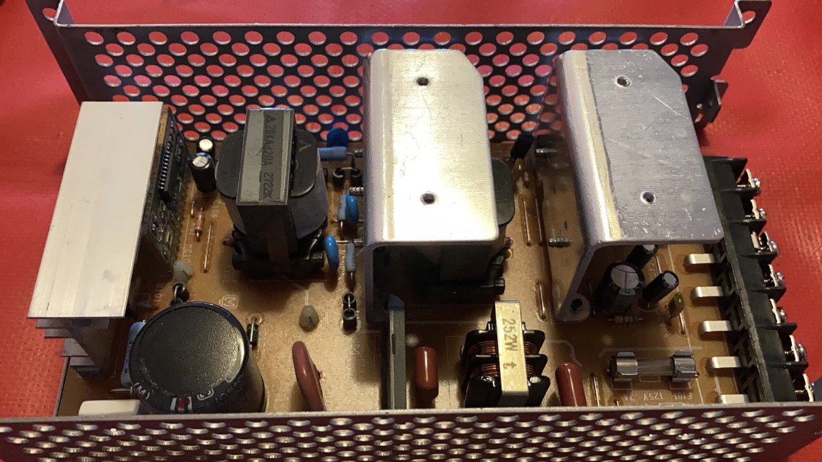

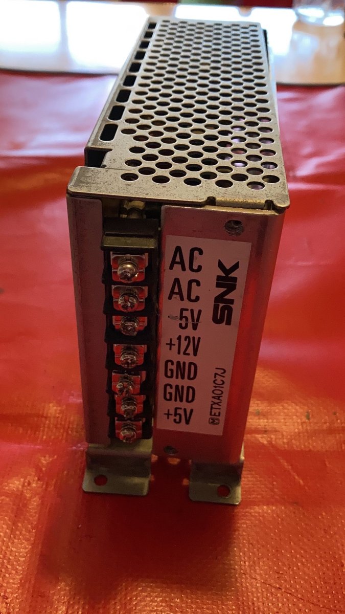

BuddyC Enlightened Joined Sep 17, 2018 Messages 936 Reaction score 3,190 Location Oslo, Norway Aug 9, 2022 #1 Not a lot of info I could find regarding the stock PSU of SNK MVS25UP-0, so I made a capkit for it. My caps looked original, but always smart to double check your PSU just in case LocationuFVoltDiameterC105 (Filter)470 uF180V25 mmC107 4,7 uF50V5 mmC10622 uF35V4 mm C301 100 uF25V6 mmC20510 uF50V5 mm C206 100 uF10V5 mmC40222 uF50V5 mm C401 470 uF16V10 mmC40322 uF50V5 mm C201 820 uF10V12 mm
