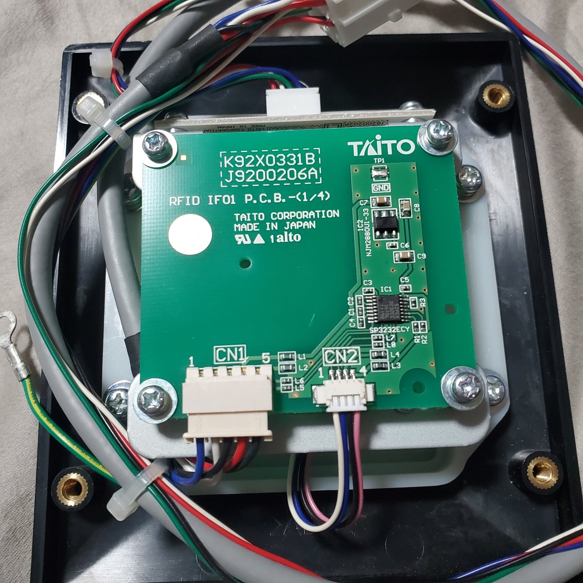

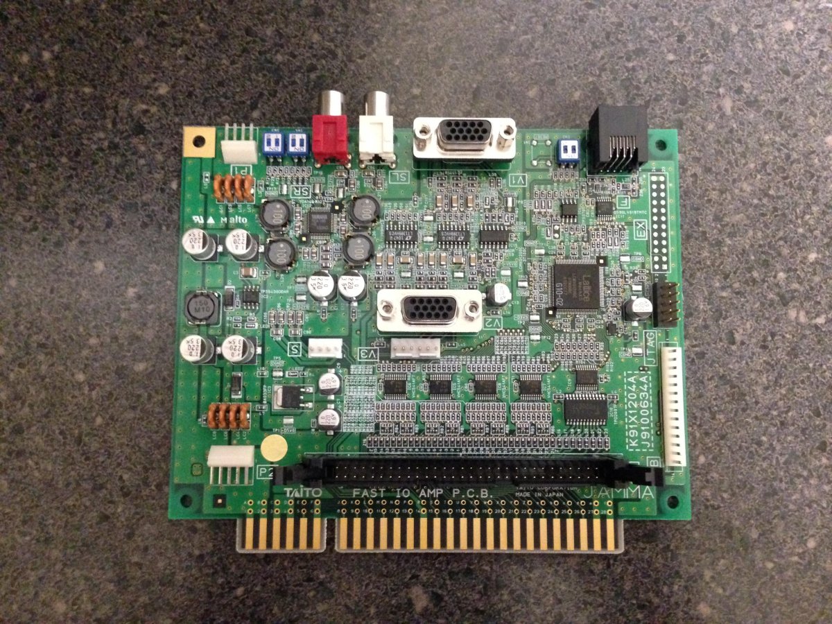

Seems tonight I'm taking over the Taito thread, I read that someone fixed random restarts on their X2 multi by hooking up their card reader to the fast IO so it wouldn't need to be emulated.
Pictured is the nesica reader I have and the Fast IO I'm using. How do I hook up the reader to the Fast IO? Thanks!

That reader looks like the usb version- to be used with usb io not fast io
The rfid reader you want is jvs version- usb connects to ttx3 and is powered by connecting to fast io
Fast io connects to ttx3 via ethernet and powered via cab
