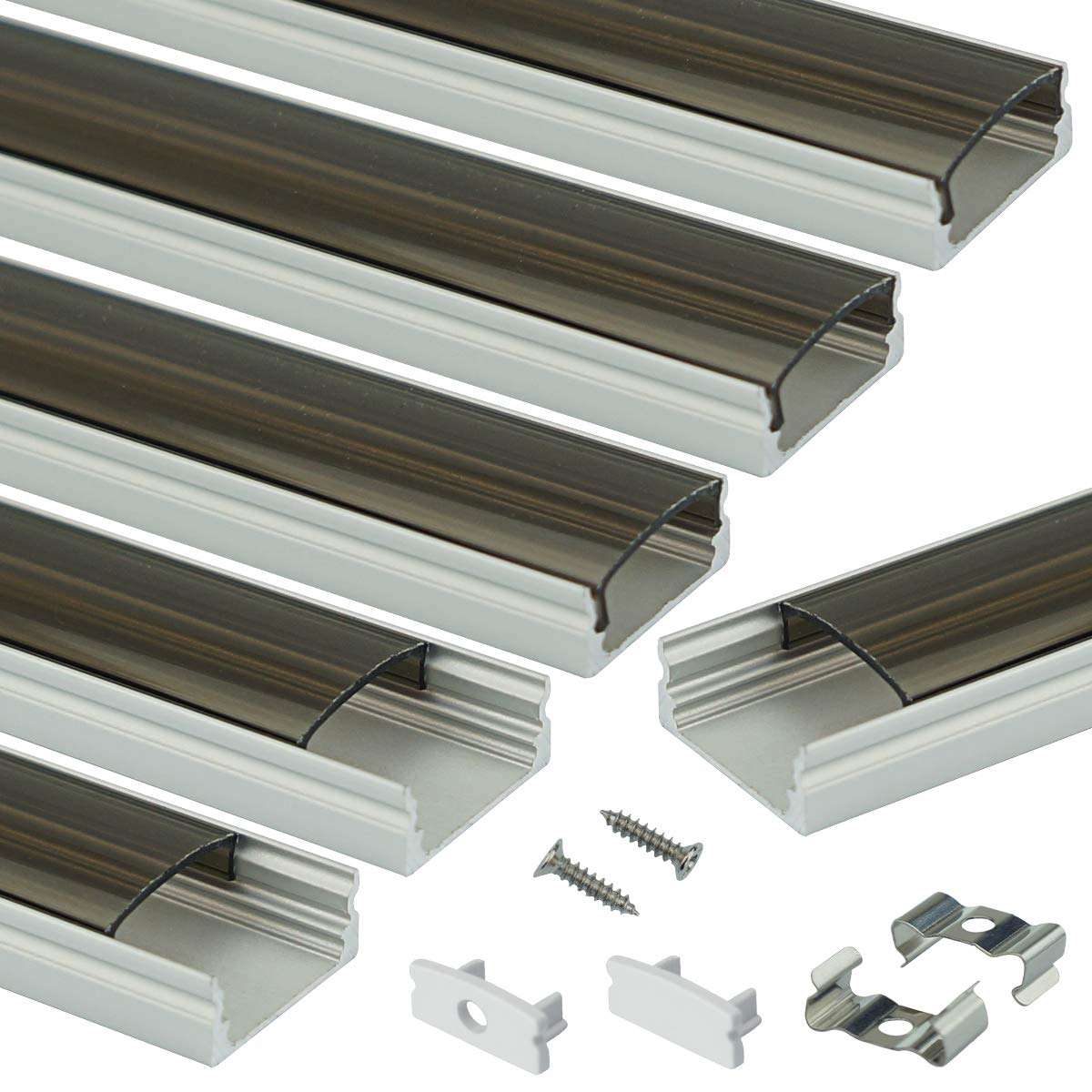

https://www.amazon.com/dp/B07KC8KLNS/ref=sspa_dk_detail_7?psc=1&pd_rd_i=B07KC8KLNS
These are led strip light diffusers and such. Its just an example. I dont know if the smoked diffuser will passthru IR signals, so you might have to drill a for that. Also you need to see how deep the u channel is so it can accommodate the IR boards and wiring. But Im sure you are accounting for all that. THere are many options to buy these so check around for what fits your needs best, good luck and let us know how you make out :)
