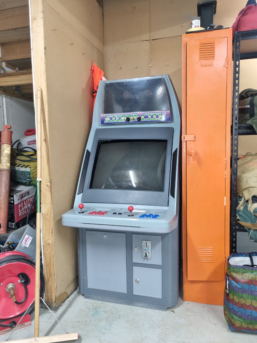

I am in the process of collecting a number of Candy Cabs for an Arcade Bar/Barcade in Melbourne. In the process I have been offered a number of Chinese Storm City cabs all of which I have offered something so low that the owners have left feeling insulted.... Sorry.
Well I was asked to look at a poor picture on a Blast City cab the other day. The guy was pretty close to my factory (day job depot) so I asked him to bring it by and leave it there for a few days while I took a look.
I got in after it was dropped off and what greeted me was a bit of a surprise. It was a Chinese Storm City with a poorly wired pi mame emulation setup. The thing had a 29" Fortune Chinese tube with a Generic Chinese CRT TV chassis and the pi was coming in via the RF aerial plug (remember that from your NES). Needless to say it looked like Shheeeeet.
I quoted him for the cheap option, an RGB mod of the existing chassis and the expensive option a fully rebuilt Chinese " New" Arcade chassis. He thought both were too expensive and didn't want it back like it was no I ended up with a free Storm City, probably about their right value.
Not wanting to be wasteful, I thought I better restore this cab and set it up as a vertical shooter with a PGM and a spare SPI board (I think I have somewhere), for my field staff.
I thought this would be an interesting project to share as it will demonstrate why NOT to pay money for these things while showing off just about every cab restoration technique I know and probably many I don't yet know but soon will.
And YES it is grey as a result of some MF who thought they knew how to use a spray can but really had no idea.

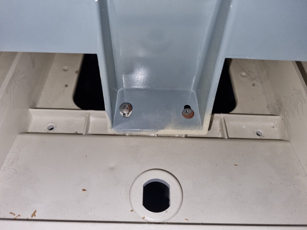

As mentioned earlier 2 of the 6 posts on the bottom CP hing are F'ed and disassembley for painting revealed a MF horror show.
The first thing here is that the Ugandan plastic is literally the worst anywhere. The MF snaps and the owner decides that they can live without that screw. The problem here is that this MF is designed to some real precise engineering and one screw missing sets off a chain reaction that leaves no screw posts left at all.

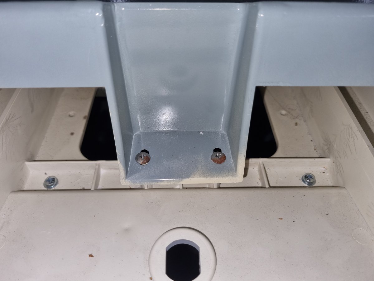

When I first rolled this thing in I noticed the CP was wobbly. I assumed that plastic was broken but luckily I was totally wrong and either they came from the factory missing 1/2 the screws or some MF was too lazy to put them back after they used a grey spray can with their eyes closed. Either way, once the missing screws went back things felt a tiny bit more stable. I may actually be able to remove the monitor now (despite the fact I have noticed that 2 of the 3 screws holding the monitor support in each side are missing, but that is a problem for another day.
First photo, no machine screws, second photo screws added (this x4 across the bottomof the CP); 3rd photo 4 more screws that were missing replaced (x2 as this was on both sides).
I am still trying to work out if this I'd a factory game of find the screw posts if you want your cab to not disintegrate or if the PO was actually blind and I should stop being so hard on his paint job.

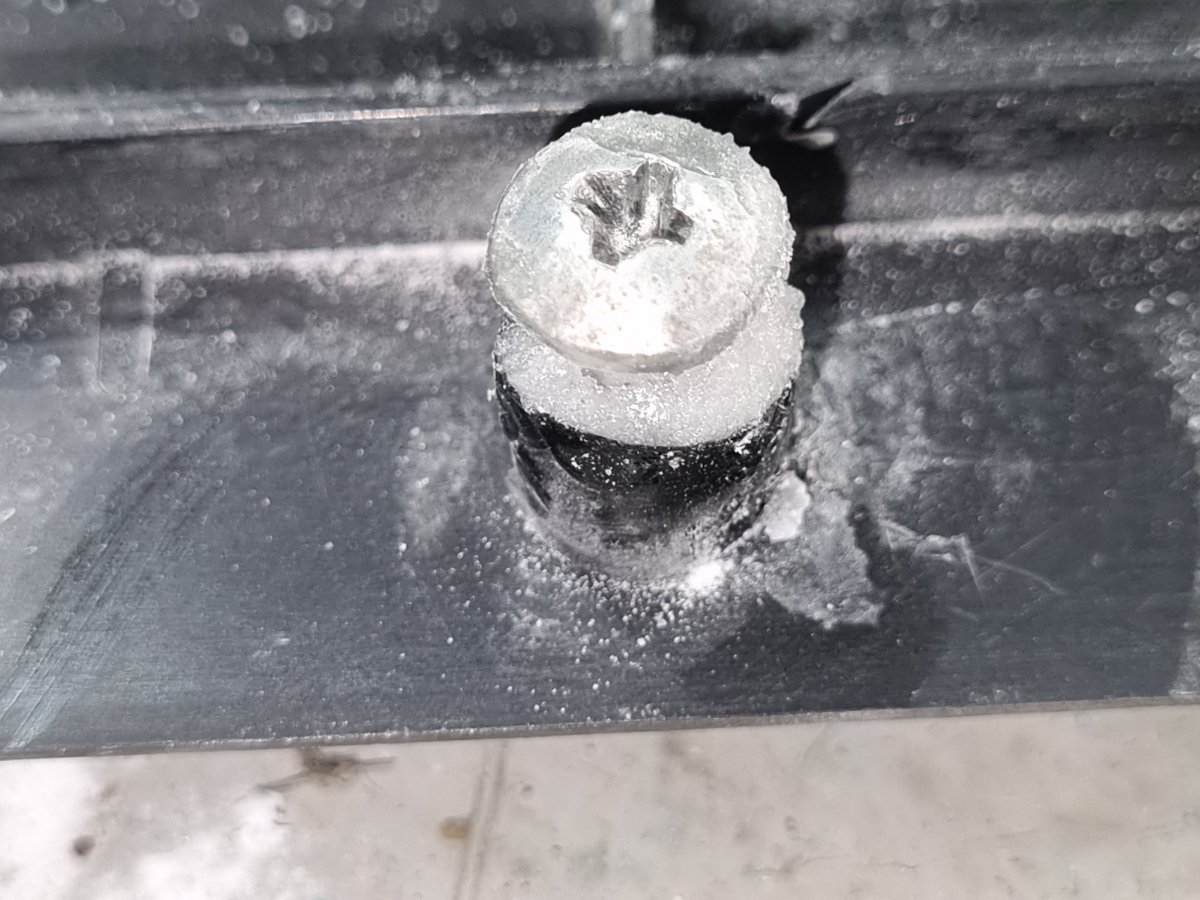

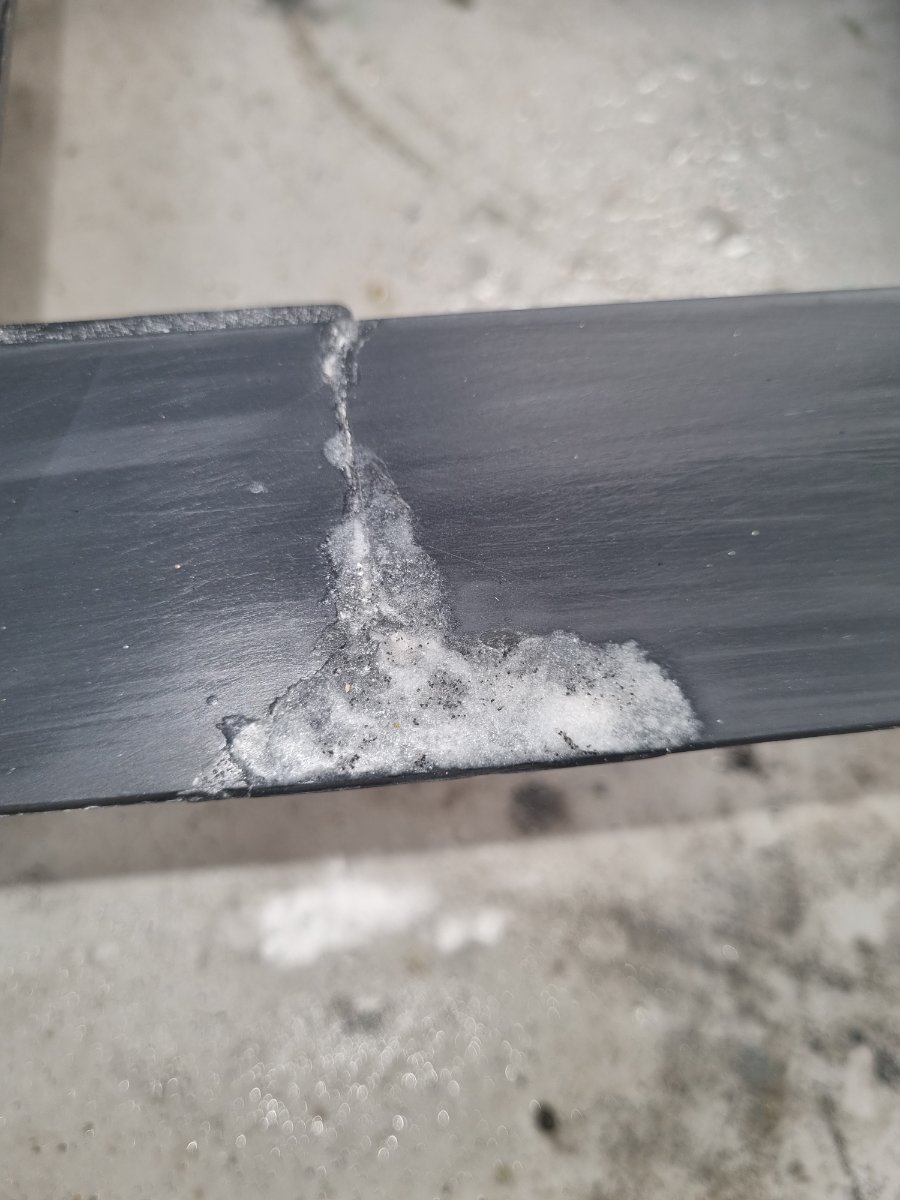

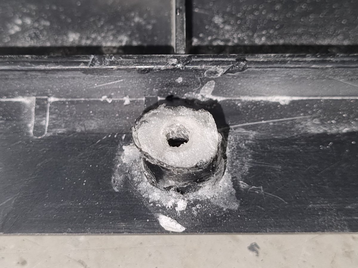

So what do you do when a plastic post breaks? Fix that MF. Not all places can be fixed the same way and I am still thinking about the CP., but when it came the back of the cab it was time to get the plastic repair kit out (just don't let you wife or girlfriend know you stole the Baking Soda).
P1: Snapped post 4 of the 10 back posts were Snapped . Its plastic if you tighten that MF up its going to break, any resistance stop.
P2: Wrapped and ready.
P3: Screw in place (don't use the screw you actually want to put back but make sure it's the same size). Also cover the gap at bottom of the tape with a baking Soda skirt. If you don't do this you will end up with CA everywhere. Make sure you are using a thinner than water CA so you fully saturate the baking Soda, anything thicker won't work and your post will crumble.
4. Progressively fill the tape with CA and baking Soda. Keep you fingers away as the baking Soda acts as a catalyst, gets MF hot and sticks stuff instantly.
P5: When you are happy remove the screw. .Too much CA and the MF leaks everywhere, too much baking Soda and it disintegrates, goldie locks that sheet.
P6: testing with the correct screw
P6: original post as an example.
Edit: the photos are out of order.

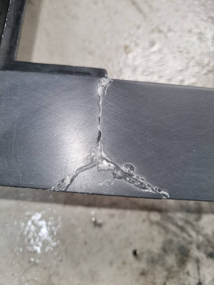

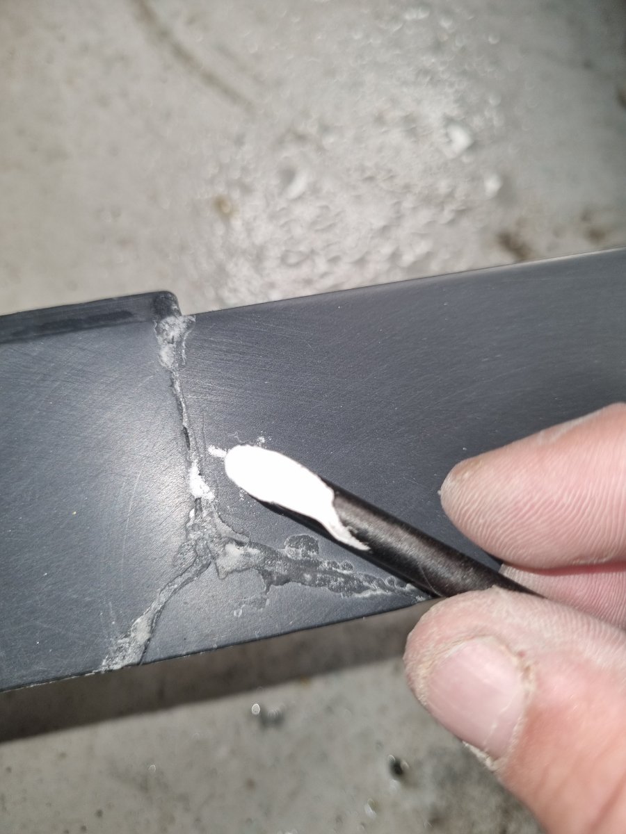

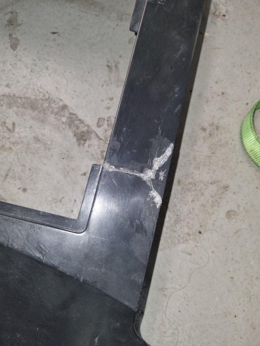

2.2 CRACKING UP
Same deal with cracks and breaks. Remome any previous poor attempt to fix the MF. Use a thin CA, glue the crack and fill any holes with baking Soda and CA. If I think is going to break again I sometimes build up a bit of material behind the crack also, It's on the back and won't be seen. Sand the front until it is smooth and ready for paint. 600 grit is what I find best for plastic.

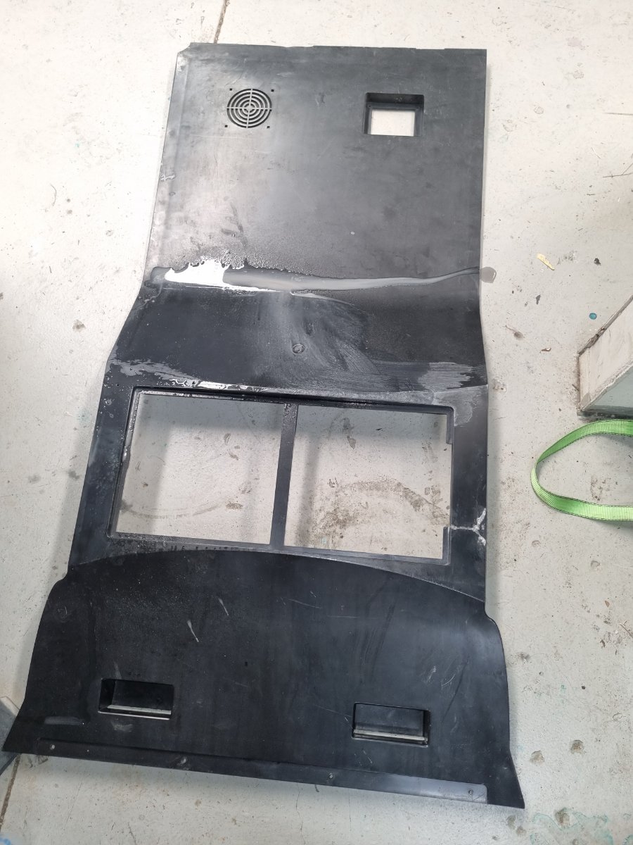

2.3 THE GOOD, THE BAD AND THE UGLY

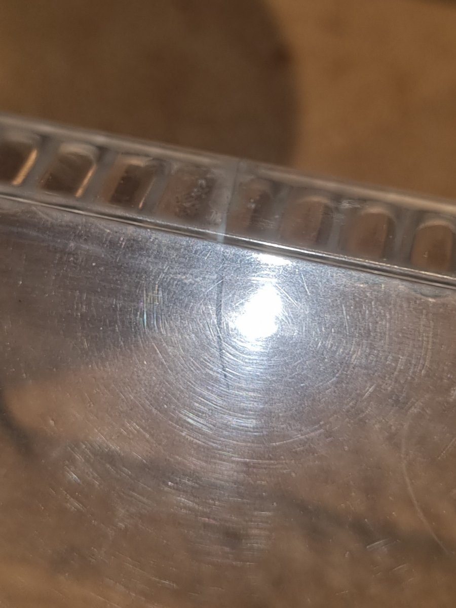

Sometimes aiming for perfect can destroy the good. Removing the marquee plastic revealed another small crack. In this instance anything we do to the marquee area will look silly. It is important however that the crack dosen't spread. Finding a new marquee for a Chandy is likely near impossible (another downside of a copy cab when compared to a real Candy). In this instance the crack will be barely visible once a marquee is installed so we will CA the top of the marquee where it is not visible to keep the crack stable and move on. For minimum visible impact we will use thinner than water CA, placing a small amount on the crack while letting capillary action draw it into the crack.
While I am here I will remove the Storm City (unlike a blast where I would do anything to keep it I don't want this cab to shout Chandy at everyone as it may get a complex). Also which MF put those buttons there? and WTF is that lock for? as there is nothing to lock too. I have a plan for the buttons but the lock throws me... another problem for another day.

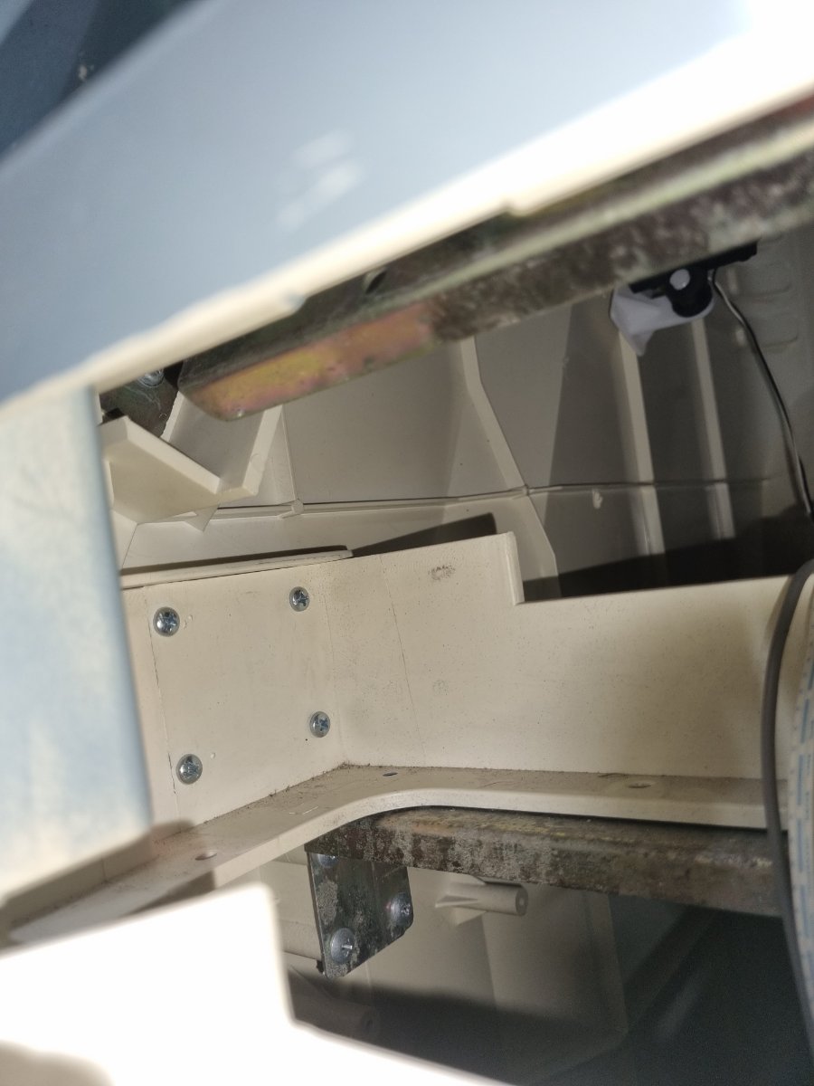

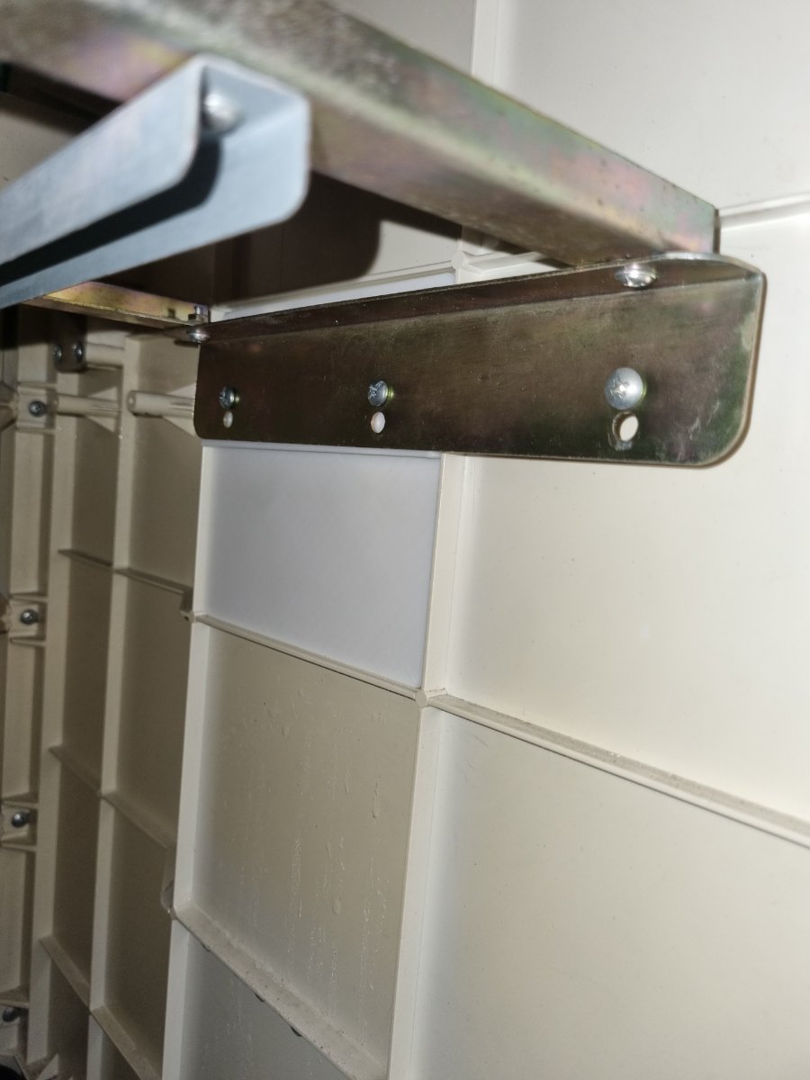

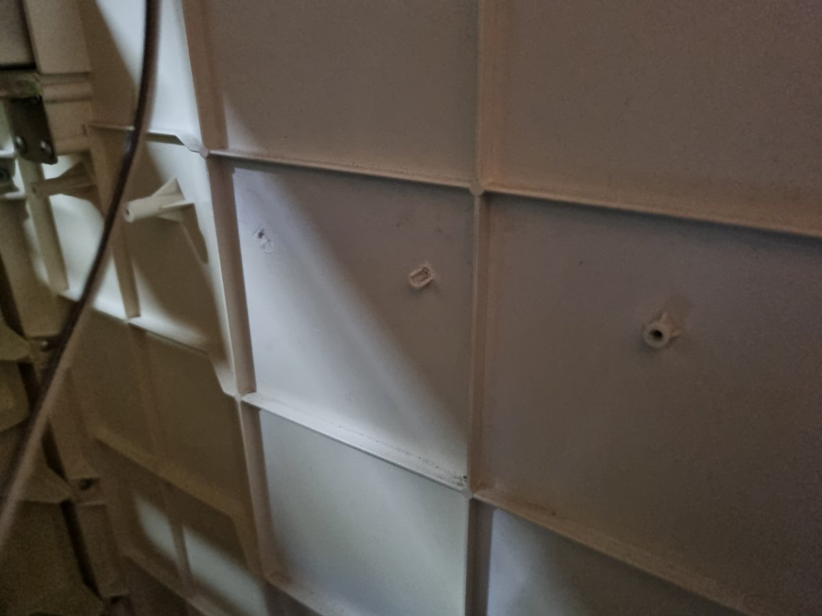

Umm this shelf feels a little unstable... I wonder why?
Man this MF really had problems with getting screw tension right. I'll be kind I think he really did think this thing was a blast city. For everyone else, if all the screws are there you have to put hardly any tension on them at all, even slightly too much and the specially made Ugandan ZZZ plastic breaks.

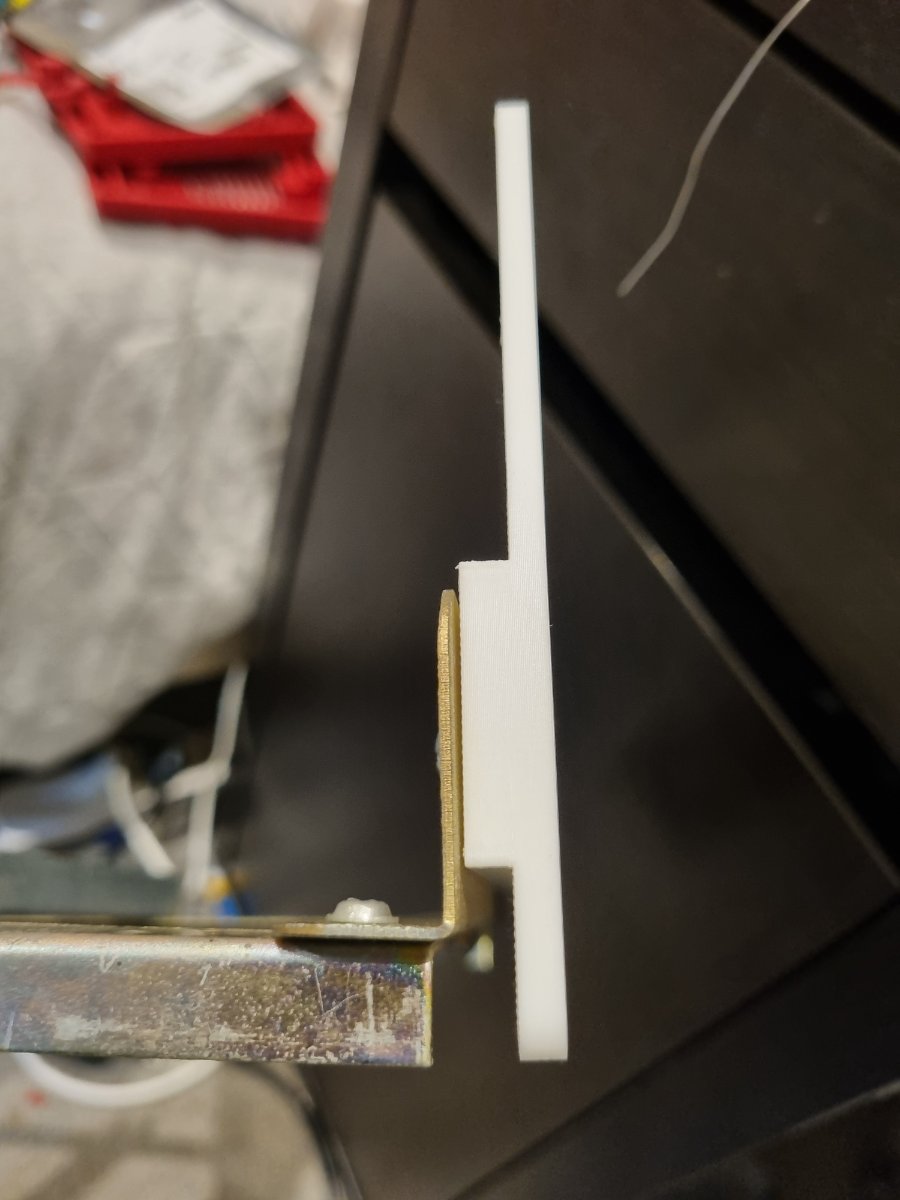

I need to think about how to fix these now.. .

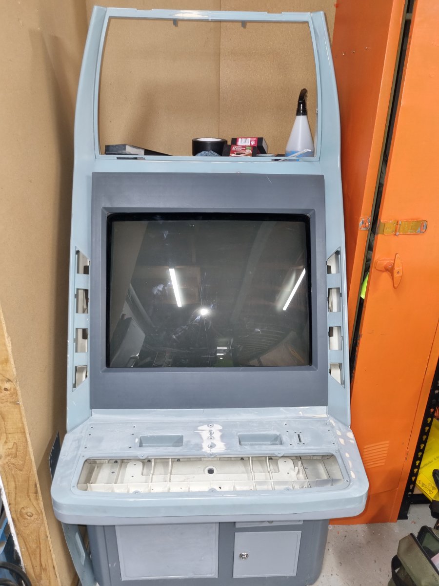

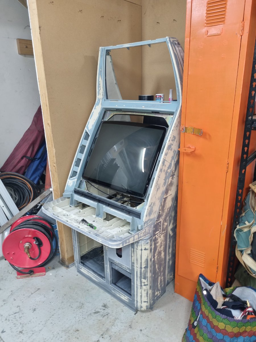

2.5 SANDY BEACH

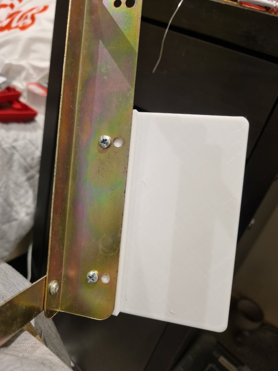

First off.... Shelf posts all fixed. No glue, just pressure fit.
Second off.... if you are not spending at least a day sanding and preparing for paint...you are not doing it right. Not much to say here just sand that MF baby. 80 grit wet and dry with water, one done 120, then 240, pull everything off, get into everywhere.

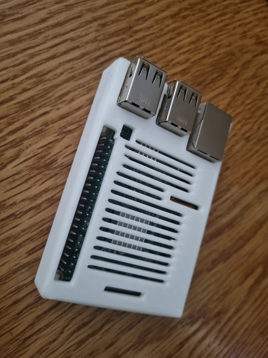

I want through the pile of junk that came out of the cab. I noticed that it was running a pi 3b. I had a case printed up so quick that I didn't even have time to change filiment and installed the latest WIPI netboot on the 32gb SanDisk that was kindly left in it Now I just have to confirm the trace repair on the netdimm and test that the TD-IO I put together is fully functional.

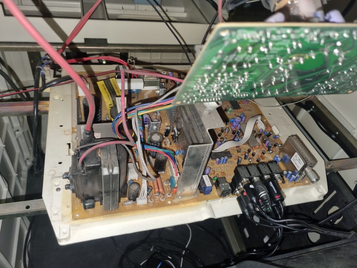

So the cab is preped ready for paint with a few other bits and bobs ordered. However we have this chassis monitor problem. It looks to me like a 29" TV has been used to replace a broken or lost monitor. I gave the PO 2 options, an rgb mod of the existing TV chassis with no rgbs inputs or an ali chassis. What would I do... first try getting the signal in via another TV input... that looks crap too... in fact this whole tv thing looks crap...ok I guess we go an Aliexpress chassis.
Starting at the power side there is quite a bit that needs replacing in on of these to get them to function semi reliably. It starts looking like this.
