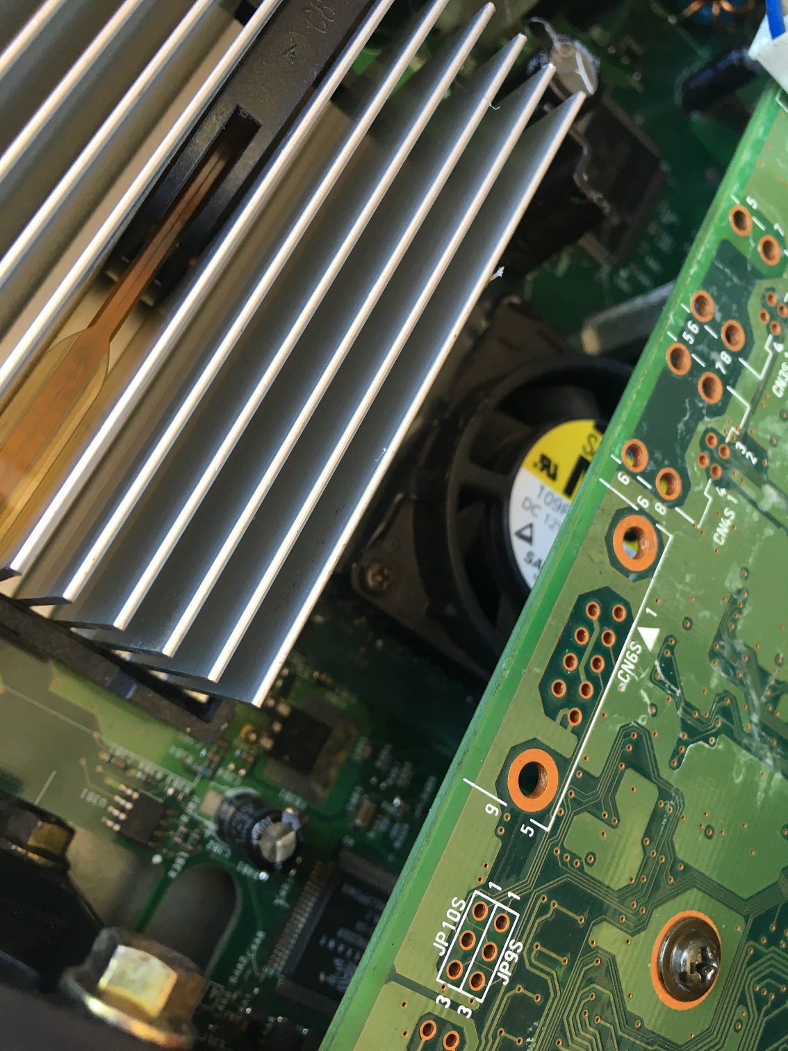

Since the original heatsink/fan is complete trash and is the cause of death of the Chihiro, I give you a mod that I came up with along with Ken. I found a whole bunch of the Naomi heatsink/fans, but in 12v form, so I thought why not use them since the header on here is 12v. You snip off the plastic around the GPU area, clean it up, put thermal adhesive on it, surround it with hot glue just for extra support and bingo!
is this better/worse/equivalent to using the upgraded heat-sync found on later model Xbox consoles?
