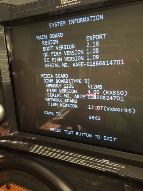

I am using image from here. I have export FW according to system information and using export region game. Although I did notice that when I go to system information I can not get to change the region no matter how many times I press the service button. I get the game code to pop up but never the region select.
Are you using the latest firmware that is the sticky on the forum? Your firmware version should be 4.00.
This is also PIC related. You need a working PIC for region change.
