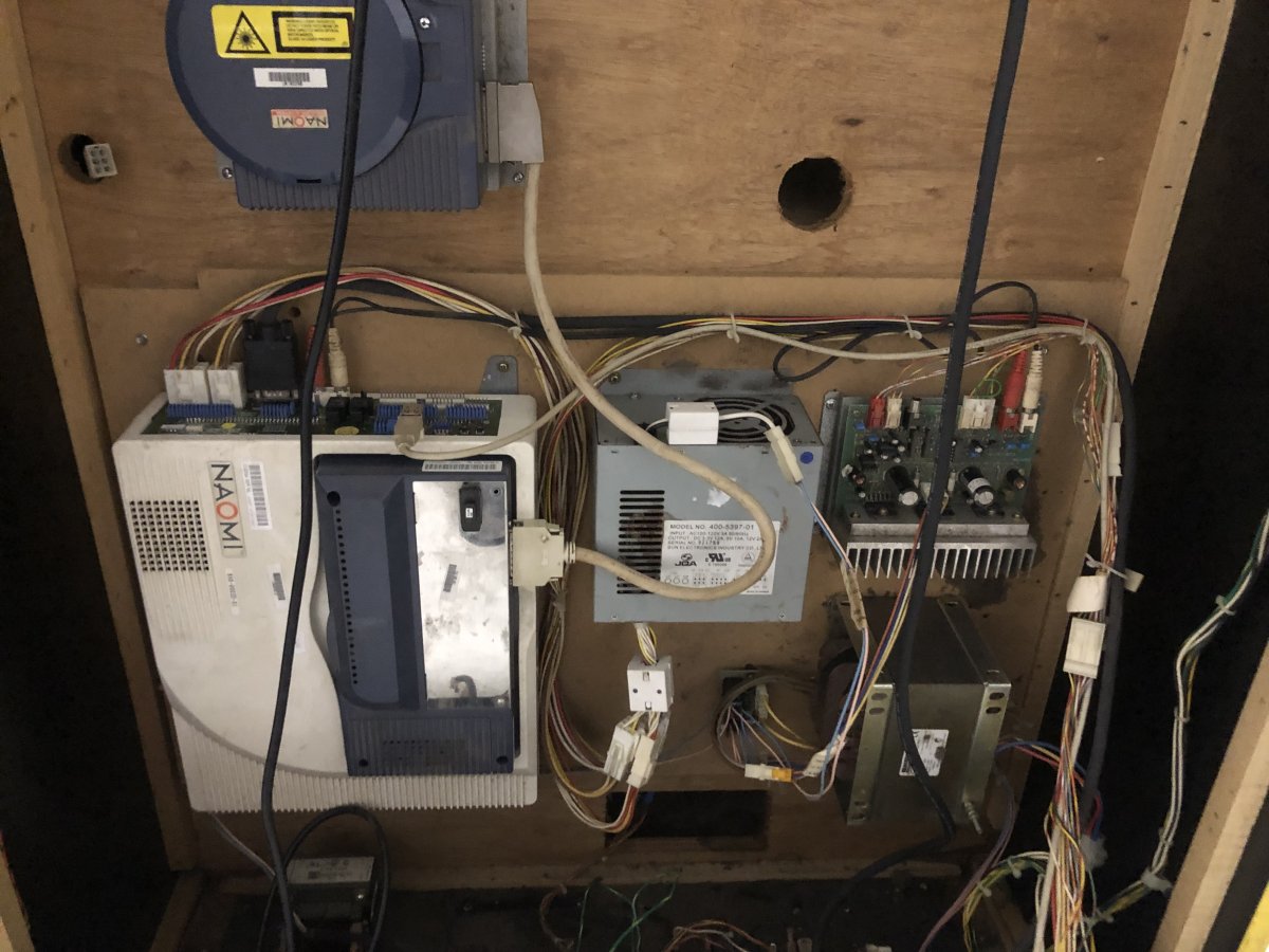

Below was the setup in this cab that a lot of things just didn’t make sense in this cab, I bought pretty much all the guts out of a l other High Roller.
Above picture shows a Naomi, not a Chihiro, so it must have been running a different game. Or maybe it wasn't running any game at all? What disc was in the drive?
I have two and both have different numbers
What are the numbers?
I appreciate the reply, and yes I realize the old setup had a Naomi 1 in it, I just wondered if it would have worked in that configuration, I assumed not after research, but I got lucky to buy all the missing hardware for the game off of eBay. I have two GD Discs, both are GDX002B. So I found a list of security key numbers on this site, but none listed for High Roller. I found that the old setup has a Super Major Leauge key in it #253-5508-0309
The correct key from all the eBay machine is 253-5508-0353. This should be High Roller security key

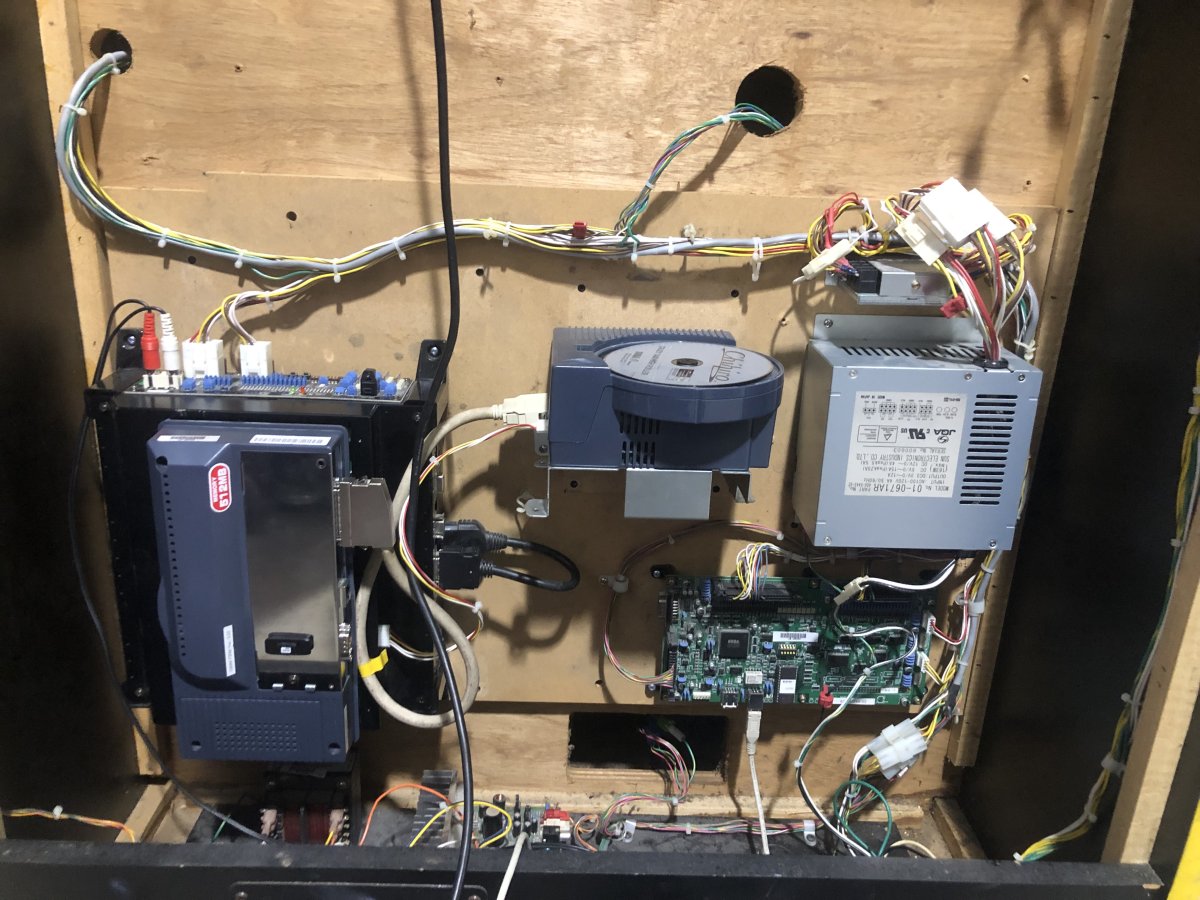

This is my setup now, pictured below. Will probably send all I can to Ken and just get it rebuilt and tested so I don’t jump through anymore hoops. My lower board was identical but the amp had been removed, the vertical board was all different, but made for all of those components, so my thought was that someone just took out the board with all the stuff from another game and stuck it in there. Sucks, but I didn’t have a ton of money in it and knew I was buying the eBay setup to get me closer to having all the original stuff. I have 5 GDRoms, 2 power supplies and 2 amp boards, so should be able to make it work
