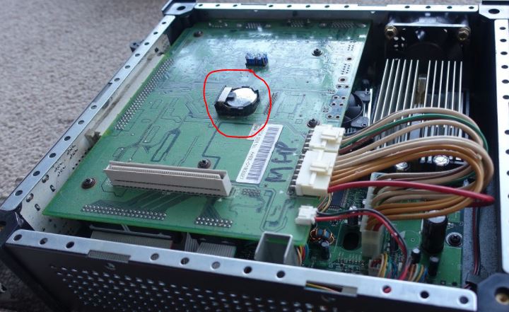

I will open the Chihiro up tonight. Any precautions to take or other ideas beside the AVIP cable on what to look for inside?
You can remove the Button Cell on the upper board of the bottom part to prevent current while unmounting the boards.
And, I do agree : watch the 3 big caps near the CPU and replace them if they look weird or bulked
