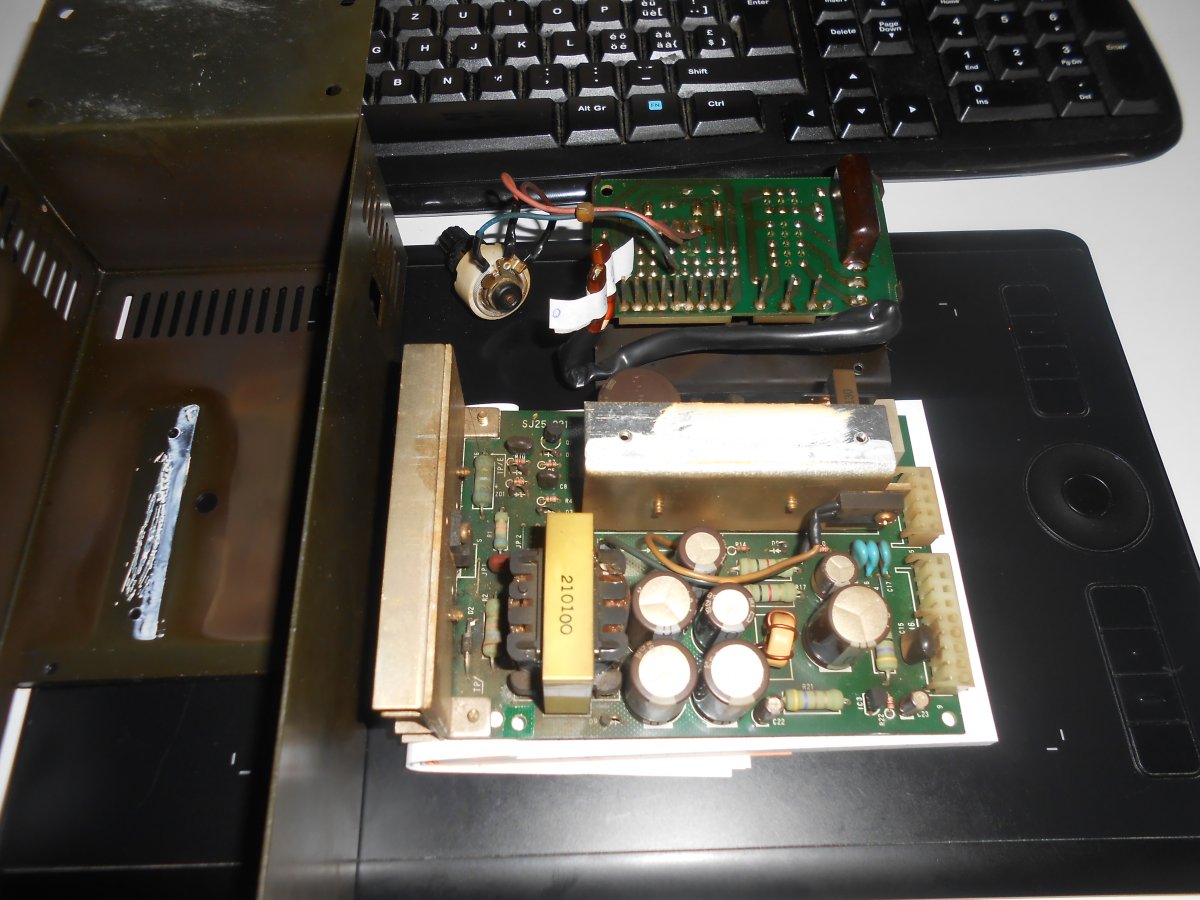

Id like to clean both PCBs. Can I just put some degreaser on the whole and leave all components to get washed or maybe should I remove some of them before? If yes, is it a company who can undo/redo and clean them proper?
I would recommend against washing with water. I know some folks have had good results washing with water and degreaser but the risks outweigh the benefits, in my opinion, especially since your boards does not look too dirty.
Instead, you should try 99.9% isopropyl alcohol and cotton swabs to remove dirt and grime. For stubborn grime and/or corrosion, you can use a fiberglass scratch pen but do so lightly.
You can wash it in water/soap/degreaser, etc... just need to blow off the excess water with air compressor, then rinse with 99% ipa (not the beer type :D) if you want (optional, not really needed) and then bake it in your oven at 170-175F for an hour and let it cool off in the there with it off for a few hours and you should be good to go.
If you are going to recap the PSU, which you should, remove the caps before you wash it, then recap it after its clean and dry. Also, apply fresh thermal grease/paste to the heatsink that attaches to the case.
Ok I'll do that way. But after cleaning I'll not use it right now, I'll wait about one month, the time my cab will be refurbished, I guess I can skip the the baking process right? Btw, I never heard about puting that kind of component into an oven... Even 170F will be not dangerous?

I wouldn't let water touch the transformer, so if you go that route I'd recommend desoldering it first and resolder it once fully dry.
Nowadays I'd leave it as is, maybe just recap with proper replacements. I'd clean with water + degreaser only if it's smelly.
Ok then I'll wash it with degreaser and hot water then put it on the baker by smooth hot temperature (I don't have a fan nor a heater so I'll use the baker only after have taken off visible water with the air compressor if you all agree with that).I'll post pics when doing it first like this it's sure i don't do mistake but it do not seems to be too complexe.
Btw I'm never impatient, I'm so anxious to miss it so I prefere to wait a few days to get proper relfexions on what would I maybe have forgot to do it proper before power on.
p.s. what does the transformer looks like? Seems that some don't care about that transformer, some do...
