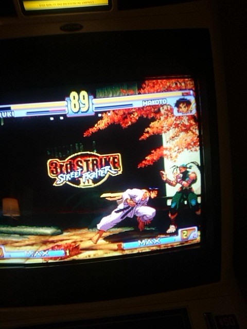

Hi have got another tube (ms29) for spare, this comes burn free and wonderfull colours but it is just a bit dimm on the darker areas and there it loses some details of the image, the contrast is high, the colors are good the white its ok but still have I have doubts about the calibration.
someone who has a 15kz cga monitor could post a quick photo of the video test/colour bars on a cps3 card?
This is this is what I got

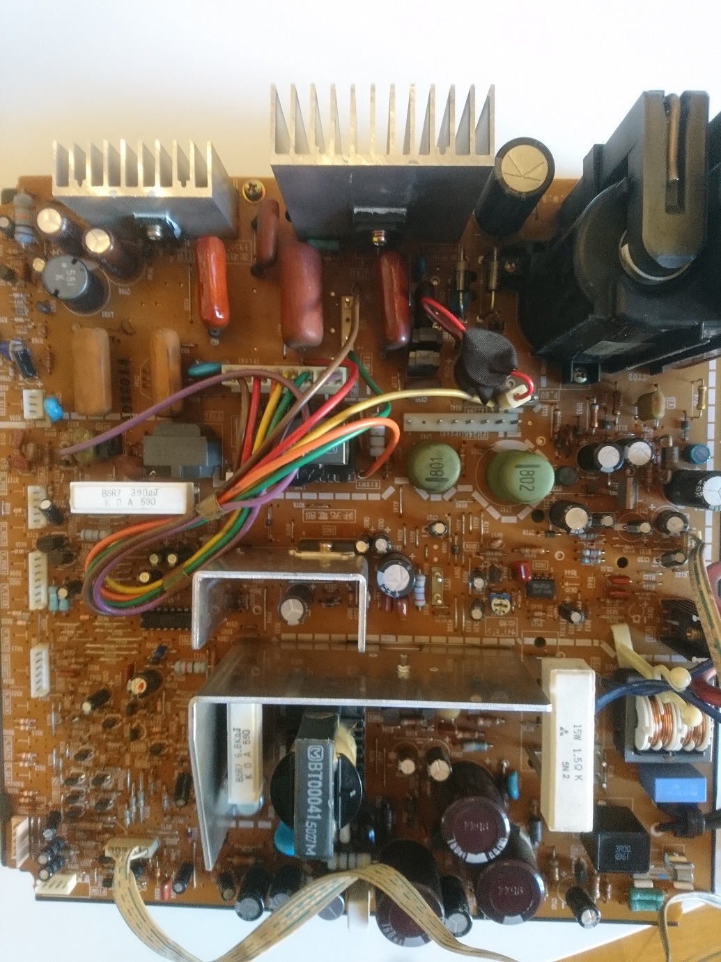

Here is some photos, it is an Hitachi GMK-29FS3, common chassis on super neo 29 and Capcom impress Candy cabs, this chassis drive so well even Ms9 tube/yoke combo.

I can't locate the cutoff adjustments on your pictures.
On many chassis, they are located on the tube neckboard.
So maybe if you could post a picture of that as well?

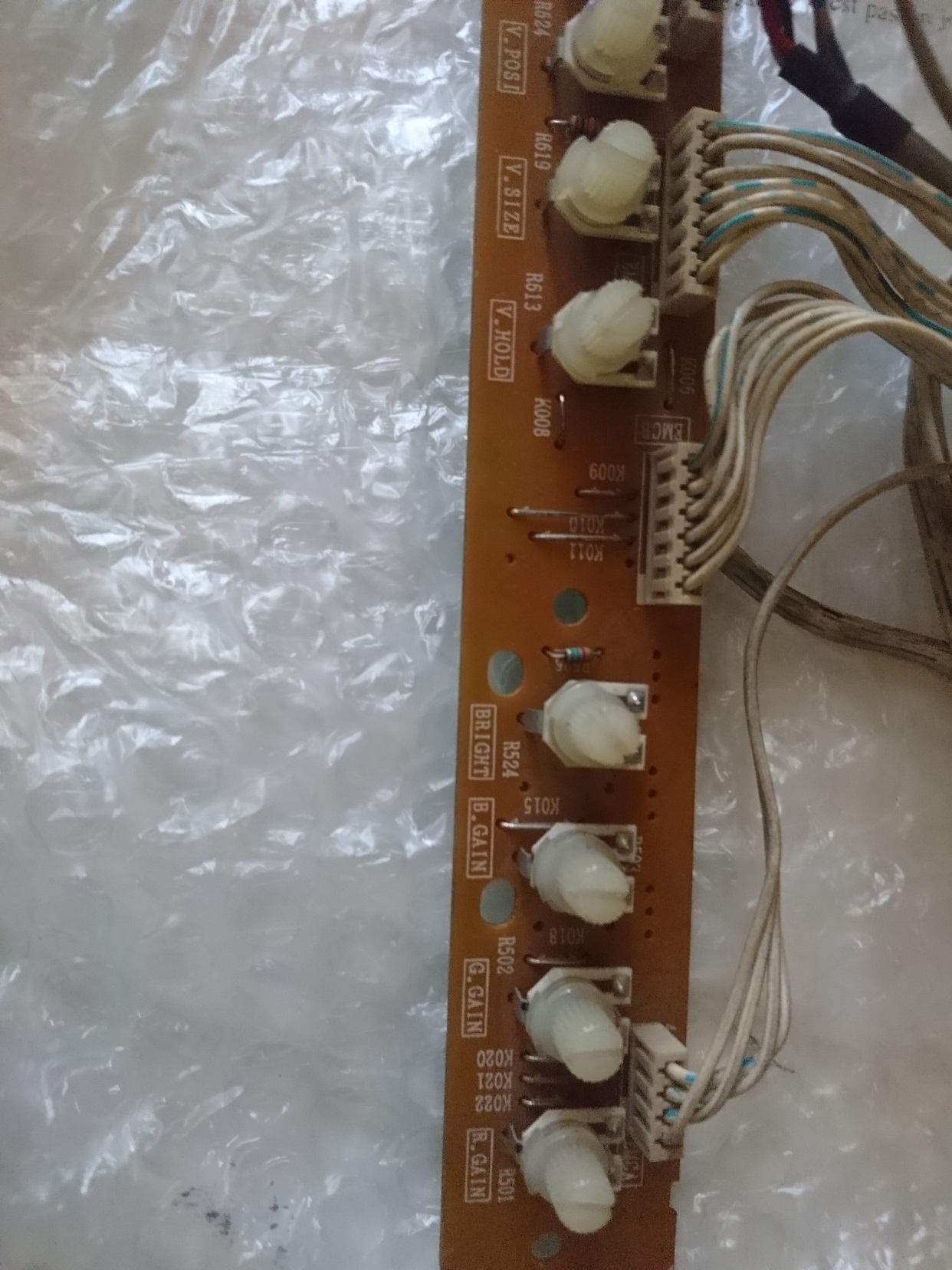

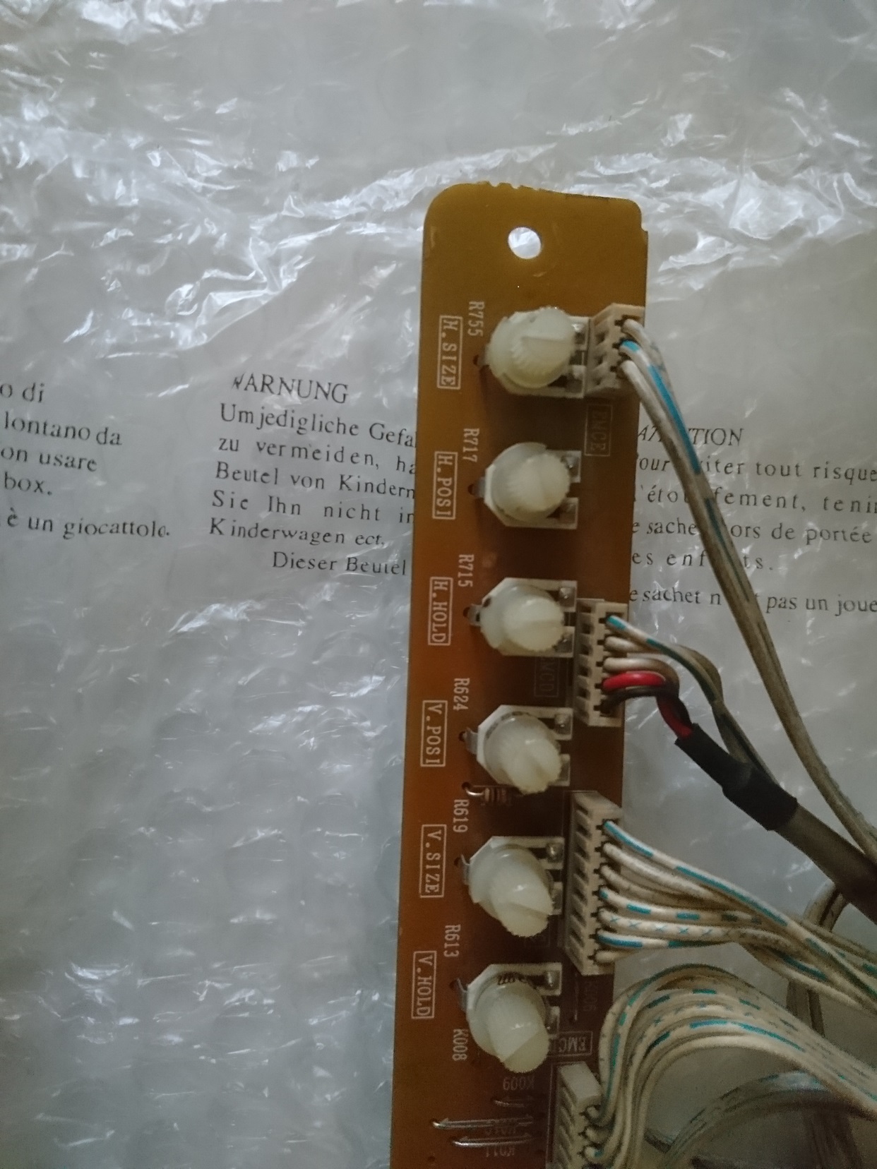

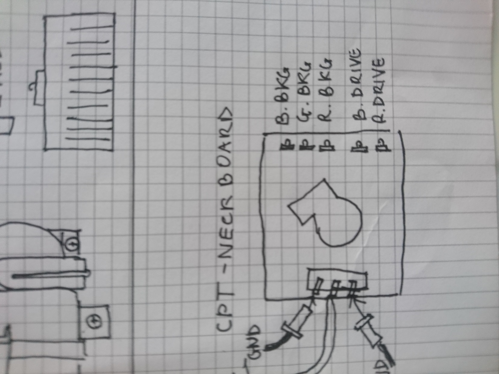

And yes the cut off pots are all on the neck board but It is very diccult for me to understand those settings it is like a Rubick Cube, If I touch one pot all collours miss match...here is a photo.
Note that there are five pots and named by impress manual as B.BKG, G.BKG, R.BKG and B.Drive, R.drive

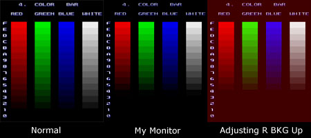

basically another user have described better than me where is the issue:
"When looking at color bar test patterns (such as the service menu color bars in the Capcom CPS2 games), I am not seeing some of the darker shades of color. They show up fine on the PC, but the arcade monitor just draws everything below a certain brightness as black.
For example, if there are 16 shades of red, the darkest 4 shades aren't visible at all -- they are just black.
For the most part the monitor image looks fantastic -- whites are bright and clear, etc.
On the front of the monitor are RGB Gain controls and a brightness control. Tweaking these makes the image brighter and darker but does not reveal the hidden bars of color.
On the back of the monitor are RGB "BKG" controls as well as "Drive" controls for I believe G and B (it's two of the three anyway). Toyed with these a bit and was unable to reveal the hidden bars of color.
In the attached image, the shot on the left is what I would expect to see. The middle shot is what I actually see. The shot on the right is what happens when I tweak with the R "BKG" control."

It's also possible that the inputs of your monitor expect a higher video signal. This for instance happens when you connect a pc vga card to an arcade monitor. The result you will see is identical to yours.
You normally shouldn't touch Rdrive and Bdrive for your issue as that's for the right side of your color bar.
So normally, the RBKG, GBKG and BBKG should give you the adjustments you need. If you turn up red, the screen will become reddish like you see on your picture. Only after you turn up green and blue will the picture become color correct again.

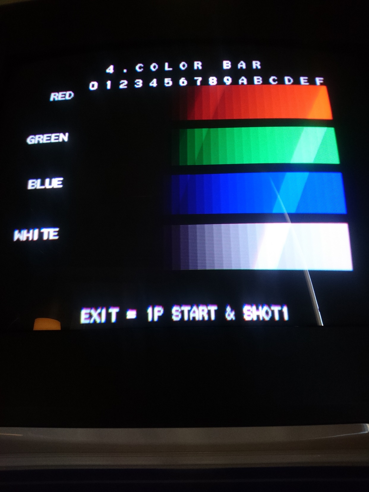

Thanks to all for helping me! bytheway i have fixed all just setting all colors gain and cut off, it was not so easy but due to the tutorial you have showed me it was a success..

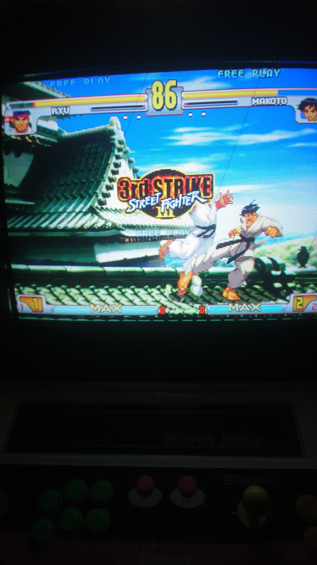

  • Finally I got full color bars and, the most important, in the same time the strongest White ever seen without bleeding any colour, that was archived using a mirror in front of the cab, and using Cps2 color bars, beleave me the ones on Cps3 not are good for this job. I must perform this on My new Astro city, where this operation is more more easy due to the more space to access at all pots, on Impress cab is a pain, you must be almost a contorsionist just to have access at neck board pots wich are at 1cm from the psu. Finally I have build a wires adapter to pulled out the original psu and have a better access at cut off pots. After moving the cab I got some discolarion at one corner, used a degauss wand to elimate this issue.
