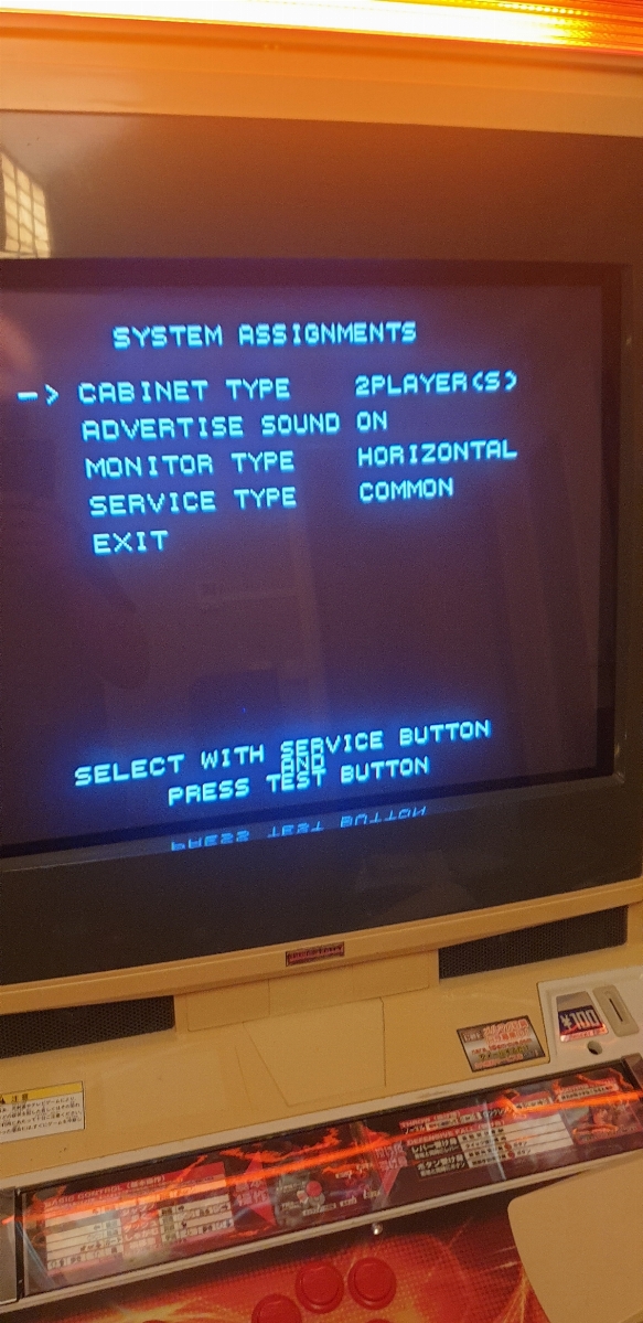

I have a compatibility problem with the JVS Versus Sega & Power Stone 1 Naomi kit.
I have no control over the New Net City Cab configured as Master, even the Setup button on the cabin does not work.
Everything is managed on the New Net City Cab configured as Slave, it's crazy
System connected Naomi with Power Stone Assignments System Cab type 2 players ,Service type Common.
New Net City Cab Master 1 player panel on white connector & New Net City Cab Slave 2 player panel on 1P White connector.
I had already asked MetalliC the question in 2018 "
MetalliC
anyway, early NAOMI games doesn't supports >1 JVS boards.
and Power Stone 1 is first 3rd party made game for NAOMI"
