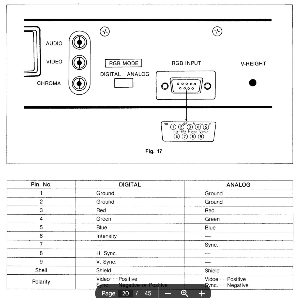

Documenting, If someone wants to connect HAS w/8 pin mini DIN to HD-15 Adapter to Commodore 1084-D. Make sure you have TTL Sync on your HAS. Monitor needs to be in analogue RGB mode. This works with Mister FPGA as well. Pinout is as:
DB9 pin (Commodore 1084-D)VGA pin Signal
15Ground
31Red
42Green
53Blue
713H-Sync
914V-Sync
