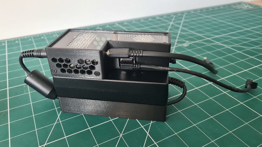

The laser in the PS2 has been giving me some gyp too. I was going to replace it but thought I would look at other loading options and decided to use psx-pi-smbshare to load games from USB. I didn't really want a Pi in a box with additional cables floating around so I thought I would see if I could fit something to the top of the PS2 PSU. It was a bit of a challenge to keep everything within the footprint and whilst keeping all of the cables axial but I managed it.
I used a Pi Zero with a ethernet/USB hat and a DC>DC voltage regulator to drop the 8.5V to 5V power the Pi. 8.5V is passed through to the other side to then power the PS2.
The button is to shut down the Pi so that files are not corrupted from a hard power off. I connected the button to the GPIO pins and edited the /boot/config.txt file to suit.

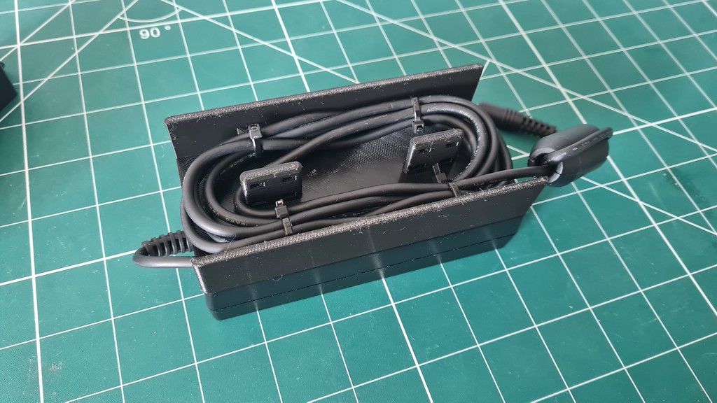

To tidy some of the excess wire I made a cable tidy to go on the bottom.
I was a bit concerned about any issues with heat but I checked the PSU and Pi with a IR heat gun before and after and it's made no difference.
