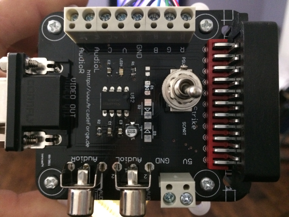

  • I have a Sync Strike that I plug my SCART cables into. This was sort of an impulse buy from me when I was researching this stuff. I don't even have a BVM monitor or ever intend to get one. But the purchase has turned out well for this purpose as It does a fine job of harvesting the signals I need. Sort of expensive but I'd recommend it since it saves a lot of time sourcing parts and greatly reduces the effort:
Very poor documentation on this little device. As a matter of fact, this is probably the best photo of the device you can find on the Net.
With the Sync Strike, I don't have to build a sync stripper circuit to harvest CSync. I also don't have to buy cables w/CSync. RGB, CSync, and VGnd are readily available from the screw terminals. I just need to tap into the 5vdc and Gnd on the SCART connection to power the THS7316 RGB amp.
Here is a shot of where I tapped into 5vdc and Gnd off the Sync Strike from the solder side. Now I run all the signals I need, RGB, 5vdc, and Gnd into the RGB amp. Coming out of the amp is the transcoded/amped RGB suitable for JAMMA connection. I couple that transcoded/amped RGB signal with the CSync and VGnd signals that are coming off the Sync Strike screw terminals and plug that into a JAMMA fingerboard with a 5-position JST NH connector (you can solder this in as an option. I have these connectors handy). As far as JAMMA fingerboards go, the best one on the market is the PB.Jamma (PB stands for Project Board) since it has properties that will lend very well to us later with control interfacing. Big thanks to @Lemony Vengeance for his efforts in designing this board.

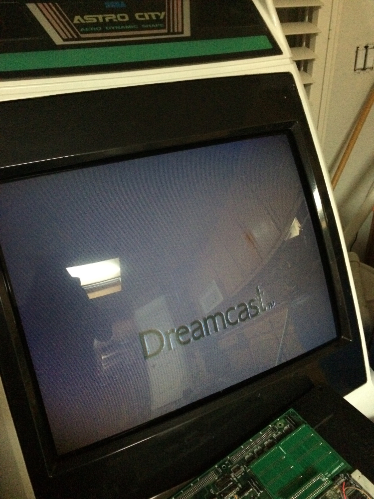

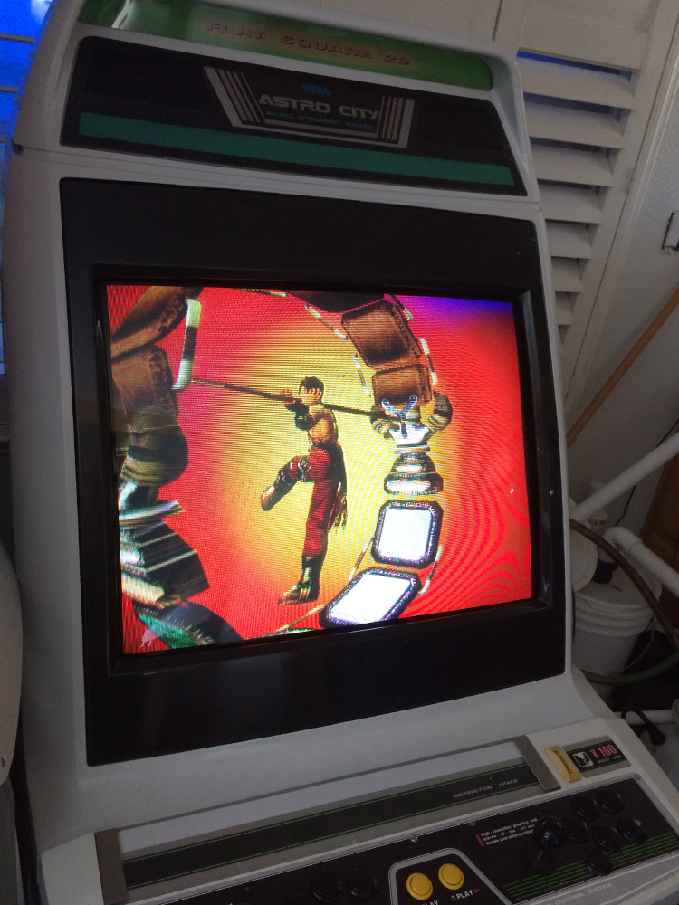

Time to test the video signal:
Can't buy PCB's for the final sequels for these arcade originated game series anywhere!
The image is on the left shows the image with the 0.1uf cap installed on the amp. The one on the right shows the image without the 0.1uf cap. You'll see the right image has much less noise. Bottom-line, don't install that cap for this purpose.
The image on the left shows the 220uf caps installed inside the SCART cable hood on the RGB signal lines. The image on the right has those caps removed. Bottom-line, you don't need 220uf caps for this purpose. Buy your SCART cables without those caps or desolder them from your cables.
Two last thing that I'll say:
  1. Some monitors can accept the RGB signal from a console. So far, my Wells Gardner K7000 monitor and my Neotec monitors can. viletim calls these domestic monitors (US made monitors). These monitors use the same parts from TV's so they can be used to some extent without building the amp. If you only have one cab and it has such a monitor, you might get away without building the amp. You'll definitely need to recalibrate the image. But if you have a candy cab with Japanese monitors, you need the amp.
  2. This amp should work for amping, clamping, DC-restoring and DC-coupling your CRT_Emu MAME rigs. I haven't tried it yet. Saves you from buying Ultimarc's Video amp or the J-Pac. Now you can use real joystick PCB's rather than using the J-Pac's keyboard encoder.
The video interfacing portion is now complete. Off to audio interfacing!!

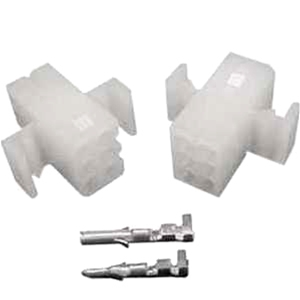

    • Run speaker cables to both of your speakers, then terminate them to 0.62 6-postion molex connector, or something similar. This is where the manual switching will be applied, so no black electrical tape rigging here. I have never seen a 0.62 4-position molex connector. But that is okay if we leave 2 of the 6 positions unused.
    • From your JAMMA harness, terminate the +/- speaker signal so that there is a tag end hanging off each pin long enough to crimp in another pin. The extra pin off the tag end is a jumper/daisy chain which allows the same mono audio signal to be sent to both speakers. Just make sure you have the polarities right: negative to negative, positive to positive. This is how I have seen it done on numerous US cabs when there is a need to switch back and forth between a mono JAMMA setup to a stereo setup. There is probably a way to do this without manual switching. But then again, what's a little manual switching compared to the cost of more money?
    • Now make another plug that will fit into the speaker terminal plug. This time however, run one wire for each speaker since this will be our stereo setup (no jumpering/daisy chaining). Leave a length long enough to reach where you will place your JAMMA adapter.
