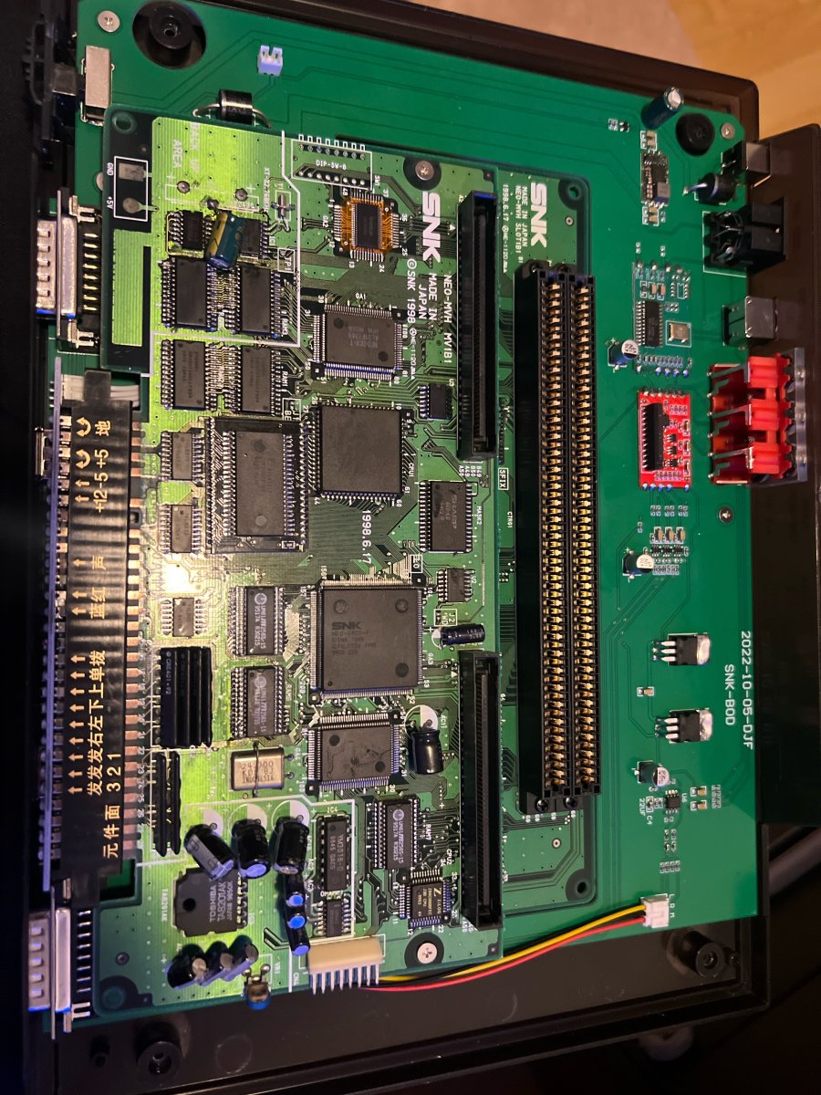

I bought myself consolized MVS from Aliexpress, I love it. It pair super with my Darksoft cart. Sadly my board had some so it is now in the process to get it replaced. The component out was missing Red, or st least it was quite dimm. Also niticed sometimes a line of pixels that was garbled. But this was on all video outputs so I assumed that likely sync wasn’t super stable or something.
This made me wonder, does anybody know which design they are based of?
In case I run into issues in the future I can fix it myself instead of sending it back to China.

Yeah, I recognize this. These are an MV1B board with custom PCB's from China to consolize it. They have flex cables to flatten the board and make it vertical-loading.

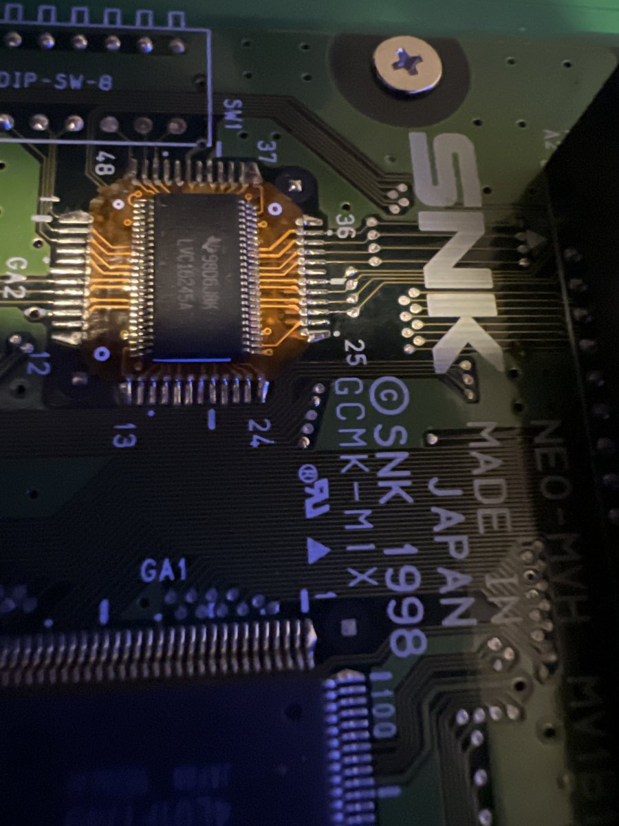

I'm a bit curious about that NEO-BUF replacement. Looks like they added an IC instead of just bridging the pins with the flex cable.
I see what you mean. Sadly I cannot take better pictures. Replacement is on it’s way. I’ll check it out and place some higher detailed pictures of the new board.
I have one of these too, is there something I can provide for you?
@ack Took a look in through the cart slot, and I have a completely different model internally, and the NEO-BUF is unpopulated entirely. It's the same in the way they used ribbon cables to flatten the PCB and have the add-on PCBs, but I have a NEO-MVH SLOT1 and not a MV1B1 as @coldasijs has.

@ack here is a picture of the chip
The component video output on these units is not good. You described how it looks well. Red is dull.
