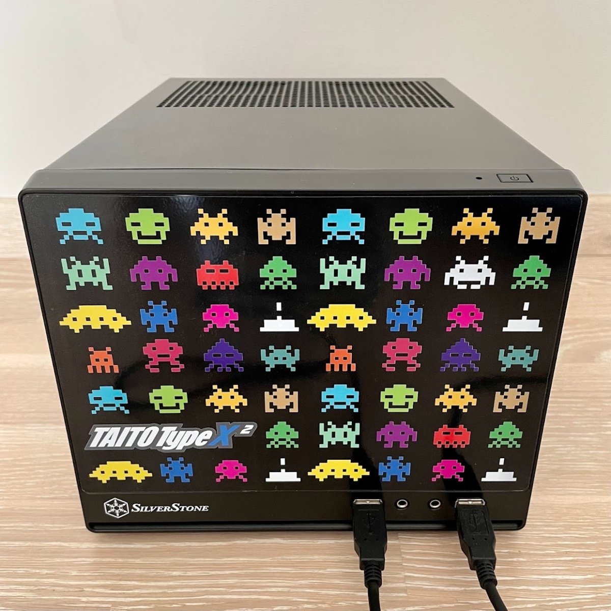

As titled, this is a clone TTX2 system that actually contains NO original TTX2 components, but is instead built around a TTX3 IO for JVS, and paired with an IONA IO to handle input.
I can probably claim this to be the smallest X2 build - the SilverStone SG13 case is wonderfully compact, but of course a challenge to fit a full sized ATX PSU into.
From left to right: Front panel USB ports repurposed for IONA USB input. Test and service buttons. TTX3 IO hardwired to negate need for daughter board.
(Of course the security dongle is completely redundant in this case...)
I did stay faithful to the X2 spec inasmuch as it is a LGA 775 system with Intel G41 chipset. Liberties were of course taken at every opportunity...

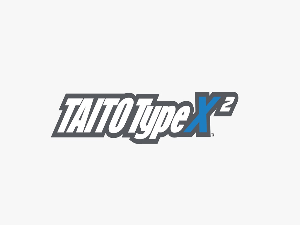

One neat feature of the G41S-K motherboard is that I am able to set a custom Bios splash screen so I went that extra distance.
Main issue is that between resolution changes and the speed at which the SSD boots into Nikos multi - you don't actually get to see it

- Foxconn G41S-K Micro-ATX motherboard
- 400W Corsair PSU (lots of extra molex connectors snipped...)
- Intel Core 2 Duo 3.33Ghz E8600 processor
- 2GB RAM (constrained by single slot design)
- XFX Geforce 7950GT Extreme (passive dual-slot heatsink swapped out for active cooling)
- WD 240GB Green SSD
- TTX3 IO (minus daughterboard) JVS only!
- MP07-IONA-US JVS Interface
- Pair of Hori RAP V3 SA sticks with custom artwork by GStick Art (Instagram)
- One large custom Space Invaders decal to hide the fact that I built a mid to late 2000s desktop PC...
