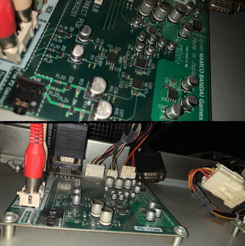

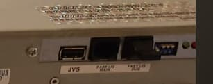

Noir HD cabinet running a Taito Type X3 with ARTAX Multi 4.1. The only way I could get controls to work at all was to plug the USB cable that was plugged into this board:
Directly into the JVS port on the TTX3 and bypass this board entirely.
The cabinet also has this board:
In the bottom of it.
Based on what I have, would it be better to buy new parts and rewire the machine for fast IO, or is there something I am doing wrong with the stuff that I have that will make the machine more compatible with the multi image I am using?

The Noir JVS, which is what you are using, is incompatible with the drivers being used on the TTX3 multi. The best solution is to rewire the cab for Fast I/O.
I thought that might be the case. Is there a guide anywhere that I can follow to at least just get an idea of the right stuff to buy and the basics of getting it installed?
