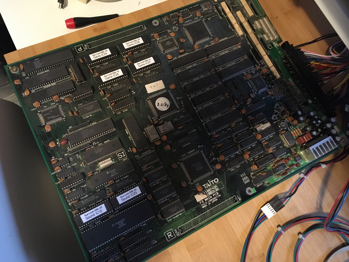

Hi,
After the success of the football champ conversion to dead connection i am now wondering if i can convert my F3 single layer Taito 'Cup Finals' PCB Part number K1100743A to something else? Dungeon Magic looks cool as does Rayforce. Are there different flavours of single board, or it is the same for all games on this hardware? Or did they only make certain game on single layer format?
Interested to know.
My board looks like this
Cheers
Jim

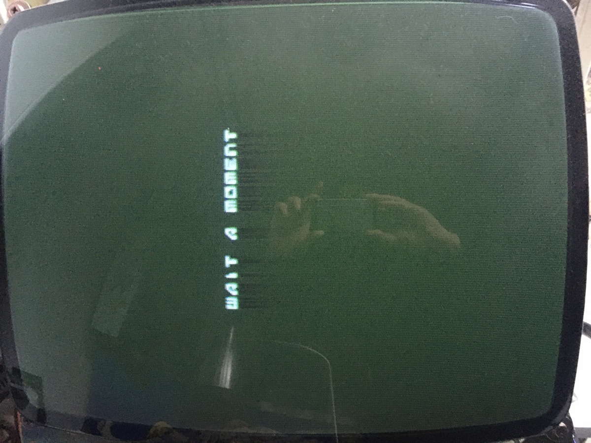

Some progress :)

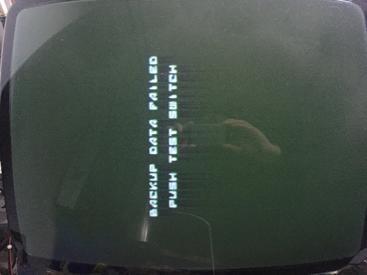

Burnt the 6 socketed roms that were socketed to see what happened. 4 for the Game code and 2 for sound code. As was mentioning before the game rom dump laebelling matched the boards silkscreen exactly
And was presented with an nice encouraging message...

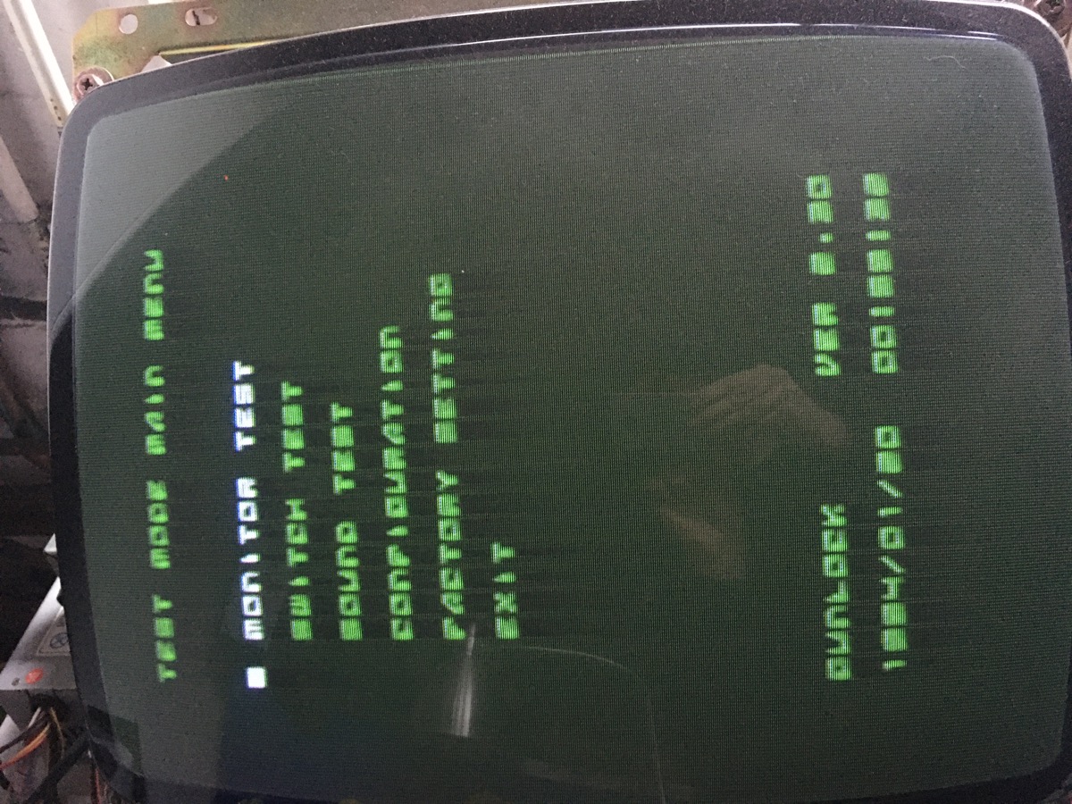

Then..

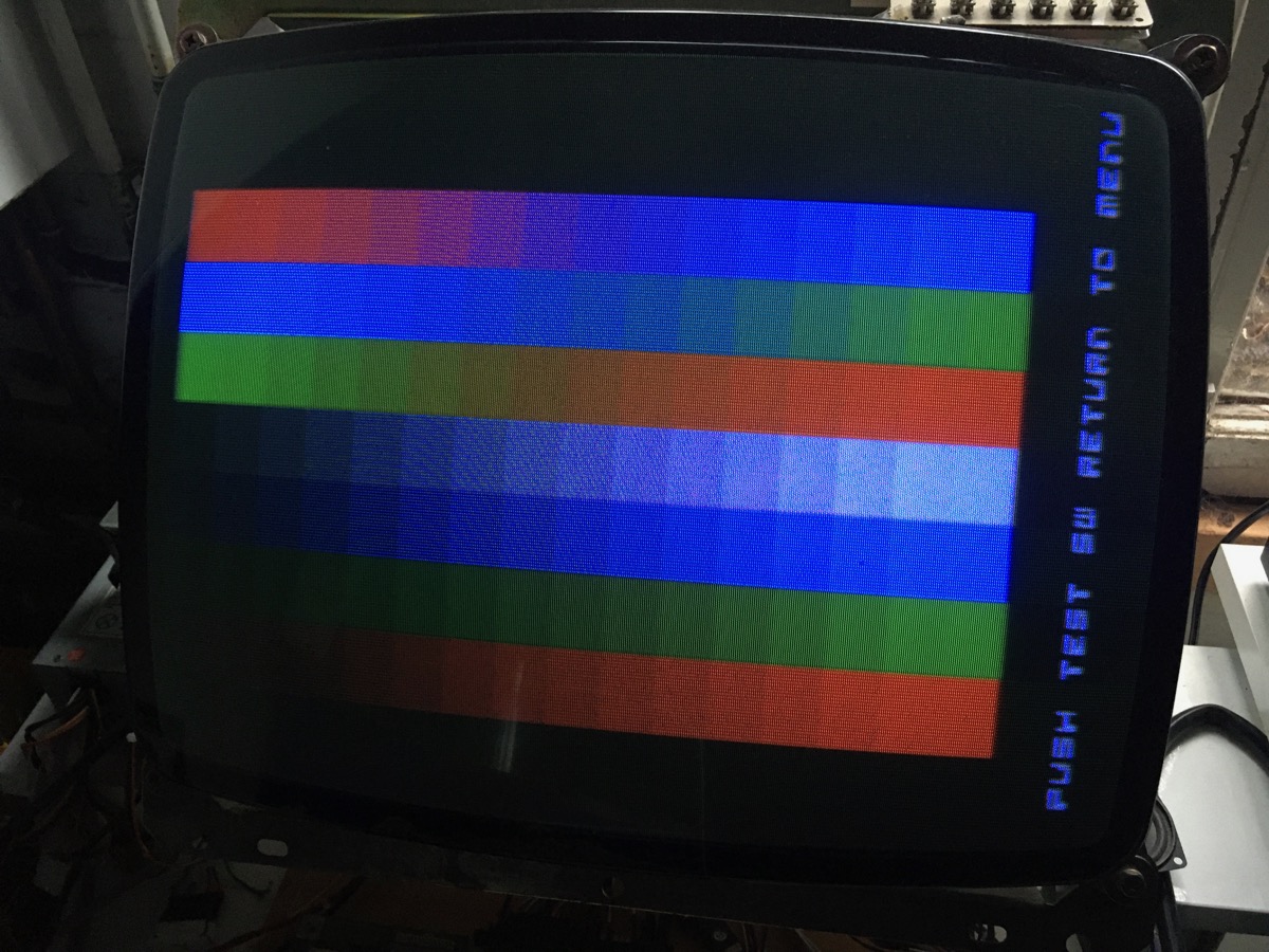

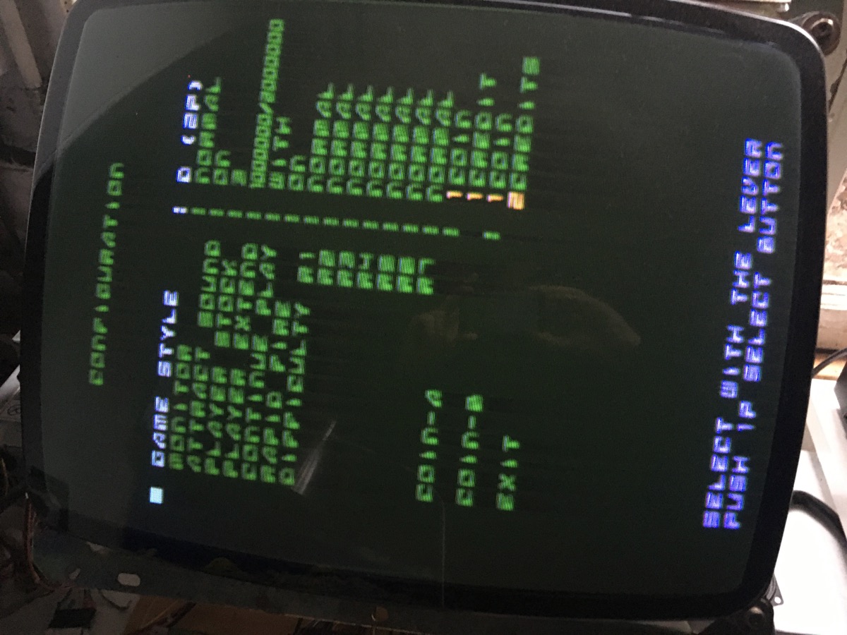

and then took me into a settings menu..
Exited out of this after some tests

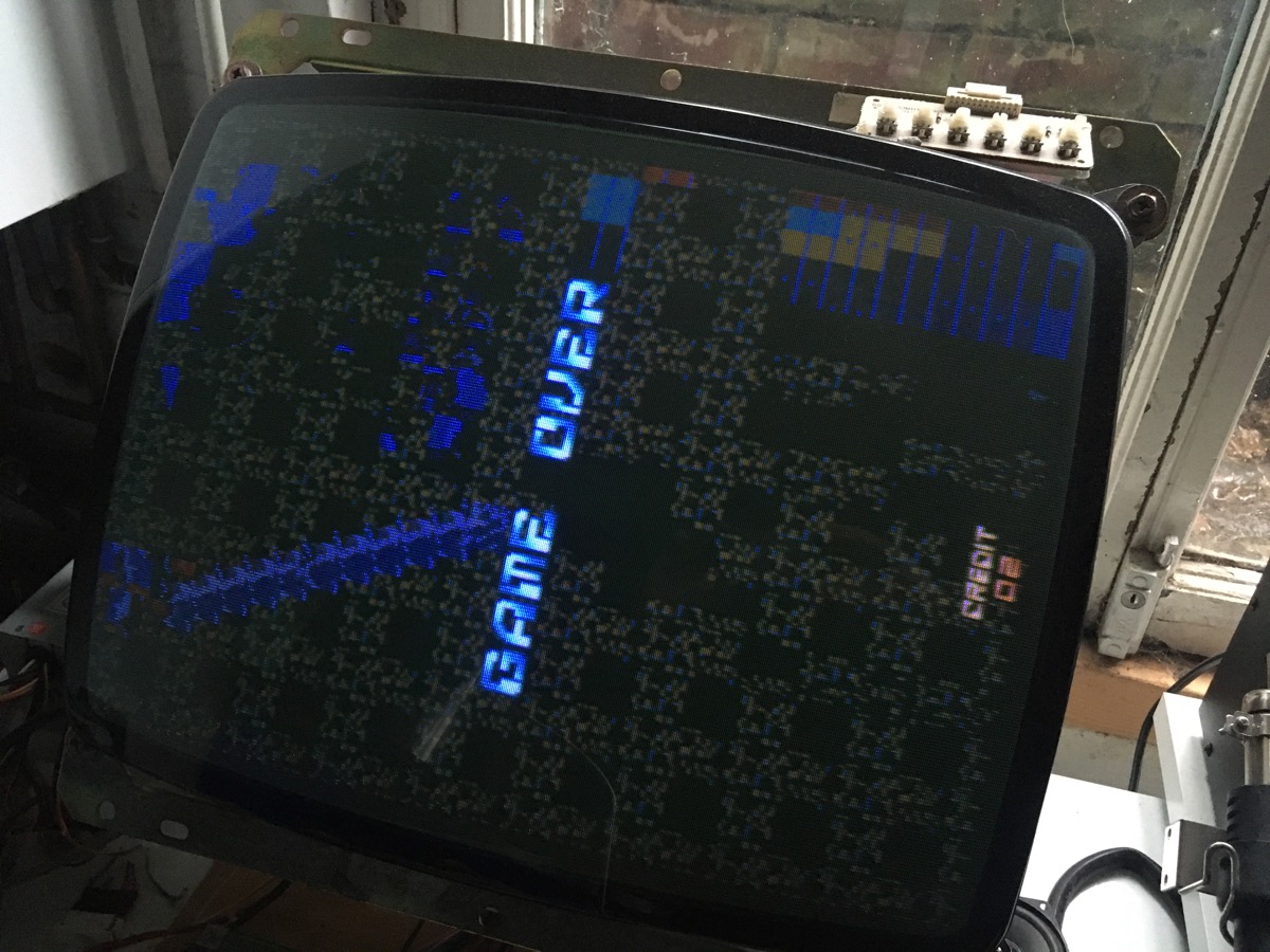

and..
Could play a game! Obviously all the sprites and tiles are wrong, but i could move a blob around the screen and shoot stuff!
No sound though yet. I wonder if there's a 2mb pin30 issue again, as the sound roms are twice the size as cup finals. Though the board silkscreen does clearly say 27c1001/27c2001 next to each one. Interestingly the games rom ones just say 27c2001 near them though and cup finals uses 4 x 27c1001 game roms!
So pretty happy with this.
What does everyone think?
Next to swap the soldered sprite and tile roms
This is awesome, thanks for sharing! :)
I would wait on sound assessments though. Sound code probably pulls from other ROMs for sound data, so probably sound could be working, but the data is all messed up (as would make sense in this scenario).
