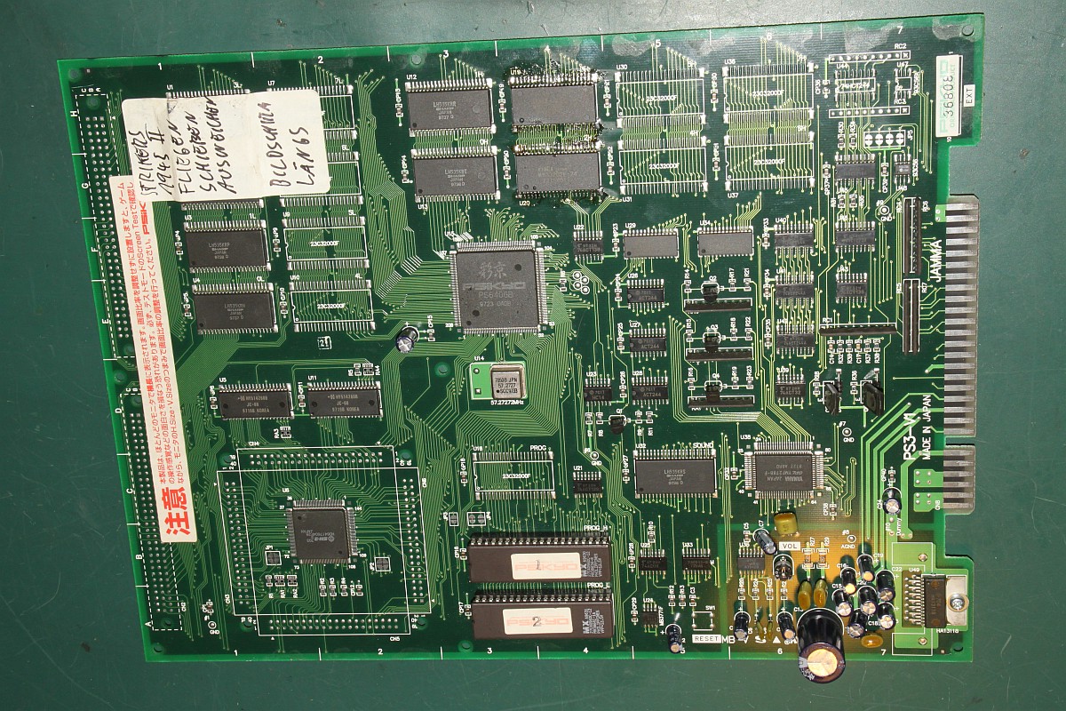

I recently bought this cheap PCB that was listed as a "Strikers 1945" but looked like a newer SH2 based PCB. it's actually Strikers 1945 II but it looks like it was converted to that. All of the roms have black paint on them, the sound rom is doubled up with a logic ic attached to it and there are a few other wires on here.
Anyone know what this PCB was originally? it's a PS3V1 PCB which mame says was used for:
Sol Divide (c)1997
Strikers 1945 II (c)1997
Space Bomber Ver.B (c)1998
Daraku Tenshi - The Fallen Angels (c)1998
I can't imagine they's covert something like Sol Divide to 1945 but who knows...

I mean, Sol Divide is arguably the worst shmup that Psikyo put out, and you can pick it up for $50-75 less than Strikers II usually, I don't think it's that out of line to think that's where it came from.
Or maybe it's an obscenely extensive repair and was Strikers II originally?
there doesn't seem to be any damage to the PCB that would have warranted a repair.
the most confusing to me is the painted roms...
Plugging the JAMMA connector in backwards wouldn't show any PCB damage.
Just theorizing, I'm as without an answer as you are.
Its a conversion. Thats why the ICs are painted over, they used to be scraped off.
I guess most likely the roms were split among the flashes?

Looks like a conversion PCB. The OG Striker 1945 PCB has different layout.
The stickers on EPROMs are not original,either. I saw the Chinese characters on the stickers. I am sure the PCB is from China...
There are some skilled persons doing arcade PCB repair/conversion and sale them online here.
wow, my conversion looks like it was done by the same person that did your first example there. same wire color and hot glue technique and everything.
what Psikyo game uses the sub board?
None that I’m aware of, those sub boards were fabbed for the conversions. I guess as an extension for the flash spaces. They were probably the early attempts at the conversions .

I've been looking into this a bit more lately. it seems that Psikyo themselves did a lot of factory conversions.
I've found examples of Fallen Angels that were converted to Space Bomber by Psikyo. and AFAIK every Gunbarch and G-Taste originally started as a Dragon Blaze.
From what I've been reading there is some security data on the EEPROM and that's what needs to be reflashed to make the conversion work.
though, my bootleg 1945II has quite a few additional patch wires that I haven't figured out yet what they're for. and the ROM mapping is quite different than the original board too.
It also seems that all of the ROMS are routed to the large un populated headers along the top of the PCB. I actually ordered some connectors to build a sub-PCB and experiment with since that will be easier than surface mount work.
I haven't done much past that though.
if your board has graphics glitches though I think you'll first want to determine if that's an issues with the ROMs or something else.
