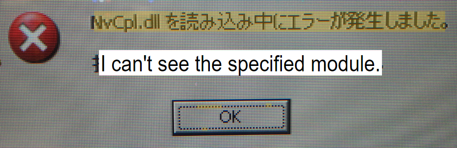

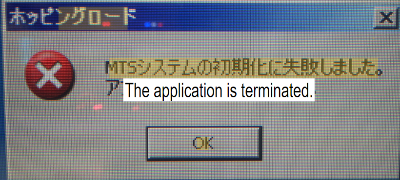

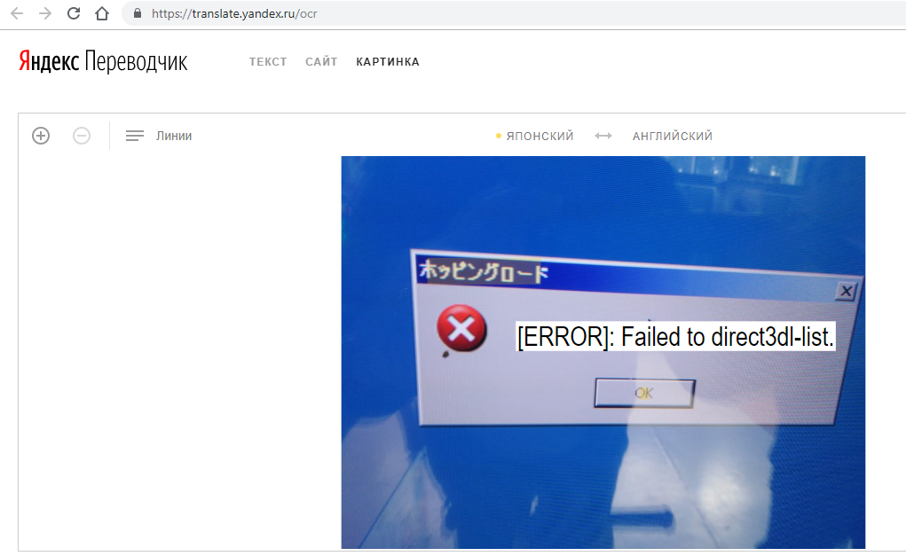

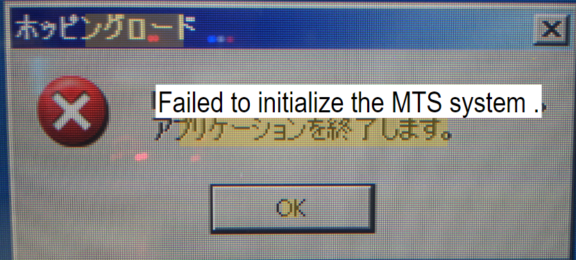

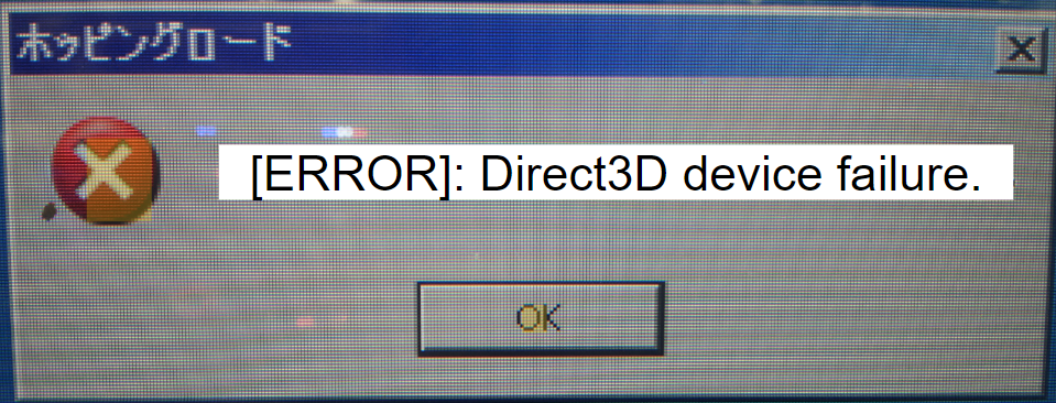

M Maftun Beginner Joined May 14, 2019 Messages 12 Reaction score 1 Location Azerbaijan May 25, 2019 #23 Made correct translation of errors Attachments 2019-05-25_17-55-59.png 828.9 KB · Views: 265 2019-05-25_17-58-26.png 747.7 KB · Views: 256 2019-05-25_17-58-34.png 747.1 KB · Views: 257

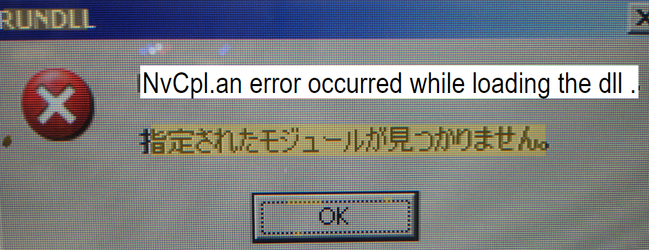

M Maftun Beginner Joined May 14, 2019 Messages 12 Reaction score 1 Location Azerbaijan May 25, 2019 #24 It was possible to run the command line. After entering rundll32.exe NvCpl.dll, dtcfg setmode 3 2720 768 produced this error Attachments 2019-05-25_18-41-47.png 813.6 KB · Views: 235 2019-05-25_18-42-01.png 668.5 KB · Views: 241

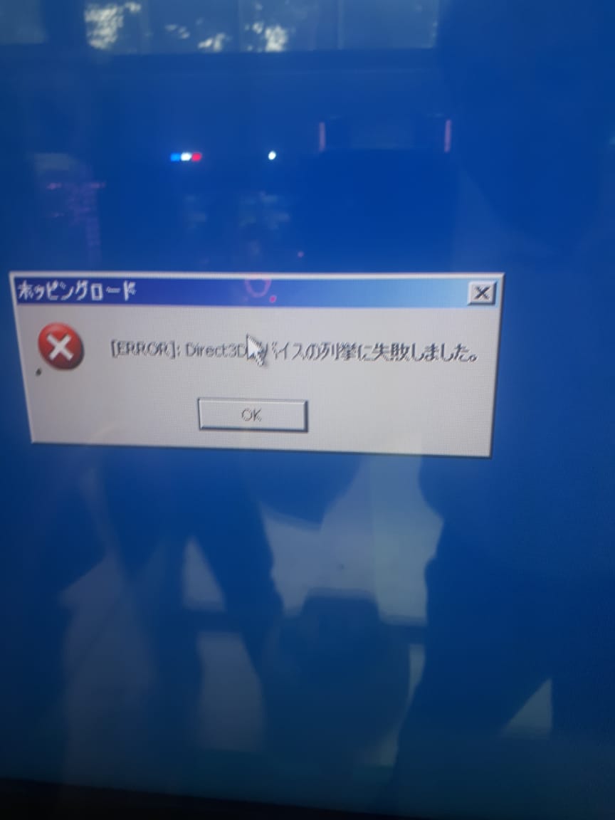

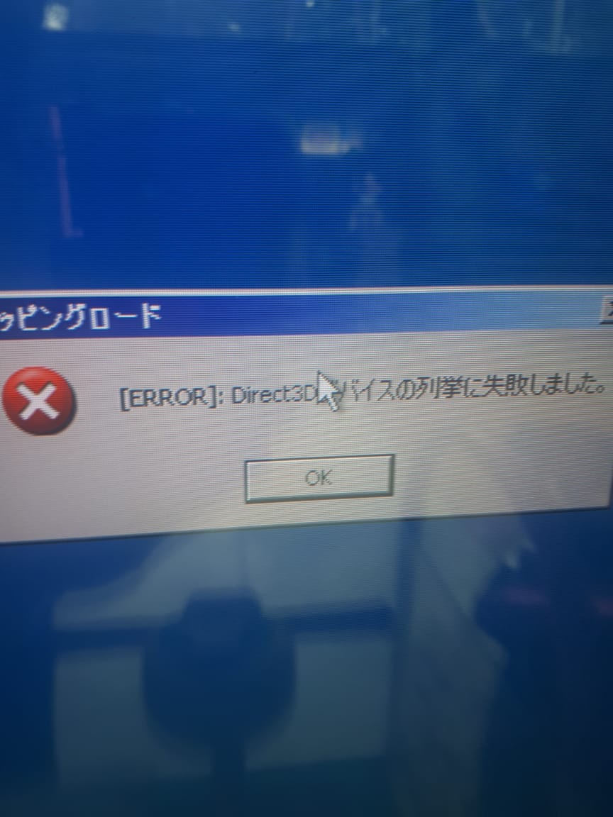

M Maftun Beginner Joined May 14, 2019 Messages 12 Reaction score 1 Location Azerbaijan May 25, 2019 #25 After downloading the d3d9.dll file via this link https://archive.org/details/Swiftshader_3.0_32bit_Only, the errors no longer appear, but the game still does not load.

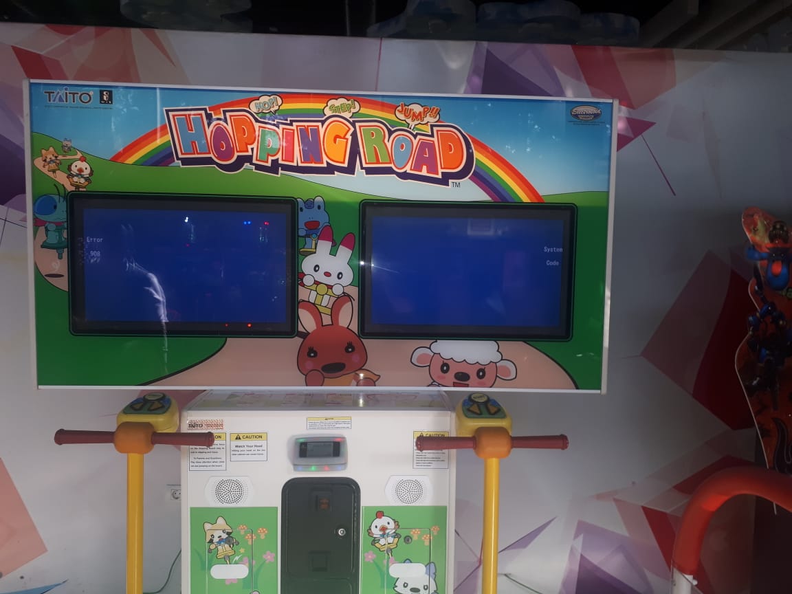

rtw Enlightened Joined Sep 28, 2015 Messages 2,114 Reaction score 2,648 Location Norway May 25, 2019 #26 If any of the PC people here can tell me how to make NvCpl span across 2 screens that would be very helpful. 2720*768
