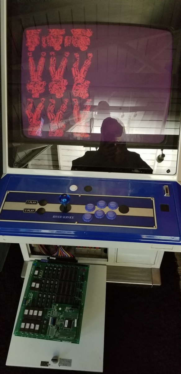

Nothing too in depth or detailed about this repair. I started with replacement of the CPS-A-01, and that's all it took. Looks pretty bad on the surface, and like it could be any number of things, but as we know, it's almost always the custom chip that's at fault.
The symptoms:

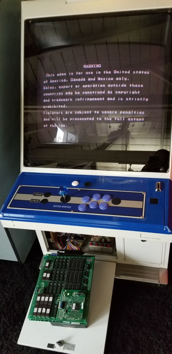

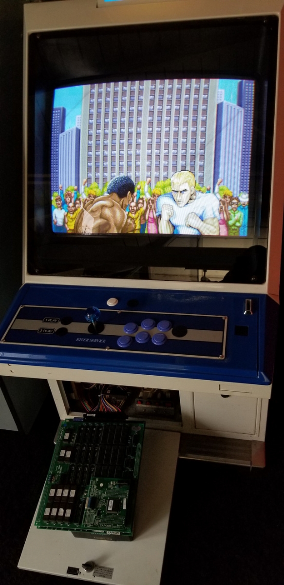

Repaired:

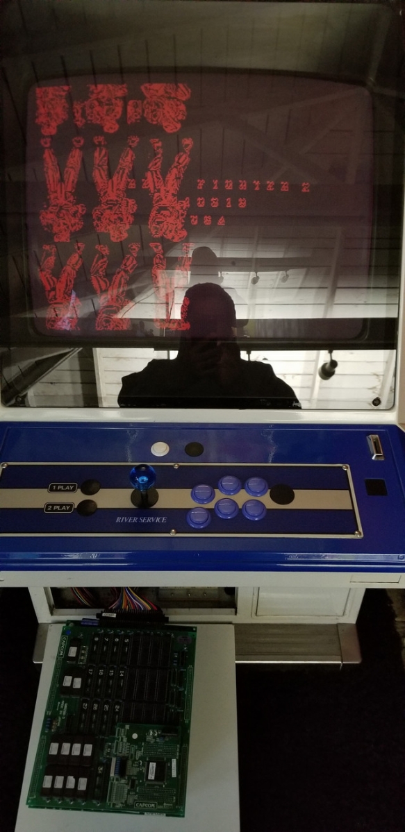

The symptoms:

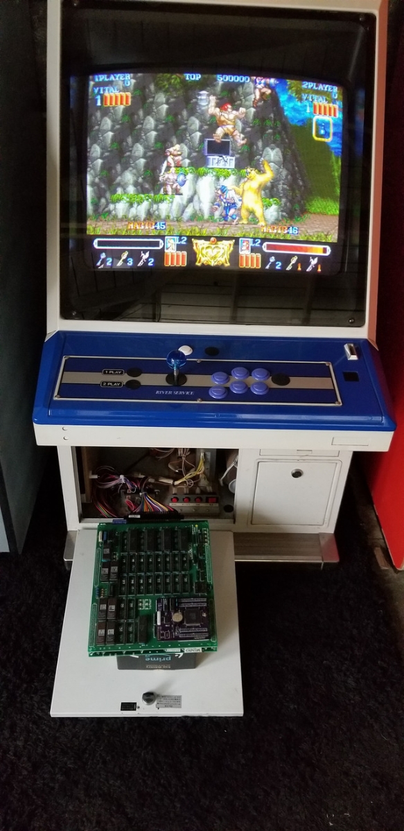

Repaired:
And paired back up with the Magic Sword B board that it came with (and replacement C board, because that custom was also faulty):
