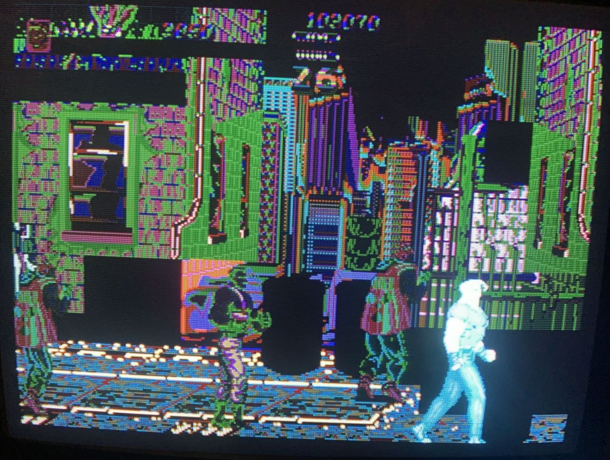

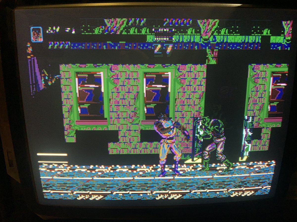

The thing is that i get on screen like sprites missing and fosforite effect. Sound is ok. Game is playable with that Fosforite and missing sprites Effect.
Also i saw some suspicious tracks in C board (comes with B-04) but seems ok, good continuity, i check voltages in eproms and others B board and C board and seems 5V are ok.

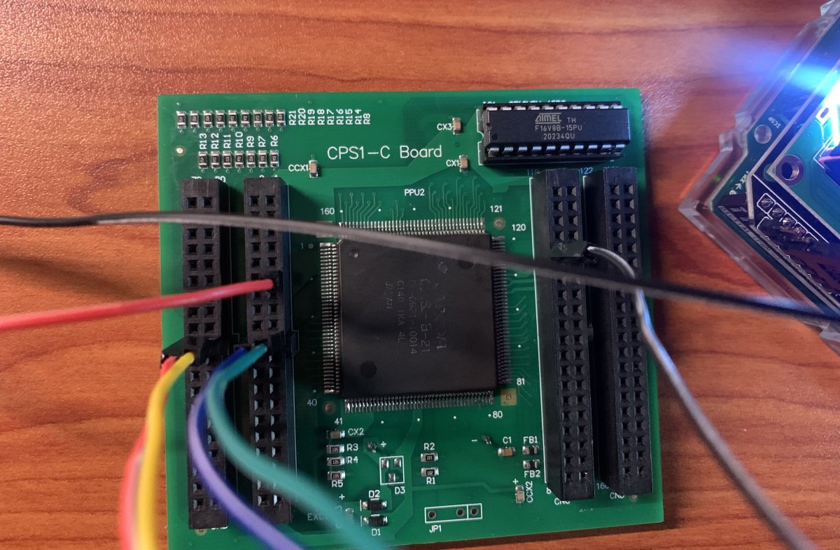

Then to know for sure that the problem is related to B-04 i get from Darksoft a C Board with a B-21 to try reprogram it like B-04 and try after that run the game with that board. Then when i received this Darksoft C board first i installed a 3V 2032 battery on it, i get an arduino uno R3 + lcd and i upload this ArcadeHacker fork on the device:
https://github.com/TwistedTom/ArcadeHacker_CPS1
Seems this fork have all codes to program a B-21 like other customs capcom, for me i need B-04
I tried it then but i get no results, i mean programming seems ok but when i put the Darksoft board instead original B-04 i get black screen.
I´m wondering if i need the code for the game Final Fight too besides B-04 code to inject in the Darksoft C board with B_21, but i dindt see codes for thos CPS1 games that had not battery like Finfal FIght.
Dont Know, also i tried reprogram the Darksoft B-21 like B-01 but same result, black screen.
If anyone know how reprogram this Darksoft C Board like B-04 or if i missing something in the process please let me know.

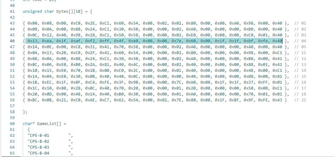

I haven't use that fork before, but the values being programmed for B-04 (and a number of the other ones) don't match up with what I have openkey programming for them. I know I've programmed and tested a B-04 with openkey. Try replacing the B-04 values with these and see if it helps.
Code:
  { 0x13, 0xea, 0x1f, 0xaf, 0xf2, 0xff, 0x4f, 0xe0, 0x00, 0x00, 0x7e, 0x60, 0x00, 0x1f, 0x1f, 0xbf, 0xfe, 0x40 }, // 01111 [B-04] CPS_B_04     Final Fight

About the code i tried that you posted with openkey, i put it in the .ino this way:
I uploaded new code changes to Arduino and after reprogram the Darksoft C board and test in the game board= Black Screen.

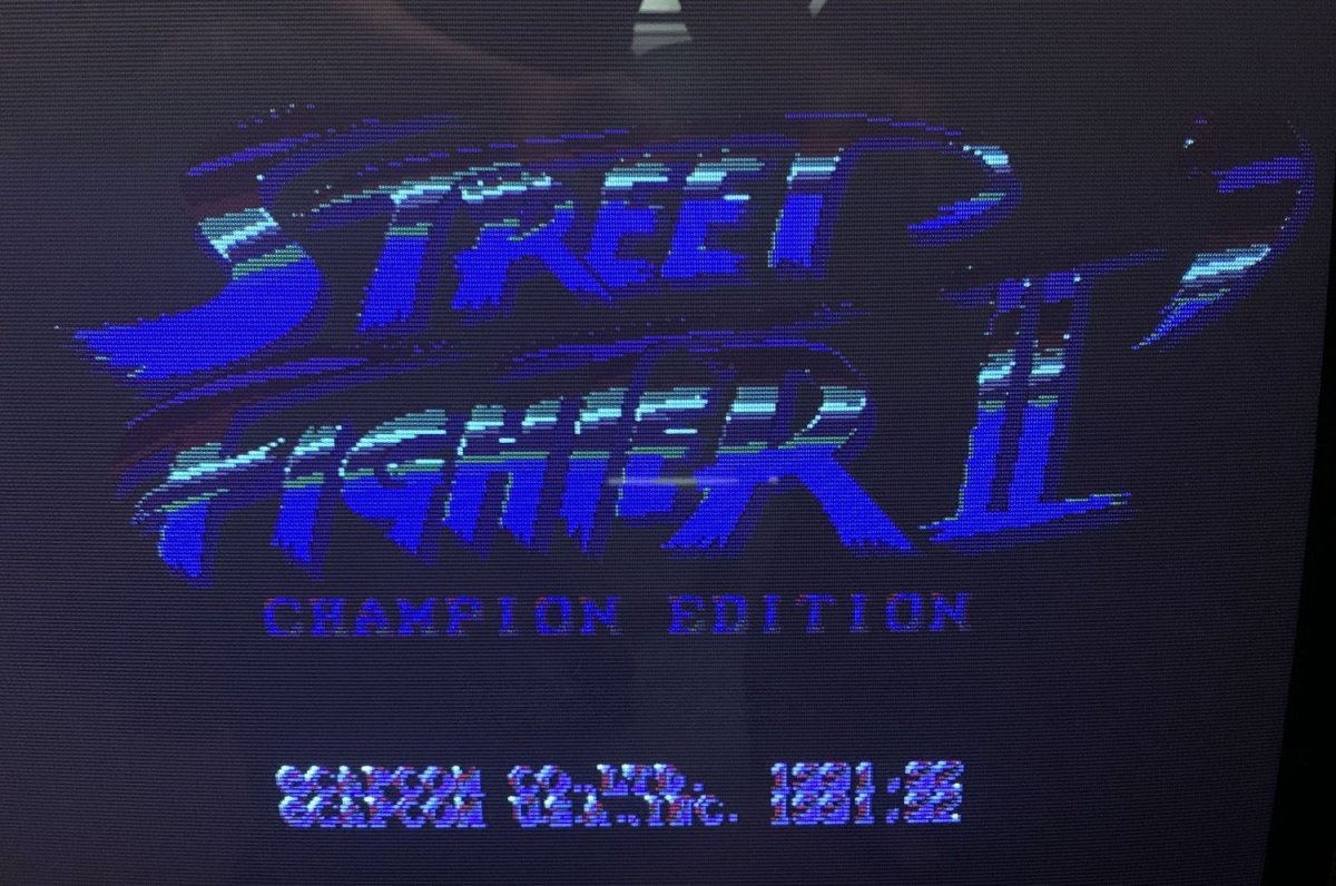

It should just need the CR2032 like you installed. I would try verify your programming is working ok. It sounds like you have an SFCE board, maybe try programming the darksoft C board to work with that board as a test.
Ok, according mame above link and romident, i have in mine SFCE dump a {"sf2ceub", CPS_B_21_DEF, mapper_S9263B, 0x36 } version.
Mine SFCE Board-C is 92631C-6 and comes with b-21.
Then, i programmed the Darksoft C Board with B-21 key from the above fork i posted, and after i tried Darksoft C board in mine SFCE B board.

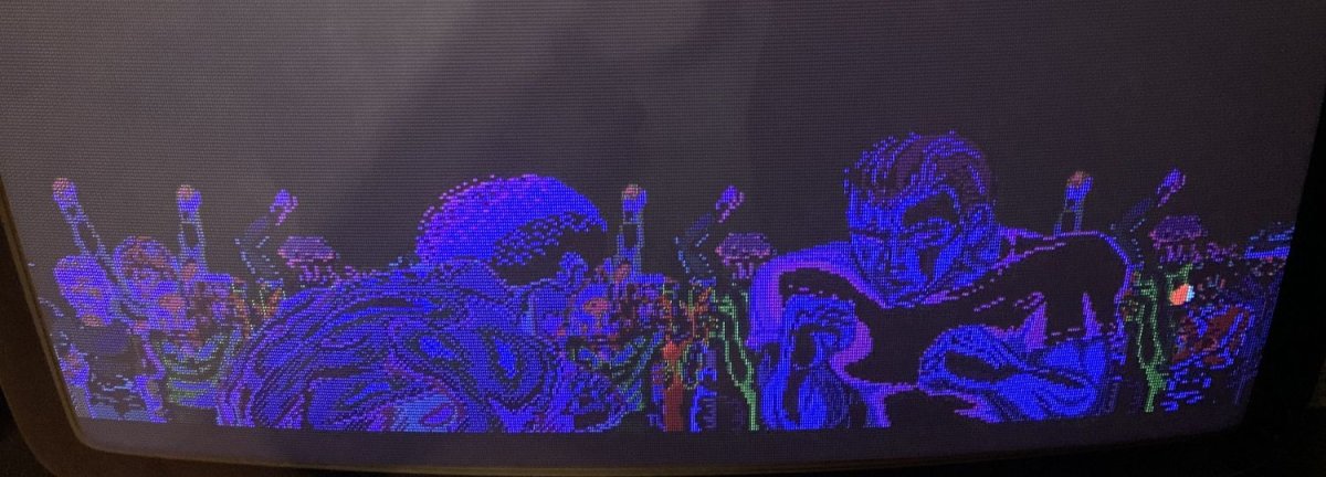

Result: works! (i noticed like autofire in kick, i mean 1P player always make a Kick on interval like if someone push kick button like 3 seconds, even in game menu, but this maybe is normal or maybe other external problem, not happen with B-21 SFCE original) After i removed the Darksoft C board again and i reprogrammed like B-04 (code form original fork, not the openkey code), i did this to know if something change in the C board B-21 from Darksoft using B-21 code key or B-04 code key with SFCE, this to really know if program with arduino is working. Ok, after reprogrammed with B-04 code key i put the Darksoft C board again into SFCE and i saw this on screen using B-21 Darksoft programmed like B-04 fork code.
Then, it seems the game partially boot up with weird colours and sprites programmed like B-04, in SFCE, i dont know if this behaviour is normal, but remember me a lot to effect i had with final fight. Sounds like a bad conection maybe, bad signal redirection working like B-04 instead B-21, pinout incompatible?
Maybe in mine Final Fight B board i have that issue, bad conection tracks, dead signals, etc, Thats will be the reason original B-04 chip always display bad sprites on screen, i have to try re-test pinout in Final fight and also measure B board logic maybe. Dont know, but if Darksoft C board reprogrammed like B-04 not works at all in Final Fight (black screen) maybe this is a clue that i have a problem conection or logic in B- board, i will try recheck more the board final fight.
Thanks. Regards.
Using the wrong B-XX will give you bad colors like that or a black screen.

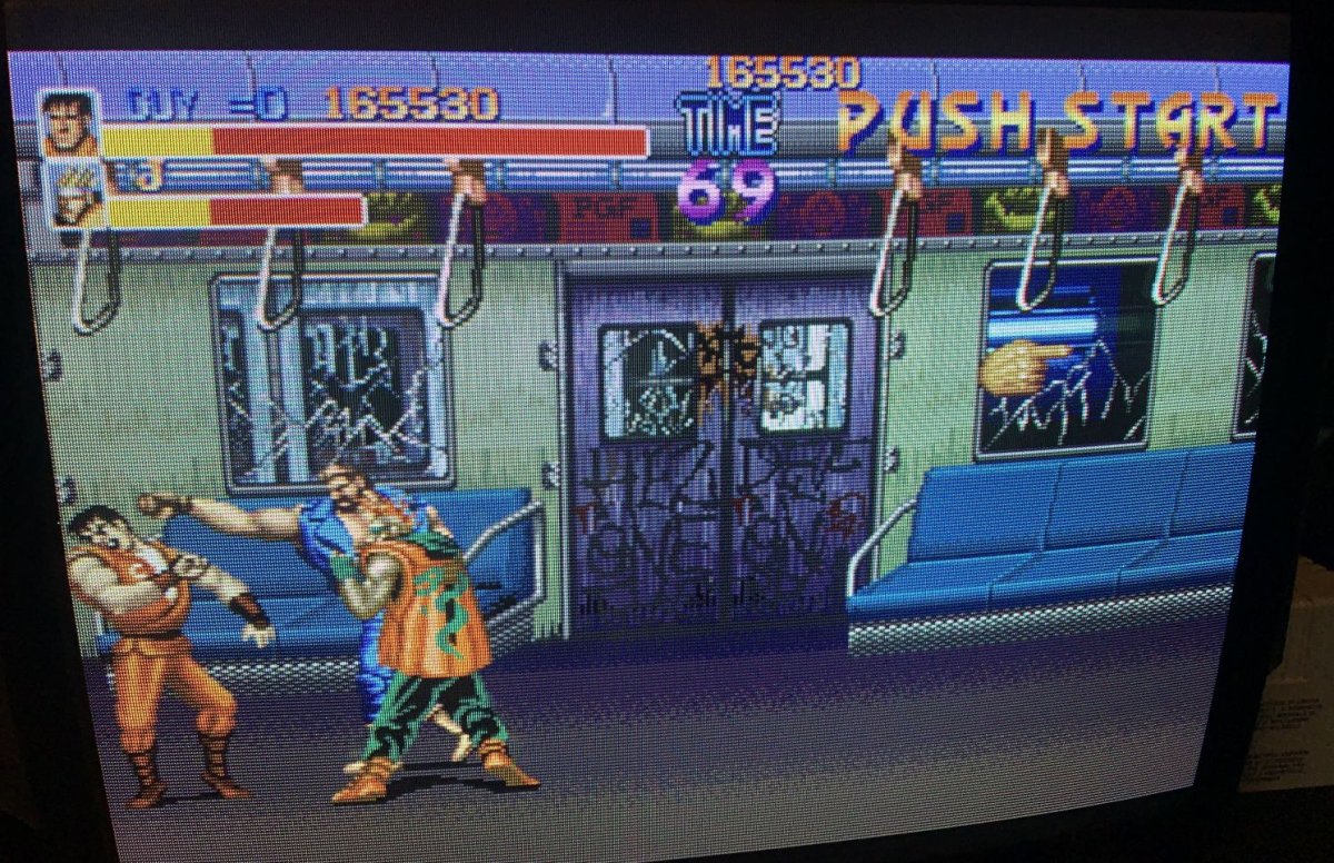

Well, i attached very tight the Darksoft C with B-04 code (from the fork, not openkey) and the logic probe prepared conected to the jamma to begin do some measure tests and...for mine surprise once i boot the thing i saw Final Fight working ok on screen...=O
Then, the only thing different i do is put the Darksoft C in B board very very tight...
Maybe there is no problems in mine Final fight B board, false contacts or something wrong, and the only problem was mine original C board with B-04 because a bad custom chip?
  • Like
Reactions: ack
sounds like it
