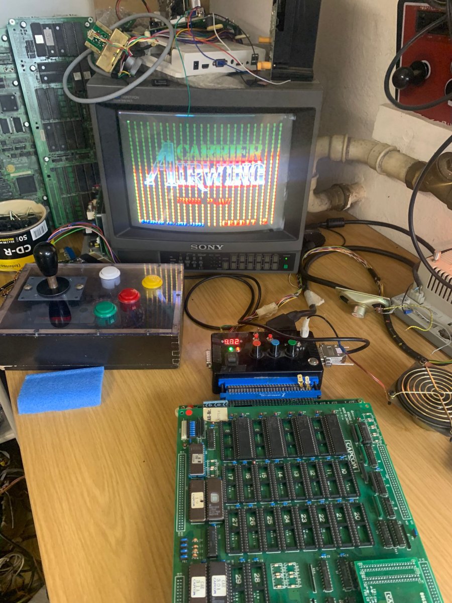

hello have a cps 1 with a graphic error is the problem a custom chip?

Yes it is very likely one of the customs. Isolate it to the A board or the B+C set. If you have another working c board with same custom (can be a world warrior C board, with kick connector and ic. on top), then you can further isolate it to the C board if the issue is coming from.the b+c set. Check the C board for nicked traces or gouges.CPS 1 graphics error custom chip?

Start with probing cps-a-01. If you've got lines not doing anything that should be functional, or obviously misbehaving lines, then start with replacement of cps-a-01. Probing pal's can also give insight into a faulty cps-a-01. Again, lines with no signal that should have signal or lines that are making very abnormal sounds not consistent with normal activity.Hey, i highjack this one;
Tested 5x CPS 1 A boards with issues
3x have similar problems than the one pictured here
1x has the text only around 70% to high
1x has flickering sprites
Aside from this all run fine with full sound.
My B+C used for testing are 100% fine.
Where to start and what parts to switch? ^__^
