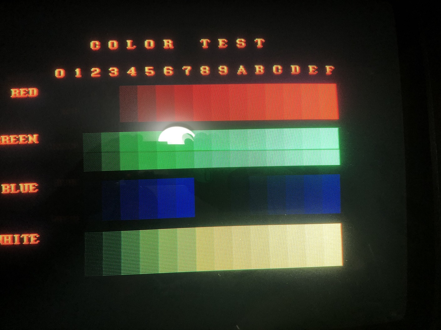

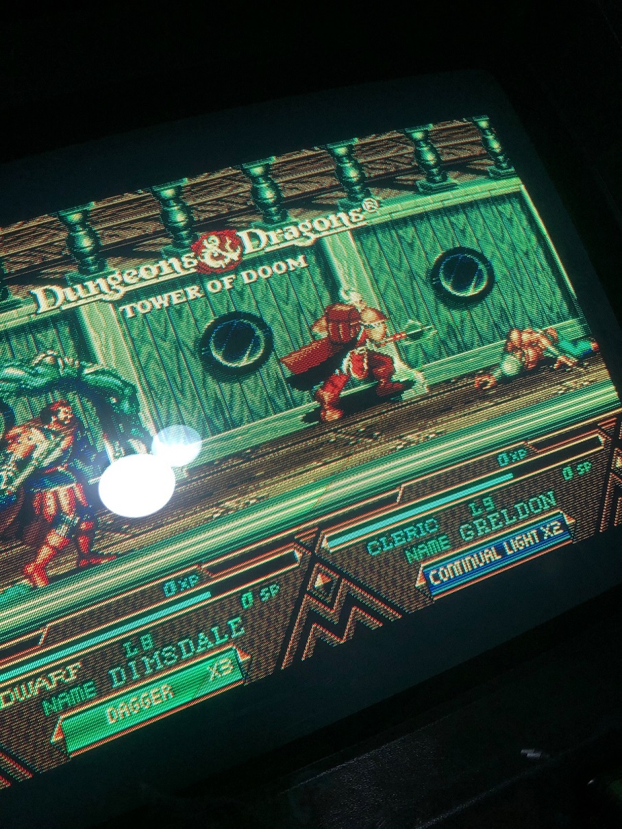

My buddy has a Tower of Doom board but white doesn't show up in the color test. Is there chip or something he can swap out?
Not sure how that's possible? Is the color test showing red, green and blue? White is just a combination of these three.
Color bar and other image is from D&D

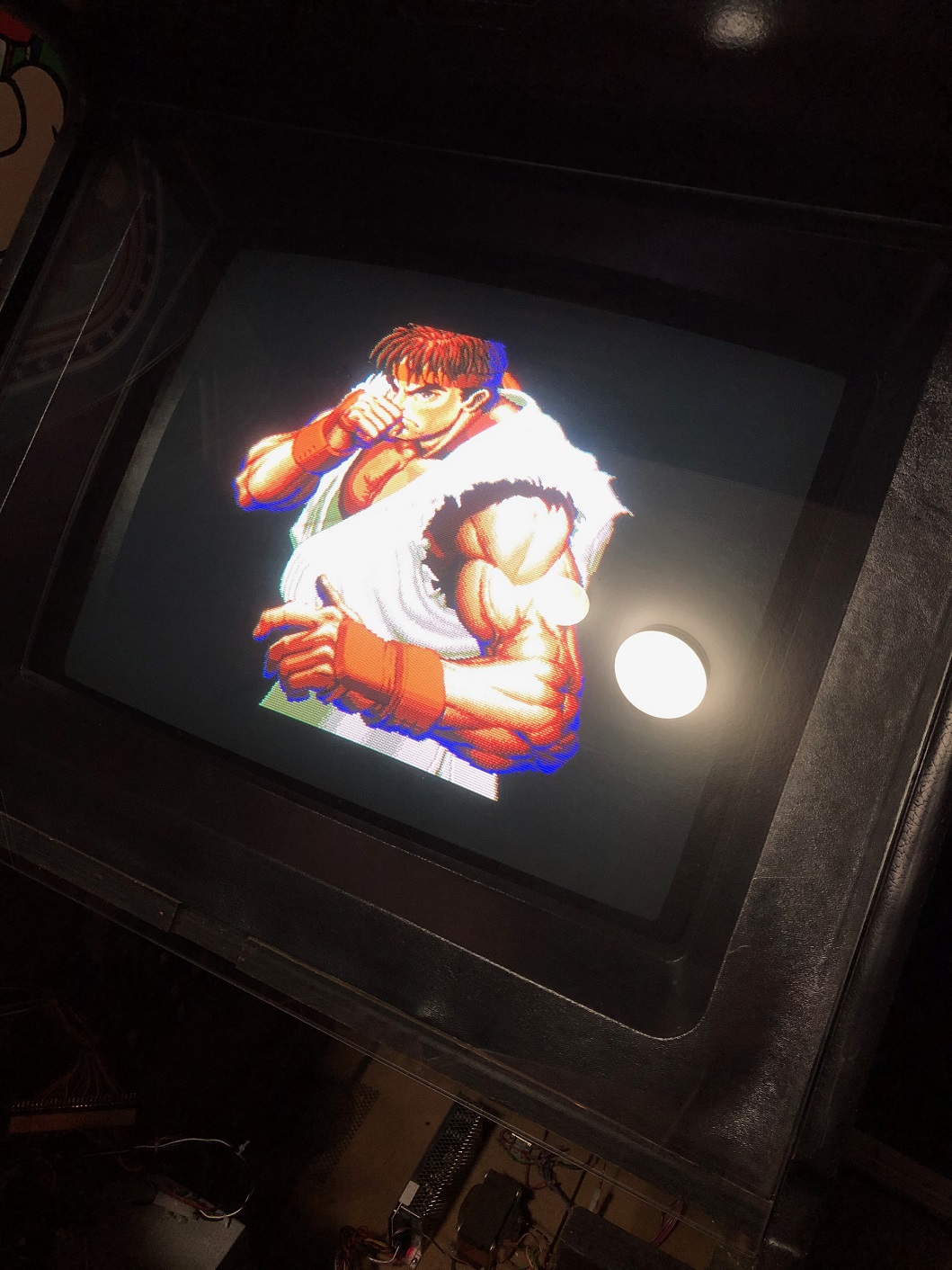

Ryu is from SF which color comes out correctly. So not sure what is wrong with the board

Your blue output is the problem. Looks like your missing half of the gradients. Naturally this will affect white as well, because R+G+B=W.
I don't think your SF is working correctly either. You should notice it on any light blue that is either too dark or too bright.
