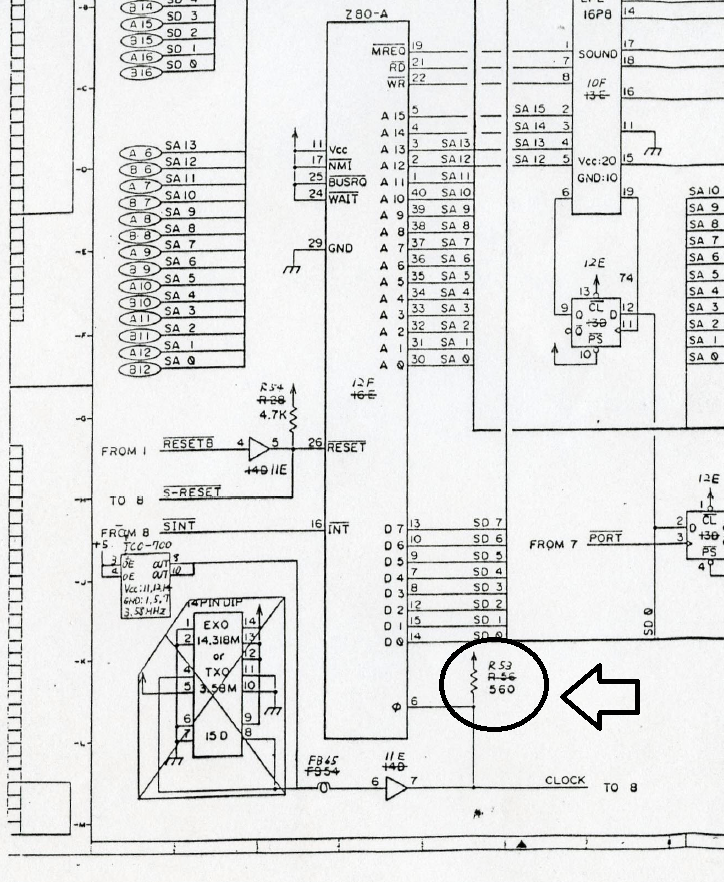

I finally tracked the problem down to a resistor on the line between audio oscillator (3.579mhz) and z80 pin 6 (z80 clk) - R53. I believe that's a pull-up resistor? That resistor is supposed to be 560 ohm, but when pulling and measuring it, it measured at 860 ohm. I then pulled the same resistor off a parts CPS Dash board, and it too measured at 860 ohm. :/ Checking the labeling on both resistors (561), it is indeed supposed to be 560 ohm. So I pulled yet another R53 off of a working board, and it measured at 660 ohm. Well, if these things are 20% tolerance then that is probably within spec. I swapped it onto the original problem board, and it is now working with no disruption to audio.

Theoretically, it seems this location has pretty high tolerance, and presumably at 860 ohm, the circuit was still functioning normally, but once heat was introduced through operation, it would reach some threshold of increased resistance that would result in failure of the z80 clocking.

Just like to say Thank you for this post. I had a similar problem where I would lose audio and if I let it rest it would come back. In my case the R53 was good but I did trace it back to the crystal
