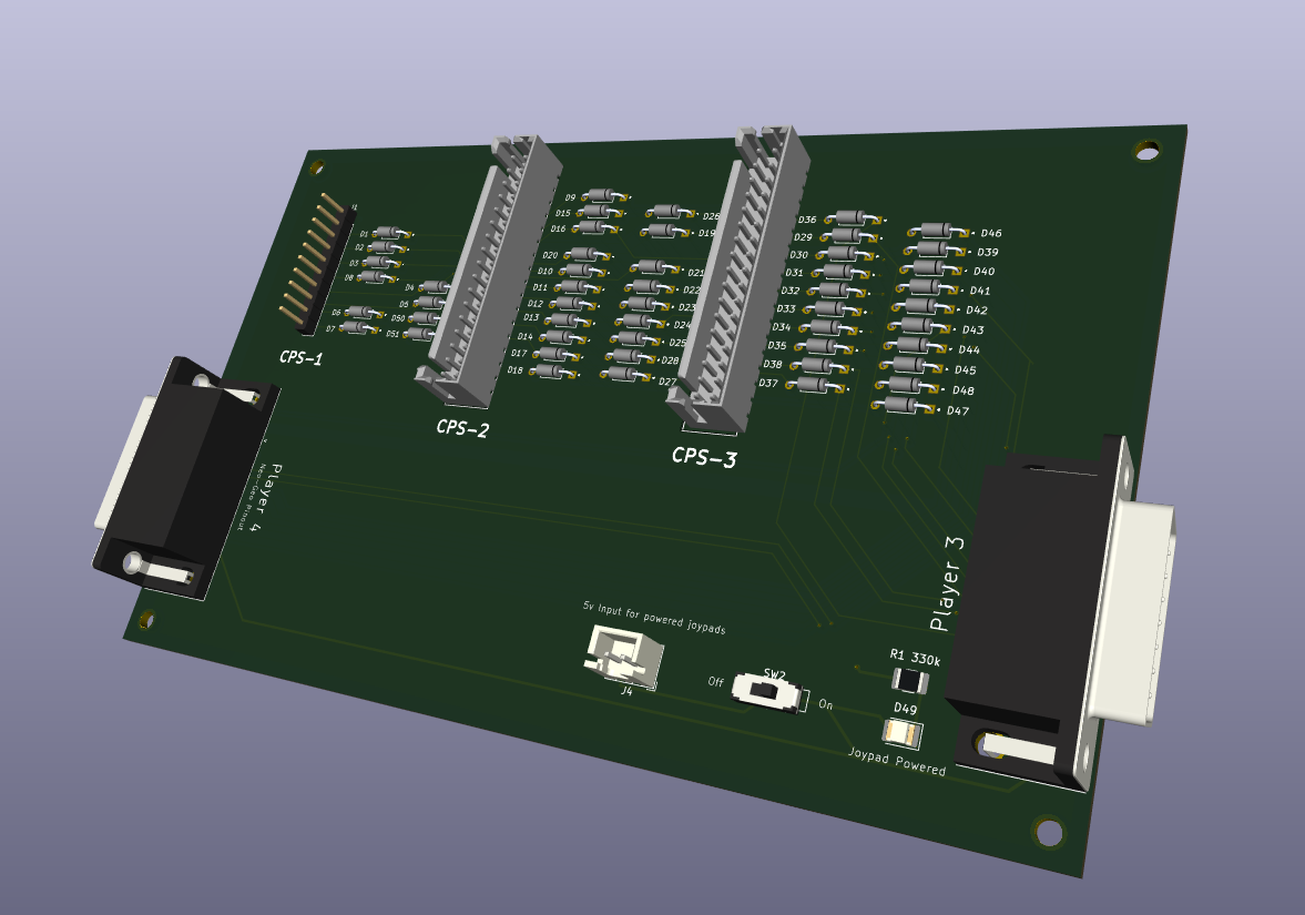

Just checking if this interests anyone else as it may make a slight difference how I design it.
I have my cps1 and 2 multi in the same cab and decided to build a kick harness condenser. While I was at it I decided to add p3 and p4 controls out(in) via 2 db15 ports so you can play final fight and d&d with 3 players in a 2 player cab.
I have just realised that some (not all) neo geo controllers need 5v at the pin while others don't. This necessitates a slight redesign. At this point I thought I would ask of this interests anyone else because if it does I may go to through hole diodes over smd so it can be built easily.
Currently it takes 3 kick harnesses from different boards in(out) and accepts input from either the cabs CP, or DB15 controllers plugged into the on board ports. It also has volume control, a dip switch bank for turning off p1 and p2 b4,5 & 6 as their inputs can cause havoc to p3. If any interested party thinks the addition of some other feature is essential let me know this also.
Interested to see if this is useful to anyone else apart from myself.

Volume I am not handling different board types just bringing the buttons from the cps2 kick harness to the pcb and including some small buttons.
Remapping is interesting and I considered it. However it's almost a separate board because if you included it at this point you could only remap the kick harness. I sort of see a button remapping autofire board as the next step along and I think the more modular you keep things the more broad utility they can have. The code is all almost complete in @Arthrimus db15 converters it would only need a minor tweek and a few Atmega's.
It will currently accept any kick harness. It's just they may need to be wired with a molex/nh connector.
So I believe that what these replies are telling me is that there are more situations where kick harness condensing and 3 and 4 player out is desirable but this only has utility outside of cps setups if there is an easy way to remap the buttons aswell. I'll look into this a little but I still really think button remapping/autofire is a different module.

This is one I keep coming back to. Currently it condenses CPS1,2 and 3 kick harnesses and allows you to plug in a controller to play 3 and 4 player games. The power is only for some Neo-Geo controllers that need 5v. I thought about using the 12v on the CPS2 kick and a basic buck converter to get this but for now it takes in a 2pin xh connector with GND on pin 1 and 5v on pin 2. I was also playing around with the idea of condensing/muxing the CPS 1 and 2 multi selector but couldn't find a nice solution for switching between the multis. The second reason this has not happened yet is that routing traces was a pain and with the multiplexers on the board for switching the selector, it was turning to spaghetti. The trace routing is currently far from optimal but it appears to work. Ill keep playing around with this because I want it in my cab and when I am happy I will make a few up and release the gerbers.
