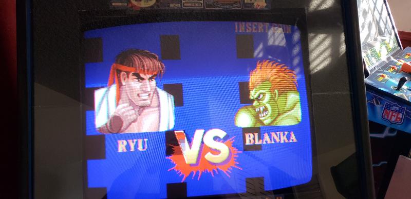

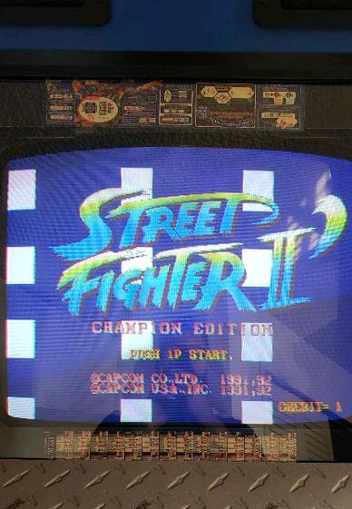

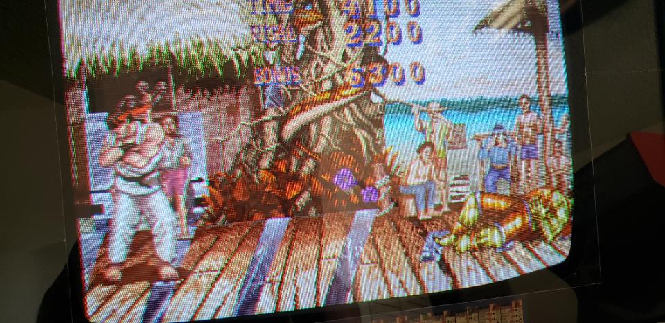

Any expert out that that can take a look at these pics and confirm if this particular graphic glitch is a bad custom chip (aka not repairable)?
The game plays and sounds fine.
Thanks for your help!

If the game boots and passes all RAM tests then PSRAMs are good. Then since sprites are drawn correctly we can assume DRAMs are good too. So yes, probably a faulty custom chip.
